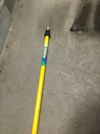

Got the end fitting machined for my camp light pole. Basically I drilled the rivets out on the acme threaded end fitting that came on the pole and removed it. Then I took a 2" long chunk of 1.5" dia aluminum round stock and turned it down to a press fit in the stainless tubing the pole is made out of. Then center drilled it and tapped it for 3/8"-16 so I can mount a pod light on it. Then when camp is set up I'll have a light positioned 11-12' in the air for area lighting.
