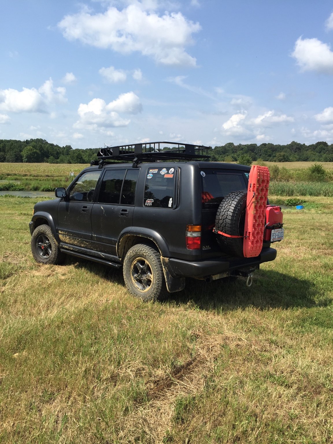

So here is my rig as it sits at the moment:
1999 Isuzu Trooper
Current Modifications:
-2.5" lift
-Rocky Road Outfitters Superslider Rock Sliders
-Rear LSD
-manual locking hubs
-Falken Wildpeak A/T 265/75/R16 w/ full sized spare
-Roof mounted LED bar
-LED lights in the hatch
-Rhino lined paint
-Roof crossbars
-Isuzu canvas tire cover
-DIY RTT setup
-Upgraded stereo head unit and front door speakers
-Pro Comp ES3000 shocks
-Smittybilt Jerry Can Holder
-Smittybilt Spare Tire Mounted Awning
- Arksen Roof Rack
-an ass load of stickers from everywhere the Isuzu takes me

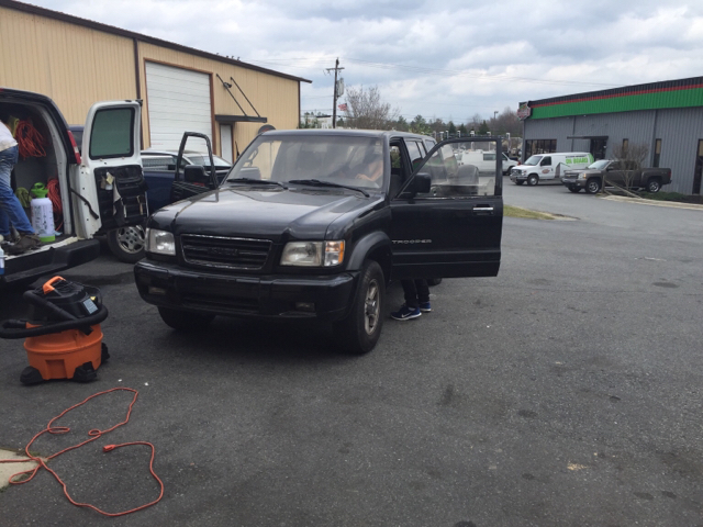

Backstory:
I used to mildly wheel in my 1999 Jeep WJ a couple years back but it died and I bought an 2009 Mini Cooper S. I still have the Mini and have done extensive modifications to it but I'm a truck guy at heart.
I bought the Trooper for $1,800.00. It was rough but mechanically sound and everything worked. 170,000 miles.

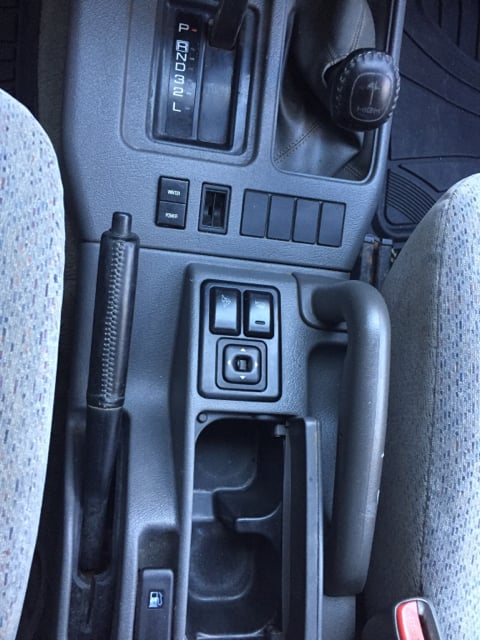

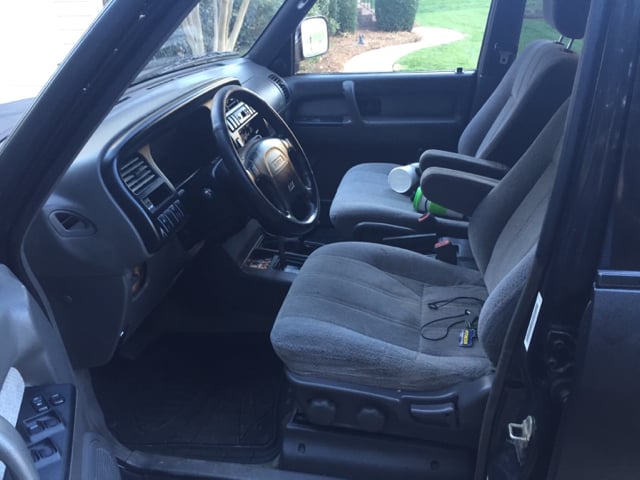

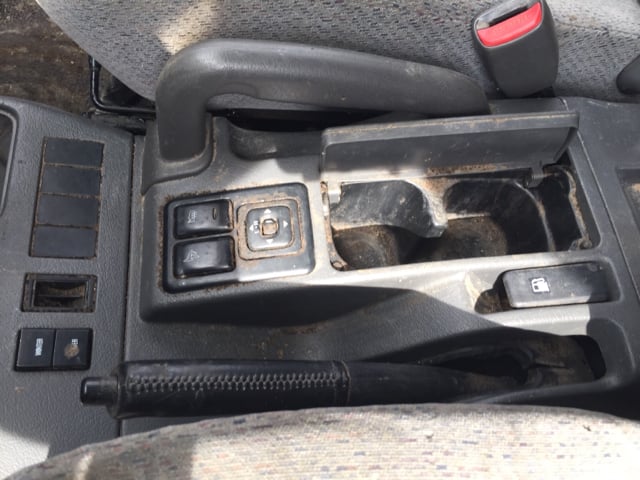

I promptly got it professionally detailed to try to save the interior. Everything but the carpet cleaned up nice.
Here's some before and after.
The interior on this car now is very clean and everything works. The exterior just wasn't salvageable at a reasonable expense.

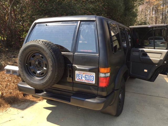

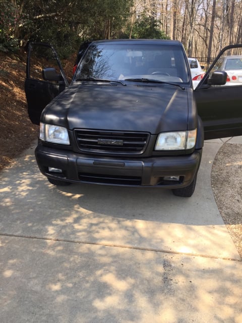

The purpose of this build is my daily driver that can get me, my wife, and Rhodesian Ridgeback pup out into the wild. I have a deep love for camping and all things automotive so overlanding is my crack. We are young and just starting off so this is a very budget minded build. I'm relying on my creativity (and YOURS because I'll "borrow" a good DIY idea in a heartbeat.) I will NEVER SKIMP on the important stuff like first-aid, fire extinguisher, tires, etc.

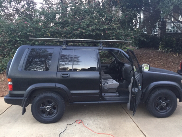

I cleaned it up on the inside and painted the wheels. The paint was in such bad condition that bed-lined it with rattle cans. $50 paint job!!
I apologize that the photos are not ideal. I did not consider that I would start a build thread when I took them. They will get better!

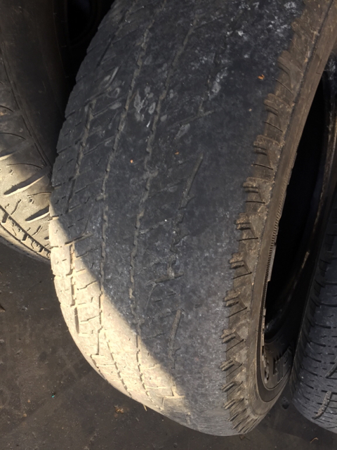

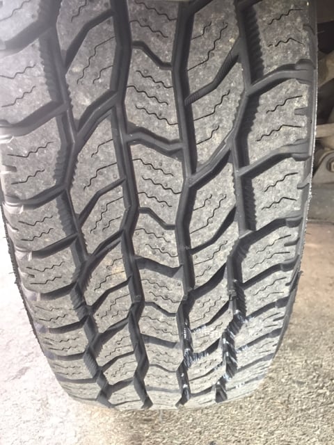

The tires I bought the Trooper with were bald. My buddy who owns a shop gets me great deals on stuff and is a huge resource for mechanical knowledge. I got these Coopers for $103.00 each and mounted and balanced them myself in the shop to save on labor!

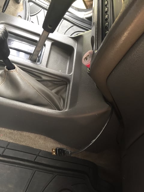

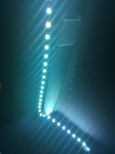

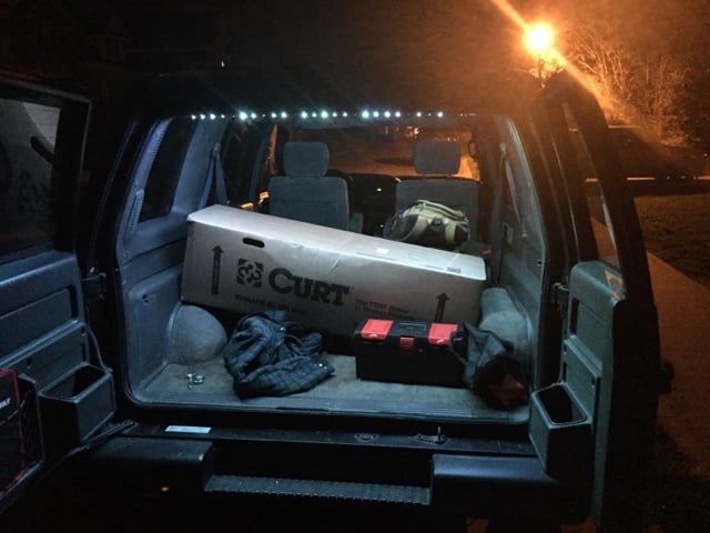

The old interior lighting was not cutting it so I bought an LED strip that plugs into my cigarette outlet for $5 off eBay. They are meant to be mounted behind a TV and are not waterproof so I mounted them it what should remain a dry location. *fingers crossed*
Should make operating out of the back of the rig at night 100x easier.

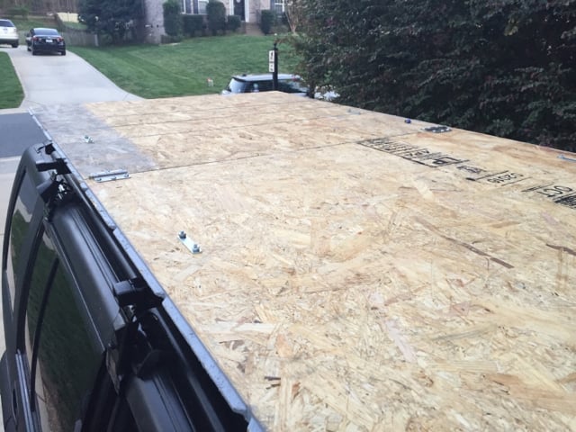

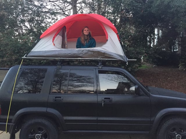

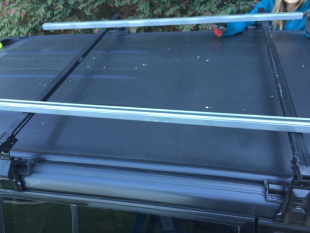

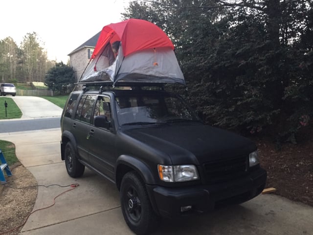

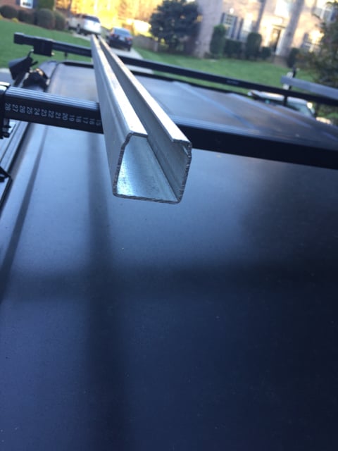

DIY Roof-Top Tent Build:
Here's my build for my RTT. It's certainly not pretty but it should work. Keep in mind it's just a prototype and it'll get better with time.
Price Breakdown:
Tent- FREE (wedding gift)
C-Track supports- FREE (I can get scrap metal from work)
Hardware- U-bolts, door hinge, wooden sub flooring $54 (but I had a $50 Home Depot card from my wedding)
The c-track goes across the roof rack..

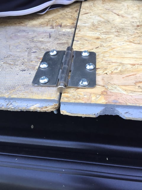

Then the board that is in 2 pieces is positioned on top of the c-track. Once it's in place I put the door hinge bolts in and that connects the 2 pieces of sub-flooring together. It's in 2 because the wood is so freaking heavy in one solid piece and it stores easily into the Trooper for travel.
Next the U-Bolts run up through the board. It sandwiches the c-track in between the roof rack and the board. I had my 100 lb. wife try it out before my 200 lb. self did.
Then the tent goes on top. Easy enough! Still working on a way to securely strap it down.
Thanks for reading!!

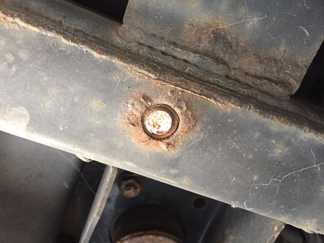

I went to mount my Curt brand trailer hitch this morning before the winter weather made its way down here to NC but that didn't happen. As I went to bolt it in I learned that the previous owner must have had a trailer hitch and broke the bolt off in the hole, thus putting the hitch on hold.
I am not sure how to get it out and I'd really like to have the hitch installed because they are so useful but I'm at a loss on how to do it. ADVISE NEEDED!

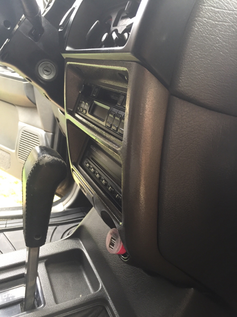

So I moved on the cleaning out the rig some more and repairing some things.

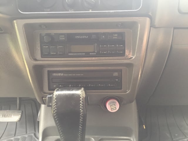

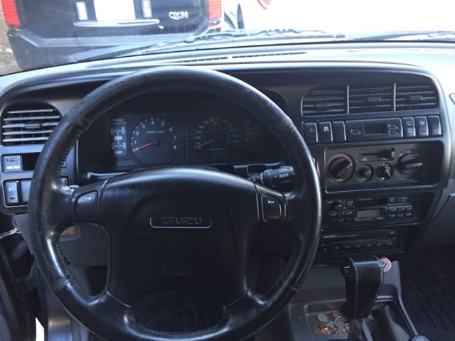

The CD player made an awful racket when I started the Trooper and since I don't even own a CD I pulled it out, unplugged it, and reinstalled it. I'll eventually remove it permanently and put a CB or something like that in there but for now I'll leave it. The same goes for the tape player. I'm a Millennial, I barely know what that is!
I got impulsive and painted the trim piece around the radio. I immediately regretted my decision when I began to paint but after I installed everything back together it has started growing on me.
What do you think? Thoughts?

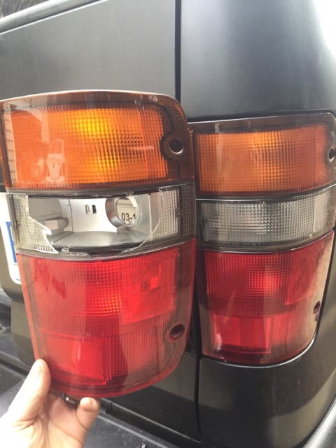

I also swapped out the broken taillight. $10 from the scrap yard!

Do you have a drill? Easy outs are fairly inexpensive. Can you get to the top side of that bolt? If so are there threads sticking out? No matter what you try soak ok with wd40 a couple times.
I can't get to the top side of the bolt.
I have a drill I'll look into a easy out at Lowes.

If there is enough space on the hitch mount to drill another hole you could do that as well and would be way easier than the bolt extraction.
