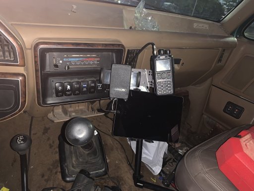

Finally some progress on the interior. I had ordered Lido Mounts for my iPad, iPhone, HT, and my mobile radios. Yesterday I got them all installed. Today I’m going to work on installing the mobile radios and clean out the back of the beast.

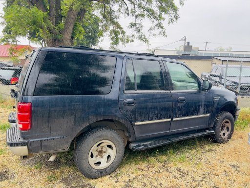

Long time no update.
the idle issue persists still, without a confirmed solution in sight, so the “Adventure Machine” is on hold; possibly permanently.
In other news; this fallowed me home today.
I’m going to let the suspense build as I figure out the direction she goes over the next few weeks. A lot of parts from the Adventure Machine are going to swap over. Be looking for a new build page soon.
