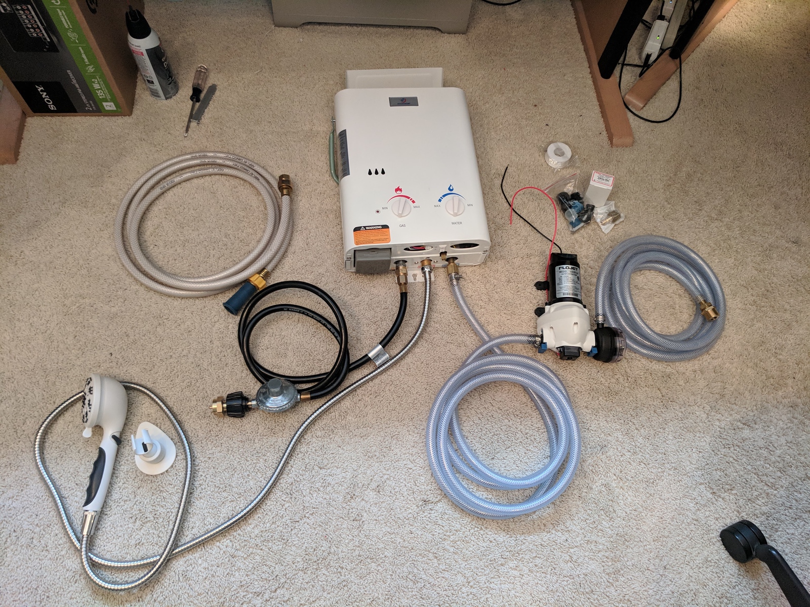

If you are going that route, I suggest you check out the Eccotemp L5. I looked at the zodi and even the dual burner zodi. The setup basically involves heating up the bucket of water first, then using it. The zodi doesn't turn on and off with the flow like an eccotemp and it has very weak flow and preassure, so you need something different to actually wash yourself very well.
Get a good 12v pump, 50 psi with a couple gpm flow (you can reduce the flow rate from there).
The setup I am working on now uses one. I will make a thread with details once I have the kinks worked out.

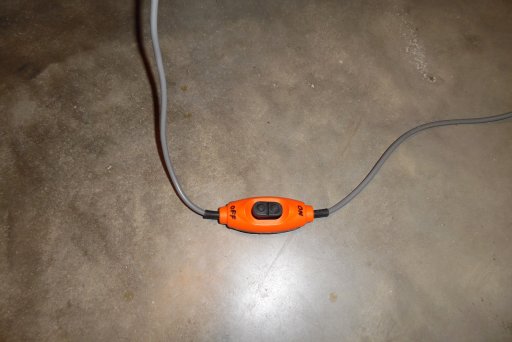

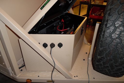

I like & use the Zodi Hot Shower System that I done some macgyvering on. Got rid of the original 6v. pump (4 D battery) set up & went with a 12v. pump so it can plug into my tongue box 12v. outlets. The electrical cord for the 12v.pump that plugs into the tongue box outlets is 15ft long now. I added longer water line to shower head that is 12 ft. in stead of the standard 7ft hose. I also added a new 1 lb propane bottle base instead of using the lid as the base like it was designed.
I like the fact of the Zodi being portable & compact w\o all the unwanted or bulky attachments that other shower systems offer which only takes up more space when stored.
Even with my modifications I made, I can still fit everything into its original container which acts as your water vessel for the shower system. Set it time is quick, the water heats up fast & you shut off the heat when you reach the desired water temperature you like. With these modifications I made keeps all my gear strictly 12v. & or propane or both. Just plug it in the tongue box & stretch out the cord.

Yes, I think the single zodi is a bit smaller, and comes with a bucket which is nice. I plan to pull water out of a jerry anyway. The nice thing about this is I can turn on the sprayer and the pump kicks on, the water heater kicks on, and its all automatic. When I shut off flow, the water pump stops and the heater stops. So you get hot water, on demand, only heat what you need and can shut the water off as much as you want.
I'll do a full writeup of my setup later.
