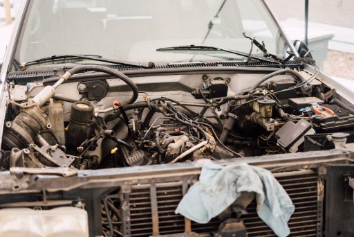

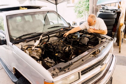

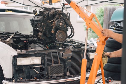

I picked up this 1996 Chevy Tahoe on Craigslist for $500 needing a motor and transmission. My dad and I did the motor swap for a used motor that we found for $150 and we paid a friend to put a transmission in for us. All in I am only at $1250 so far. I have a LONG ways to go, but at least I finally have a 4x4 to get out and explore a little but again.

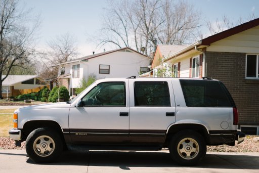

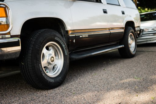

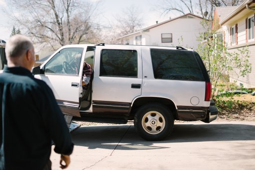

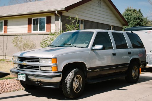

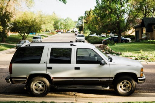

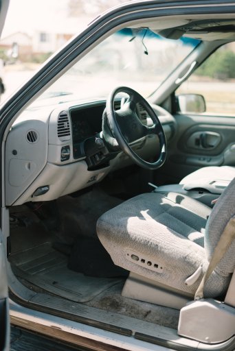

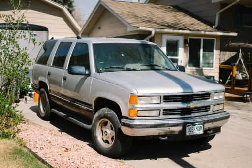

Here is some pictures from the day I got it. It wasn't it terrible shape really. Needed a lot of cleaning up but a pretty solid truck for $500. I particularly like the wheels a lot. I need one cap, but I dig that old school aluminum wheel look. 20170322-DSC03558.jpg 20170322-DSC03560.jpg 20170322-DSC03563.jpg 20170322-DSC03564.jpg 20170322-DSC03567.jpg 20170322-DSC03568.jpg

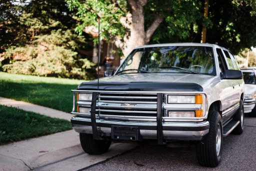

I found this push bar for the front for $40 at a garage sale. I was originally planning on going black on the front end, but for $40 I can make chrome work. Gives me some front end protection as well as mounting points for my antennas and lights. 20170603-DSC05322.jpg
I have also been working pretty hard at getting my wheels polished. They are starting to look alright. 20170603-DSC05324.jpg

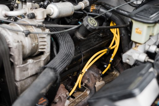

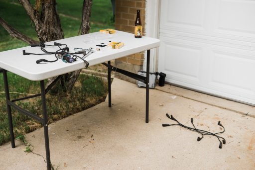

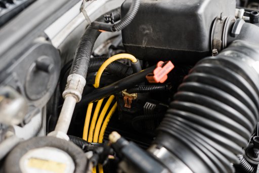

For the last couple weeks the motor just hadn't been running quite right. There was some hesitation on acceleration, rough idle, and lack of power. It felt like a fuel delivery issue to me, but I decided to try the easy stuff first.
I cleaned the mass airflow sensor and tested it and the throttle position sensor. No change.
I ran some BG44k through it and some Seafoam on the next tank. There was some improvement but more of the same.
I then decided to go ahead and do the spark plugs and wires, mainly because they are probably original to the motor. Lo and behold...it now runs perfectly smooth and with noticeably more power. Sometimes just basic motor maintenance is all it needs.
I went with NGK spark plugs and JEGS wires. They seemed to get good reviews and were priced reasonable. I am very happy so far. Feels like a new truck. 20170617-DSC05774.jpg20170617-DSC05776.jpg20170617-DSC05777.jpg
