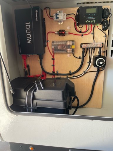

Awesome LanceK. I took your inspiration and did some a solar installation and wiring similar to you. Thanks for your post! Worked out awesome. Drilled a couple holes, added grommets, and ran the wires up to the storage compartment. Solar controller, inverter, bus bars, and cut off switches so I can run off my Jeeps alternator when driving through 7pin, then when at camp site, disconnect 7pin and run through the switches an using the 100ah battery. Redid the wiring underneath so I can use the SAE solar port to charge direct to controller. I loose a bit of space in compartment, but I am planning to 3D print sectioning to create space in front of panel and above battery.
