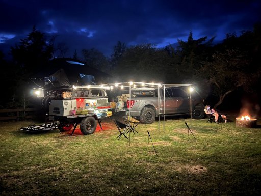

Wife and I and little Mia Beagle took my first trip to Houston Texas August 1st. We picked up our new rig, a 2022 Woolly Bear at Taxa. The boys at Taxa treated us to a factory tour and provided us with everything needed to get our new Woolly Bear on the road to back home. WE have spent the last few months making the Woolly Bear.20220801_122801 (2).jpg

Wife and I and little Mia Beagle took my first trip to Houston Texas August 1st. We picked up our new rig, a 2022 Woolly Bear at Taxa. The boys at Taxa treated us to a factory tour and provided us with everything needed to get our new Woolly Bear on the road to back home. WE have spent the last few months making the Woolly Bear.View attachment 251386
Congrats! Post up some pics on what you've done so far. I was just hanging out with the Taxa folks today at the Houston Off-Road Expo, great group of people!

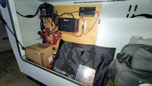

I added a larger battery box for the 100-amp Lossigy Lithium Iron Phosphate Battery. Added 11 lb. propane tank to the front wall. Added AC shore connection on the driver's side. And a wire access hole through front wall was added to run additional cables for the Renogy DC-DC charger with MPPT.20230316_115203.jpg
