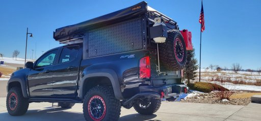

My wife purchased me a 2020 ZR2 Bison in February 2020 for my Birthday. When she gave it to me on my birthday she asked – “Well. . . what are you going to do to this one?” I told her – “Nothing, its got all I need. I love it just the way it is from the factory.” ----- well ---- here we go with my build---
Truck Name: Tatanka
2020 ZR2 Bison
V-6 Gas / Automatic
Additional options from factory:
Premium Bose Audio System
Infotainment 3 Plus with Navigation
Dealer Installed Power Package (Performance Air Intake & CAT-Back Exhaust)
GMPP Front Level Kit and High Angle A-Arms
GMPP Tie-Rod Protective Sleeves
Akicita
1,045
Firestone, CO, USA
Akicita
Lakota
42876
I Think We Need a Winch
On our first backcountry ski trip with our Bison, we got stuck when I slid into a drainage break on a jeep trail near the Never Summer Range in Central Colorado. Entirely driver error on my part as I have been on this trail dozens of times in lesser vehicles. We dug, jacked, rocked, fiddled, and farted for an hour or so until we finally got out. As we piled ourselves into the truck, sweaty and tired, my wife looked at me and said matter of factly . . . “Honey, I think we need a winch”. . .
Little did she know that those six words would be the beginning of the transformation of my 20 ZR2 Bison to – Tatanka! I put the winch and my build off for a few months as the pandemic started gripping the nation. When things settled down a bit, I found myself consistently working on Tatanka as a distraction from the challenges we all faced that year.
First DIY mods:
AEV Lower Lower Bumper Section
AEV ZR2 Bison Winch Mount
Com-Up 9.5 Slimline Winch & Synthetic Cable
Factor 55 Flat Link
Rough Country 30” Single Row Curved Light Bar
Maxtrax Traction Boards (4)
GP Factor Maxtrax Mount
X-Monster Kinetic Rope
Soft Shackles (3)
Factor 55 Shackle Pulley
Recovery Straps
Boulder Tools Tire Repair Kit
Boulder Tools Air Deflators
GOOLOO 4000A Car Jump Starter
RotoPax 3 Gal Fuel Cans (2) Blemished
RotoPax 3 Gal Locking Mount (2)
Viair HD Onboard Air Compressor and 2.5 Gallon Tank
While I had the grill out I painted the Chevrolet letters red, de-badged all the chrome and re-badged with black and red badges. I also added some red accent pinstripe to the hood.
Akicita
1,045
Firestone, CO, USA
Akicita
Lakota
42876
Hey, Check This Out
While researching winches and other recovery items, I needed for our backcountry outings; I came across an article with a picture of a Toyota Tacoma with an Alu Cab Canopy Camper on it. . . Naturally, the first thing I thought of was - I need this on my truck - “Hey, check this out,” – I shouted to my wife.
The article highlighted a Tacoma build in South Africa for a surfer with an Alu Cab Canopy camper. Not a surfer, but I was intrigued. I told my wife this would make a great basecamp sleeper for our mountain expeditions. I would love to say she immediately agreed, but she didn’t. So after much deliberation and a visit to see one in person, she agreed, and I put an order in on one from a local dealer.
Options:
Shadow Awning
Molle Mounts on Rear
Spare Tire Carrier
Aluminum Folding Table and Carrier

Wow, That Goose Gear Stuff Is Expensive
My wife and I have led a pretty minimalist backcountry lifestyle for most of our lives. Growing up in the mountains of Colorado, we have learned the older we get, the lighter we must travel and the less gear we can physically carry. When the camper finally arrived after a long wait from Africa and after careful inspection, the first thing she asked was – "Where are we going to put everything?" – "Hmmm," I said. "Well, we could just throw our packs back here, and we can toss in a couple of water jugs over there." - "Hmmm," she replied. "Well, if we have all this room now, can't we bring a few more things since the truck is carrying the load and not us? Maybe a cooler with some cold beers and real pillows instead of those inflatable ones?" - "Sure!" I exclaimed. "Well, I could get some of those Goose Gear cabinets and maybe add a solar-charged battery to run one of those cool portable refrigerators like Jimmy has in his boat -and-and-and-and, how about I insulate it and add some kind of heater? We haven't camped with a heater since the kids were babies in your parent's pop-up tent camper!" - "Yeah, you should do that!" – she replied. . . "what are you standing around for? Get on that!" – she yelled. . .
I started researching the Goose Gear rear seat delete for the Colorado and Goose Gear camper boxes designed for the Canopy Camper. I will be the first to say that Goose Gear makes excellent stuff, but I couldn't hide what it would cost to order it from my wife. "Wow, that Goose Gear stuff is expensive!" – she said when I showed her the prices. "Hell, you could make that in your shop, couldn't you?" – she asked. "I’m sure I could. . . but when am I going to find the time?” – I replied. “Well, I guess I could pick up a few of your chores and cover for you at the office for a few days.” – she said. “Well. . . if you can do that, I think I could get it done in a week or two. . . No. . . that would be asking too much of you. Why don’t I just order it from Goose Gear?” – I asked. “No way! You order the materials you need and get them done. I’ll do your chores and cover for you at the office until you're done.”- she insisted. “Well. . . okay. . . if you insist.” (chuckle- chuckle)
Yahoo!!! No chores and hanging out in my shop building stuff. . . the seat delete, cabinets, solar wiring, and interior insulation and other comfort items. I added a propane tank and Mr. Heater Buddy heater to it. I also picked up a refurbished Goal Zero Yeti 1000 Watt battery generator from Goal Zero and wired in all the camper lights and other accessories that I recently upgraded to a Yeti 1500X20200217_091445(1).jpgDSC_0222.jpgIMG_7172.JPG20200524_173216.jpg20200525_115359.jpg20200527_203758.jpg20200603_175731.jpg20200607_073552.jpg20200809_134813.jpg20200809_144424.jpg20200820_202519.jpg20200820_202536.jpg20210102_101707.jpg20210102_101734.jpg20210627_120239.jpg

With most of the camper buildout done, we decided we needed to go out on a “shakedown cruise.” We loaded up necessary gear and water and headed for nearby Forest Service Access. As we started up the road, rough from Spring run-off, it was apparent that the Bison had much lower clearance than our previous Jeep Rubicon. “What was that?”- my wife asked as we drug over the road ruts. “Uhhhh, I think it’s those rear shock mounts that hang so low dragging on the rocks,” – I replied. “That doesn’t sound good. You’re going to have to do something about that. Would a lift help?” – she asked. “It would, but I don’t want to go much higher than it is now, or it might not fit in the garage. It sure is nice having it in the garage out of the Winter weather and Spring hail storms.” – I said. “Well, when we get home, we need to see how much clearance we have so you can figure out a way to get more clearance so we can get up and down the trails we like to travel.”- she demanded. “Okay-okay, I’ll get right on that.
Suspension Mods
Peak Add-A-Leaf
Peak 1” Riser Block
Timbre Active Off-Road Bump Stops
589 Rear Shock Relocate
AEV 33” Fender Trim Kit
AEV Crestone Wheels
BFG KM3 Mud Terrain Tires 285/70/1720200814_065900.jpg20210530_110354.jpg20210719_202810.jpg20210616_104937.jpg20210714_111138.jpg20210720_190622.jpg20210719_211241.jpgResized_20210802_085150.jpegResized_20210802_085112.jpegResized_20210802_085010.jpeg

Philámayaye (Thank You)
The extent of my build has taken place over the last year or so, and I believe I am at a point where I can comfortably say it's complete. My build certainly wouldn't have been possible without my wife's unwavering support and love. For that and the support she has shown me these last 35 years, I say. . . Cántecikiyá Philámayaye (Thank You My Love)
We have enjoyed Tatanka very much over the last couple of years, and we anticipate many more years of exploration and other builds we are dreaming of.
