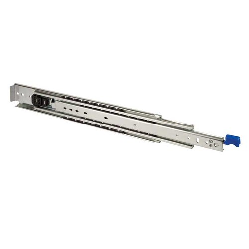

What brand are the slides,been trying to find more information on the sliders.Great looking unit
