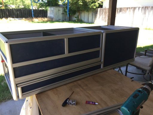

Got more done, though it doesn’t look like much to me. :expressionless:
1) I had to redo a section of the uppper drawer where the sliders attach underneath to make it stronger. That took 1.5 hours to change as I basically had to disassemble the entire sliding drawer.
2) I painted my panels a bright blue, loved it, then hated it, then went navy. Painting takes forever and not my favorite.
3) Sizing the panels and notching the corners to allow for different connectors was LOADS of fun, but it got done.
As I’ve designed this myself I don’t really have a guide on how it gets assembled. Screws go in and I realize screws gotta come out based on the sequence in which the pieces have to go together. I mounted the upper sliders and now I need to devise a way to attach the coffee table lifts to hardpoints. My previous drawer was all 1/2” plywood so you could just screw anywhere to make it work. But this drawer has more of a skeleton so I’ve got to construct hardpoints that match up with where the hinges need to be.
Slow but coming along, regardless it’s fun to me try to figure it all out. Except the painting, I don’t like painting. So much so I’ve repeated myself. I am now my father.
Mambo

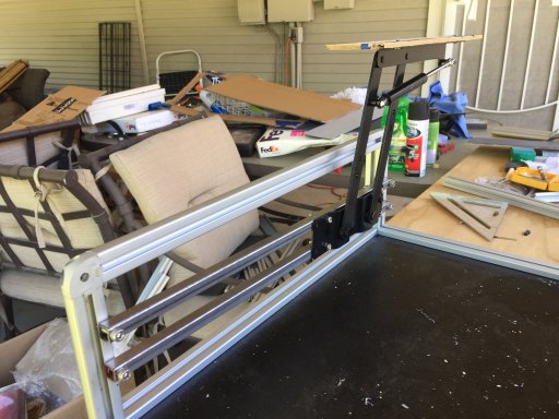

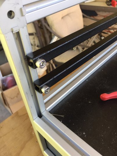

Took FOREVER but I got my supports for the coffee table lifts fabbed. I used 1/2” square tube, tapped the very edge of the extruded aluminum uprights, and used truck bed liner to paint them.

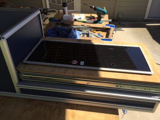

This Dometic Sink/burner combo doesn’t come with a template so I had to make my own, that’s my next step. Clearance underneath is good
The cutting board will pull out sideways and there’s enough clearance right hereBBD9BAC4-EAE1-4915-9D5E-7AF8A8A066C4.jpeg

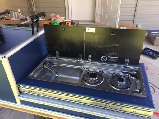

Got the sink/burner top unit installedB65B3358-AAEC-4A6B-BC01-15860ED7CA62.jpegD5B439F3-AD56-41D8-99AE-CCCBBBC0F347.jpeg
My plan is to still use 1 lb propane tanks that I screw into the bottom when the drawer is open and I am cooking.
Simple mount for the regulator underneath

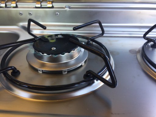

Finally FIRE!!

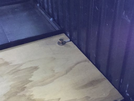

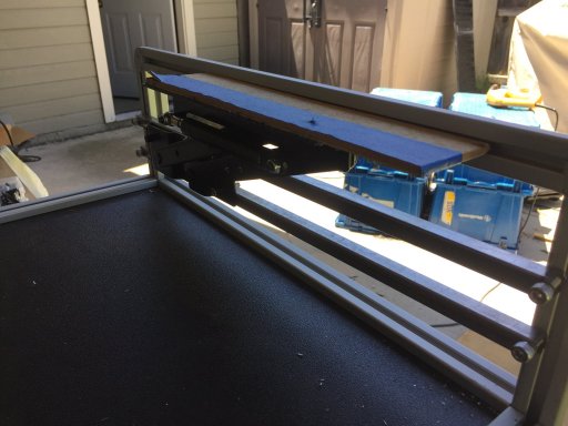

Last night I worked on my bed mount. The drawer will attach to sliders that are screwed onto the plywood. When the drawer fully extends it wants to tip over so I anchored 1/2” bolts in the rear to catch the mount. I will at a steel plate to keep the wood from deforming.
Fridge and gear slide in the left, drawer mount on the right

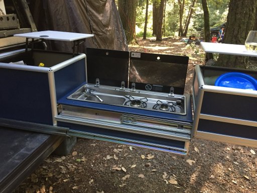

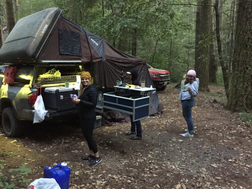

Well I just got back from the Overland bound Lost Coast trip. I was very pleased with how the drawer worked and its functionality in addition to being lighter than my previous version. The drawer is about 90% done as I still need to hook up electrical for the lights and sink actuated water pump
Looks like it worked well for you. How much does it weigh in at?
Boort
I am not exactly sure. I’d say empty maybe 80-100lbs when I lifted it. The sliders are the heaviest part, and there’s 2 sets, one of which is only 30” long though. It is much lighter though than my wood v1 version
