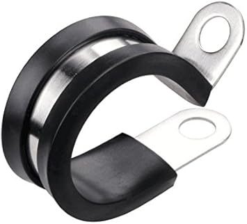

On the no drill seat mount you can add a cable clamp like pictured below screwed to another point part way up to help stabilize it better. Or you can toss the aluminum bendy pole and get creative with some plumbing pipe. You could also try to route the pole where it gets pinched between the seat and the center console to help hold it steadier.
I ordered the seat mount kit with the large vertical tube and separate swing arm. It looks quite rigid. I’m not worried about passenger space, though. I hope it works well.
