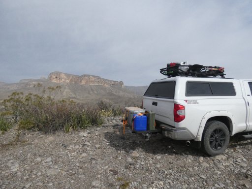

definitely appreciate your input. losing a hitch rack and gas cans on the trail would be bad, but i'm way more worried about it holding up with bumps and dips in the highway...having that come lose and hit a car behind me would be a disaster. i'm going to test it out well before getting on the road with it.

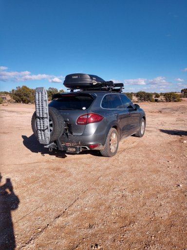

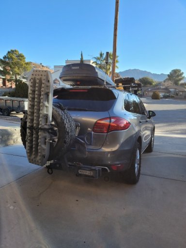

I use a Wilco Solo on my Porsche. I've had it for eight years and am happy with it. The rack is rated for 150lb of weight and you can get highlift and roptopax mounts. Wilco has other models that can carry more weight and accessories.
IMG_20181105_171622339.jpgIMG_20190307_162423745_HDR.jpg20201222_083919 (600x800).jpg

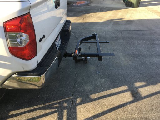

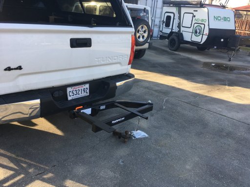

the stowaway brand came today. its built well and will do the job...just not a big fan of how far it sticks out, but like i said earlier...it is a $1000 cheaper than the Rigd, and for a $1000 difference....i will ABSOLUTELY love this one!
besides, if this one ends up pissing me off, both my kids camp and drive pick ups so i'll give it to one of them and then go get something else :grinning:
