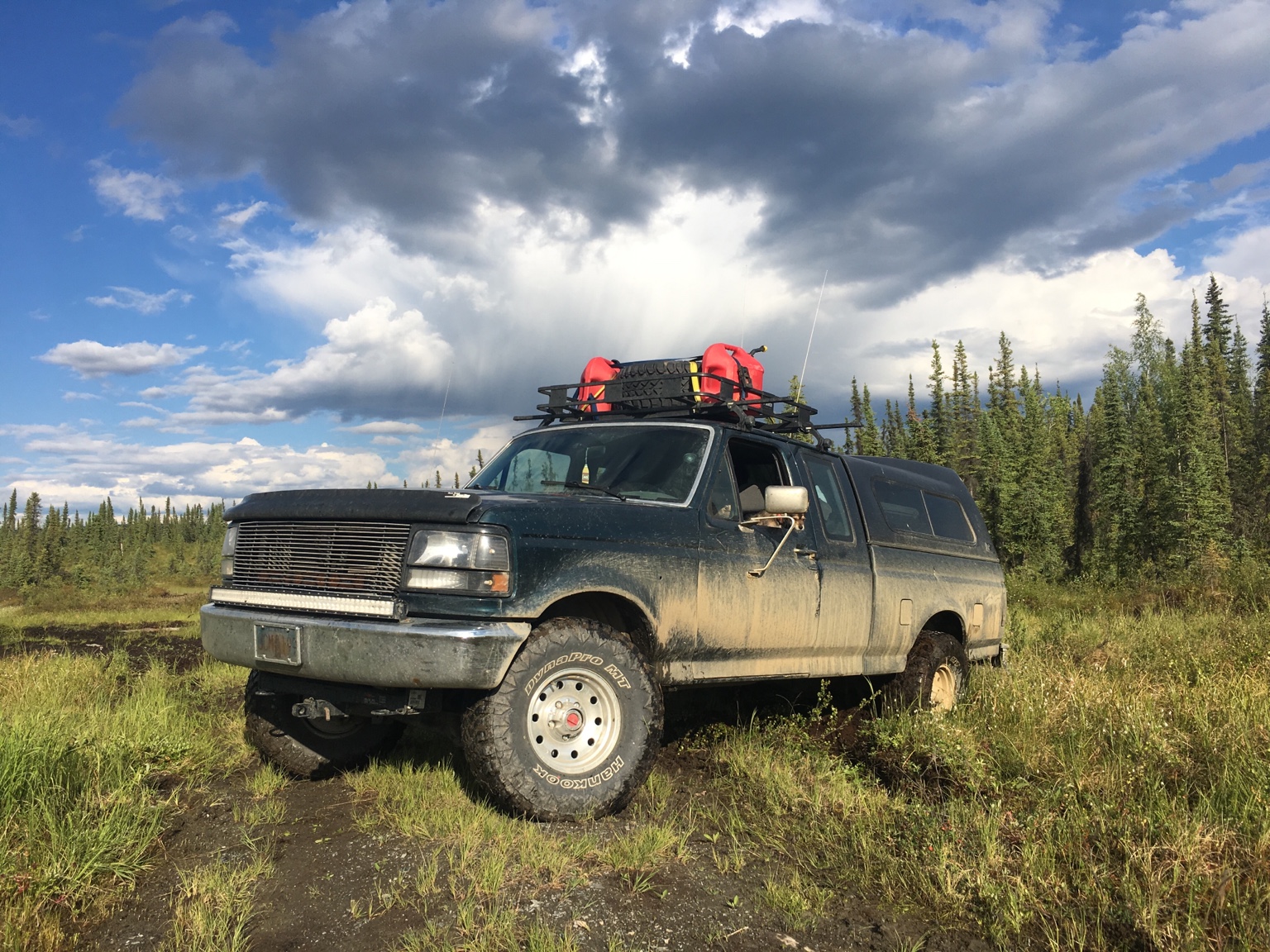

6503
I pulled mine off on my last 1991 pickup DD and was running 31's, didn't notice too much extra body roll. My current 91' still has the front on, but with a heavy topper in the back plus bed boxes I feel like it does its job in keeping body roll down. Installing a rear locker one of these days and will be able to test out the configuration on the trail, feeling like with proper psi and the rear locked I should be just fine on the trails I run.
