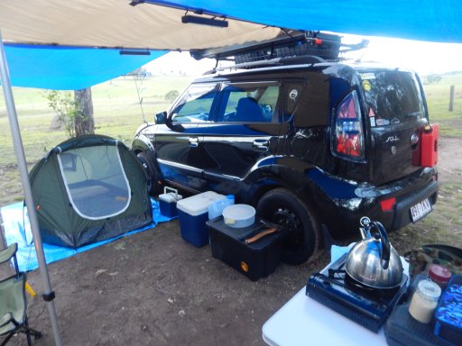

OB1962
3,316
Collingwood Park, Queensland,4301
Luis
Merlo
1962
Until recently the conventional canvas swag was quite shallow, now "dome" swags are much more popular and have much more height to them, when I was in the market for one, i needed something i could sit up in and get changed in etc....it is PVC with a bucket floor, (220 cms / 86.6 inches) and rolls up to a third the size of a canvas swag, and drop sheet tarp and fly tarp ensures I stay nice and dry !...hope that helps...cheers !
