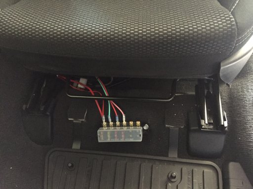

Wiring went through the firewall inside the main wiring harness mess. Used a metal coat hanger as a fish, taped the wire to it and pulled the wire through no problem. The small hole in the rubber boot sealed itself as the hole we made is so small. The fuse box was added under the drivers seat as shown below. So I now have 2 extra spots in the fuse box for additional items if needed.
Guess I should have put this photo in my build thread.
I'll add a new fuse box under the hood for any additional running lights I add.
