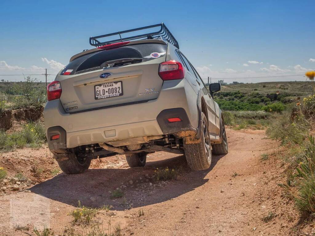

Happy to see that no matter the group or event there are always Subaru guys and gals out there! 2015 Subaru XV photo is a little old had some red rally armor mud flaps installed and hella horns. Member #3398
Welcome! and nice pic Sandwagon.
