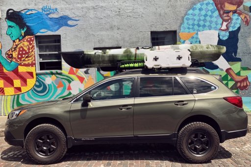

I am waiting on running through my current set of tires before I get to the fender flares. I tried on a set of 2" wheel spacers on my Outback. I have a set of 17X7.5 Sport Edition P3 Anthracite Wheels with a 38mm offset and a set of P245/65R17 Kuhmo AT51 tires. The tire sits pretty close to the spring boot on the strut tower so I wanted to make some extra room. Plus, making the track wider would counter the loss of stability from the lift kit. It looked amazing. However, I would get tire rub on the front or rear bottom of the factory arches. So the spacers had to go. When it comes time for a new set of tires (I'm only about 1500 miles on my current set), I think I'm going to install some fender flares and cut away the excess. The concave nature of the factory wheel wells really limit the spacer option and size of the tires you can fit in there. I am happy with the tire size I have now. If for some reason I wanted to get larger tires in the future - I would have to cut into the car. I'm trying not to do that, especially since I haven't even had the car long enough for it's first oil change yet.I put my front fender flares on finally, still have to find time to do the rear. I’m taking it slow and trying to do it perfect since I plan on cutting the fenders when I’m satisfied. Thing is, now I don’t know which direction I want to go with fitment. I’m thinking wheel spacers since I don’t mind the stock rims, but I’m not sure about how wide I would be able to go with those before it really starts to wear on my suspension. I could just wait and get wider wheels and a lower offset but I just bought new tires a few thousand miles ago. Any advice?

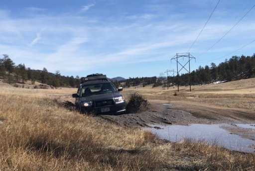

Your rig looks awesome manI

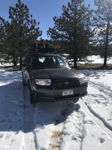

I am totally jelly of your Forester! One day my 2008 might look half as good as yours. Lol!

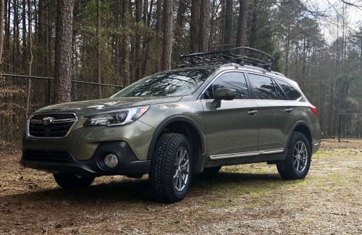

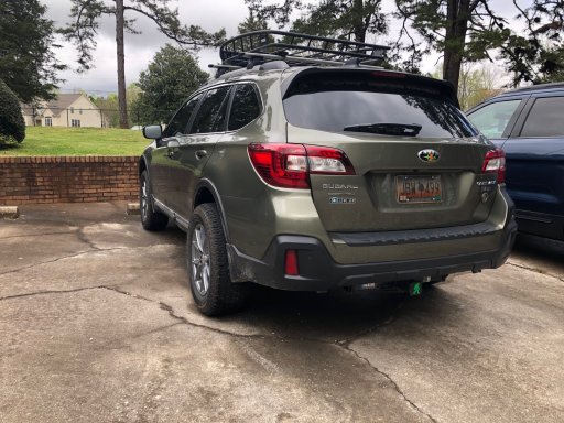

What size tires are you running?View attachment 92100
ADF Lift installed on the Outback today! Looking mean. 2” on the front end, 2.5” on the back to account for some tow weight.
