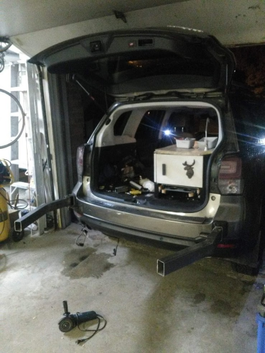

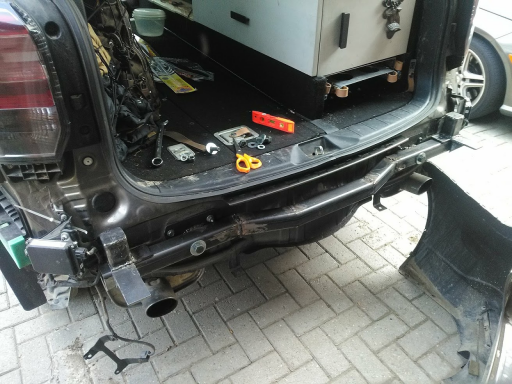

Thanks! I actually like the rear bumper and the sill plate design, so I wanted to keep it, plus I get no better of a departure angle if I remove it (due to the exhaust location).
I'd guess my bumper weighs 40 lbs altogether. That said, standing on the back of the car, the suspension compresses no more than 0.7"... and I don't plan on putting 150+ lbs of gear back there anyways, so all should be good.

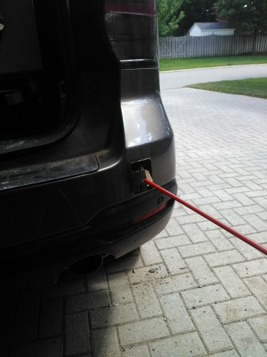

One thing a few people asked about is how I lined up the bumper cut-outs. This method worked very well for me:
First; I cut out a template of the bumper tube from cardboard, screwed it to the end of a fibreglass snowplow marker, attached it to a tripod, and positioned the cutout where I wanted it on the bumper cover. Next; I got a skil saw and cut the bumper. Finally; I realigned the tamplate with the hole I just cut, marked where the pole sat on the tripod, removed the pole, removed the bumper cover, put the pole back, and I knew exactly where the bracket needed to be bolted/welded on to go through the cutout, since the template sat where the hole was located.

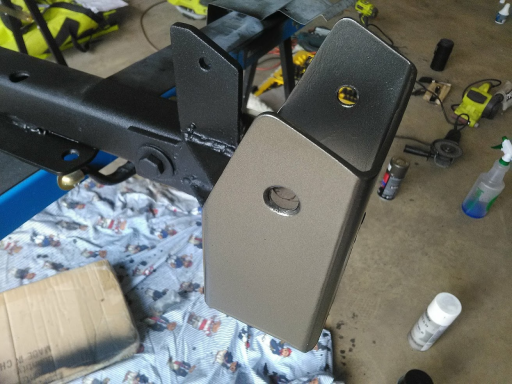

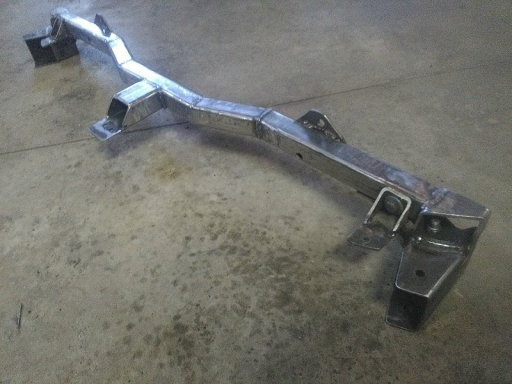

The bumper's "skeleton" has been coming along nicely...
This is what's hidden underneath the bumper protector. I wanted the structural stuff there for the cleaner looks and the protection from salt spray on our winter roads.

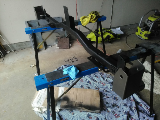

POR-15'ed, painted, and just about ready to go! Turns out "Ford Dark Mineral" paint is the same colour as my Subaru's!
Nice work, looks super clean! Can't wait to see it in full effect.
