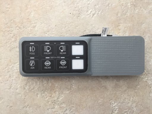

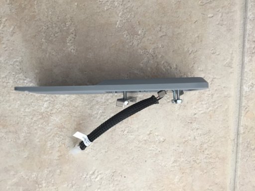

When I bought the van, it came with a Switch-Pro 8100 that had not yet been installed. It also came with a mounting bezel that was custom made with a 3-D printer. Although it got a little hot in the printer and did not come out exactly as the previous owner had hoped, once installed, it looks pretty good.

That turned out great! Nice idea.

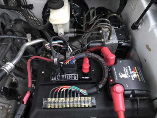

I run a switch pros 9100. Clean and simple install and very customizable. Like mentioned above it’s solid state so no external fuse block required. Circuit overload protection is adjusted and set through the app. I can’t speak for the SPOD since I do not have any experience with it.
Either option can control an ARB dual compressor without any problems since you will be controlling the relay and not the actual compressor motors.

What looks like a fuse block in the picture is actually a screw terminal connector. It makes for a cleaner install when connecting outputs to the Switch-Pros. The battery isolator is a 150A Battery Doctor. It was super cheap but has worked flawlessly for about a year. The isolator feeds two 95 ah batteries in the bed.

One small ground for Switch-Pros control unit connected directly to neg battery post. Ground for individual outputs/ loads connected to different chassis grounds.
