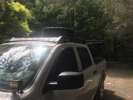

I gave up and put the full size tire on the top. It works and does not kill the mileage any worse then everything else.

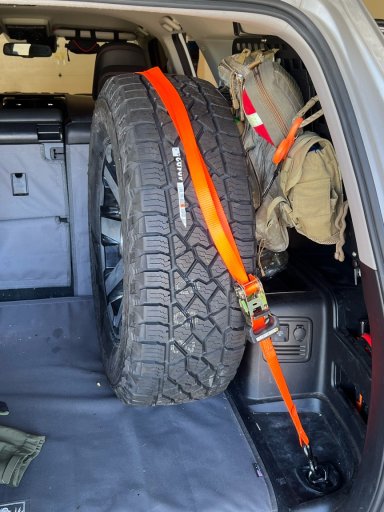

I’ve done this through a bunch of Oregon into N Nevada. I agree, great place to put the spare IF you don’t need your whole rack and want to keep everything inside your cab. I didn’t notice it a bit either, and I had it zip tied and ratchet strapped down. The other option I mentioned on another post, was strapped down in the rear cab, photo below. Both ways worked fine for me, shifting other gear around.
Is it the best place to mount it; no but it works and I do not notice it that much while turning.
