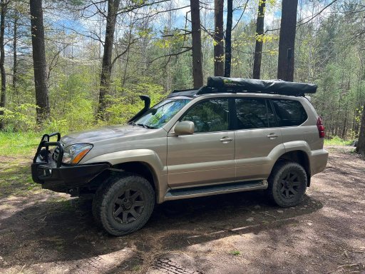

So I’m thinking of adding a snorkel to my Tacoma. Not for water crossing but for the supposed benefits of cold air induction. They say the engine runs better, better mileage and maybe increased horse power. Anyone have a snorkel that can attest to these attributes? Any mechanics want to chime in? All the help I can get would be appreciated. Thanks
Just added one to my GX470
