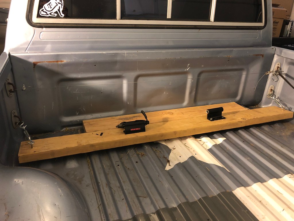

finally finished my simple dual bike rack setup with inset captured nuts in the board to keep the bed from getting too scratched. plus i've always wanted a reason to use them. pretty pleased with the decision.

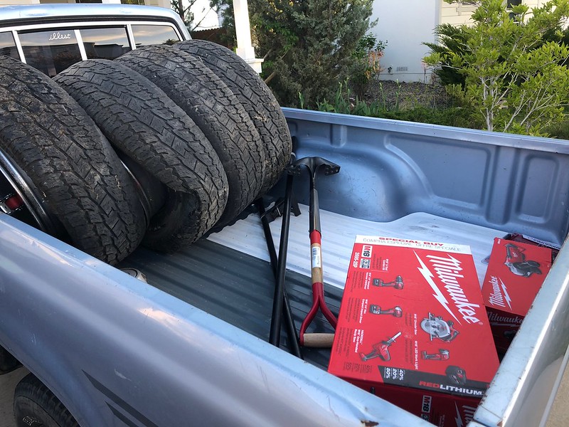

after some craigslist runarounds (literally, i ran around all weekend after items from cragslist ads), i ended up with some wheels from a wrecked '97 FJ80 with popped tires, and some yakima crossbars that span the whole bed. in the next couple of weeks Shirlee will be getting some new shoes (what do you call wheels if tires are considered shoes? feet?) in the next 2 weeks. finally.

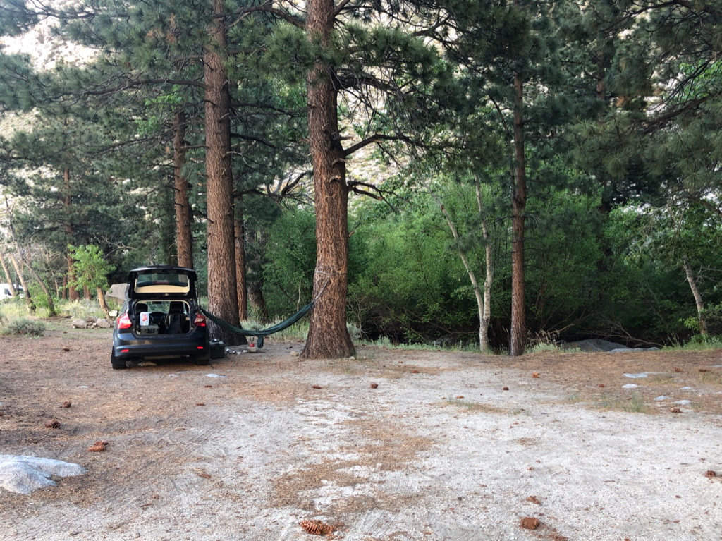

Memorial day weekend I went and camped in bishop on my way back from Vegas. Found a good camping spot and slept in my hammock for the first time this season thru the whole night. And I did the whole trip in my daily named Lola, a 2014 Ford Focus that I guess could also be considered an overland vehicle.
Campsite with hammock attached to the car
And the amazing views I woke up to
Both where literally shot from the hammock.
I'll definitely be going back to do some climbing there in the near future.

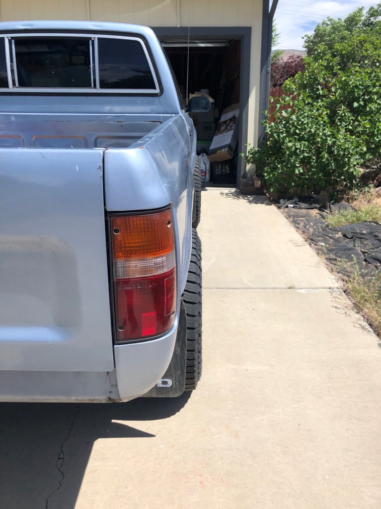

Then this last weekend I finally got new tires for Shirlee. I'd been waiting to get them until I made a fully thought out decision on the tires I wanted.
The look for the truck turned out honestly better than I'd hoped. The stance is perfect. No rubbing. And they look right at home on there.
Stance
I also picked up some trail tools. Can't wait to use them this weekend!

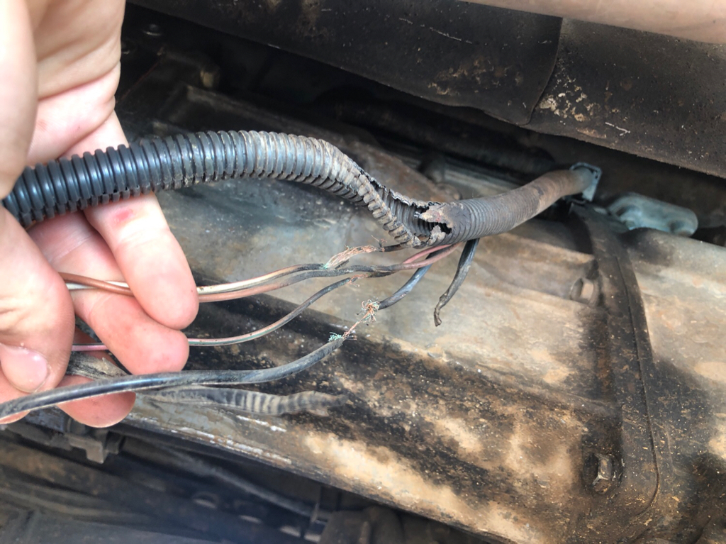

last night while driving home from home depot, Shirlee died on me going around a roundabout while exiting the interstate
i was picking up a small selection of lumber to rebuild the bed rack i made in order to hold my gas can and water can more securely, pics to follow.
got my roommate to tow me home (maybe 1/2 mile) and started on my discovery to figure out the cause.
first thought was fuel pump cause it would crank but not start.
then i realized i wasn't getting the check engine light (MIL) coming on when going from off to ACC with the key. \
Quick check of the FSM shows MIL lamp on the EFI circuit. checked the EFI fuse under the hood.
Sure enough, efi fuse was blown. took the fuse from the cigarette lighter circuit and put it in the EFI fuse, and she cranked right up no problem.
Now i need to track down the cause. my thought is O2 sensor wiring grounded out and shorted. but on further reading, it could be the fuel pump wiring or the knock sensor, with the former being more likely. i'll have to dig into that this weekend and track down the culprit.
al in all the experience wasnt too bad. i'm just glad i wasnt out in the middle of nowhere with no cell service or putting down the freeway when it happened.

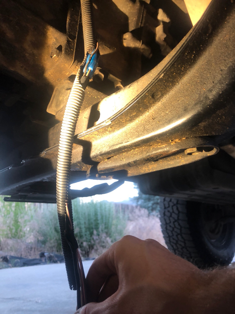

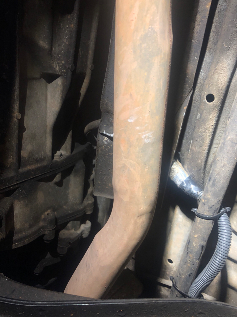

Figured out why the EFI fuse was blowing. The O2 sensor wiring had moved and fallen out of its clips under the truck. The wiring harness fell into the exhaust and melted all the covering and insulation.
I'm currently fixing it and will make sure it's much more secure from now on.

I just finished the fix. Literally just got out from under the truck and started it. No CEL, seems good to go. Wire is nice is secure now too.

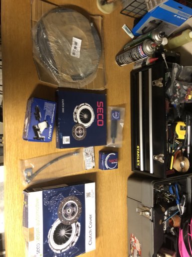

Aaaaaand... Let someone drive Shirlee and they roasted the clutch. So I bought a new one. New Marlin crawler 1600 lb clutch, New flywheel, and other obligatory accouterments.

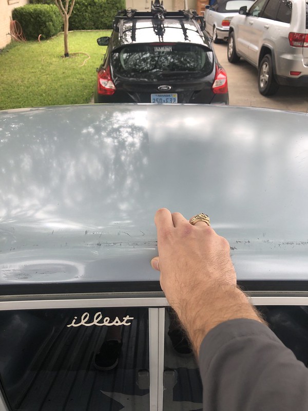

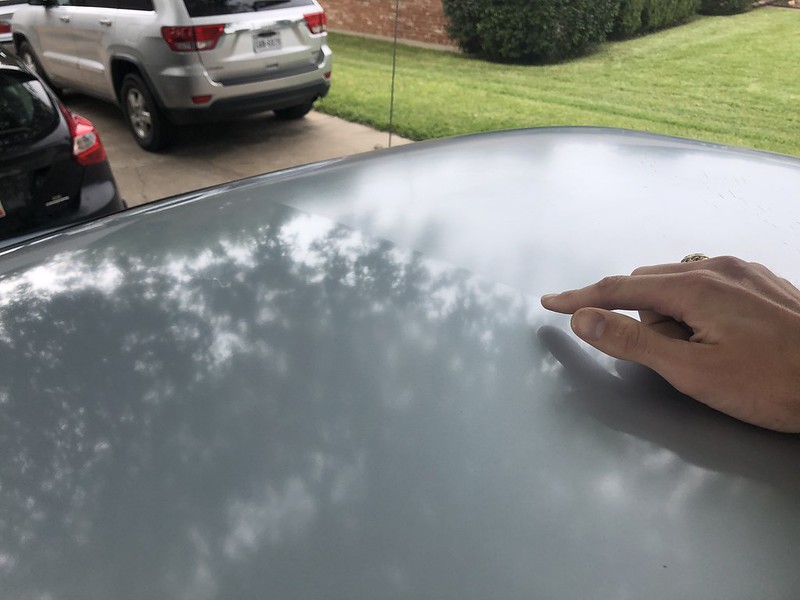

Started the slow paint correction process on shirlee. She'll still be a 10 footer, but at least the paint between the big scratches will look good. I'm going panel by panel as I have time. Clean, clay, compound, polish, wax. Here was a test on the worst panel on the truck, the roof:
The left side is finished. The ride side is untouched
It's really gonna pop once i finish it all up and put some wax/sealant/(maybe)ceramic-coating on there. i do love the color of this truck . it's unique and iit's held up for 28 years really well. eventu

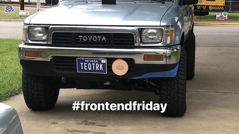

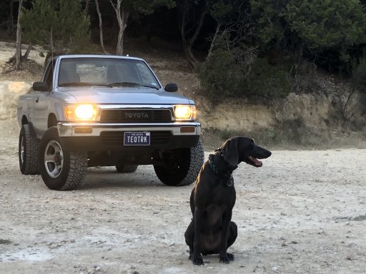

I've also been mocking up some new lighting ideas. I have some hella black magic lights on order. This is where I plan to put them. I also plan to cut off the blue taped part of the bumper on both sides
Here's a mock up using a disc the same diameter as the lights.
I'm leaning toward this option
This is also an option. I like it lower tho
Nice job. Sorry your not still here in NV, you could have coached be on waxing. What is the clay for?
Agree. The lower position is best.

The lower position is not a good thing in Texas as the roads have rocks that love low uncovered lights. The truck just keeps looking better in every post.
