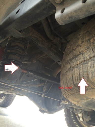

Got my Sonoran Steel adjustable panhard delivered today. Steve was great to work with, what with my newbie questions left and right. I'll get that on and report. No one told me, after the gazillions lift/suspension threads I read, that the sideways pressure increases so much with a 3" lift. Anytime I hit any kind of bump, my ass flies passenger!

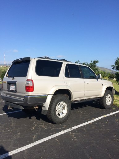

just looking at the picture above again...that's at 15 psi or lower...those load E tires sure don't bow out much, do they...

Installed Sonoran Steel Adjustable Panhard Bar! No more crabbing and having my rear end fly sideways over every little bump (yeah, I know, that's a loaded statement) BUT! Of all the millions of lift threads, I can't believe this isn't stated more. I had a HUGE improvement in ride and handling and can't recommend it enough.
