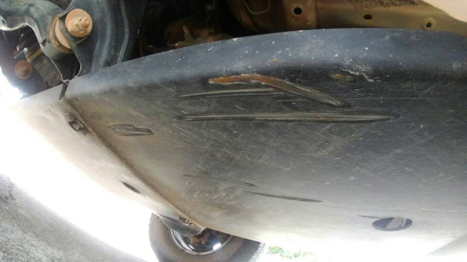

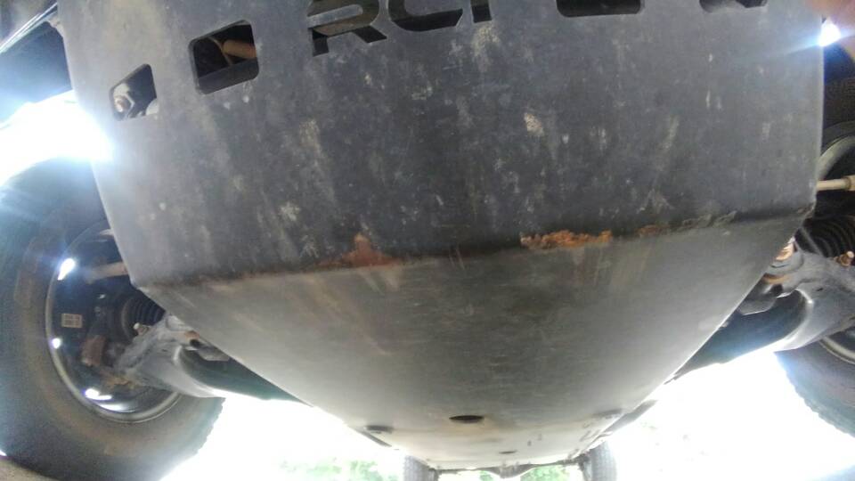

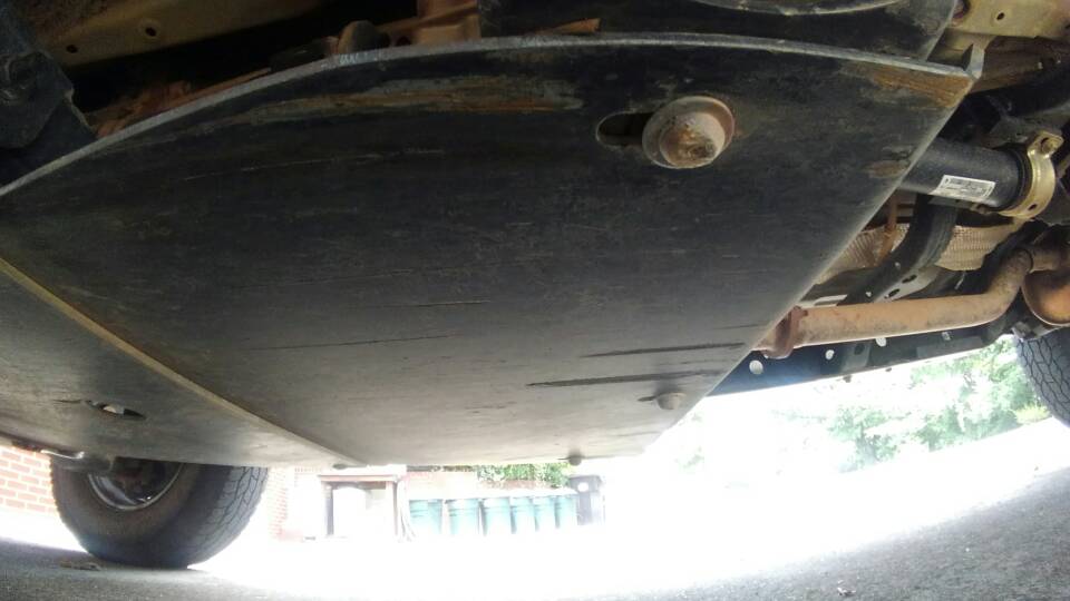

I bought a set if RCI plates for my Tacoma. Many people question whether to get a power coat or do a home bed liner job on them. Here are some unscientific results of my project.
My front plate is powder coated. It shows rust from hard use.

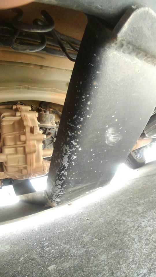

My second and third plates are home bed liner covered. (Rust-Oleum). They to show rust but the coating is gouged in places but still protecting.
Follow directions for the spray on liner and prime. The cross member shows the damage going to the primer but not rusting in many places.
The bed liner to me seems to do a good job for less dime. I will repaint some time in the future.

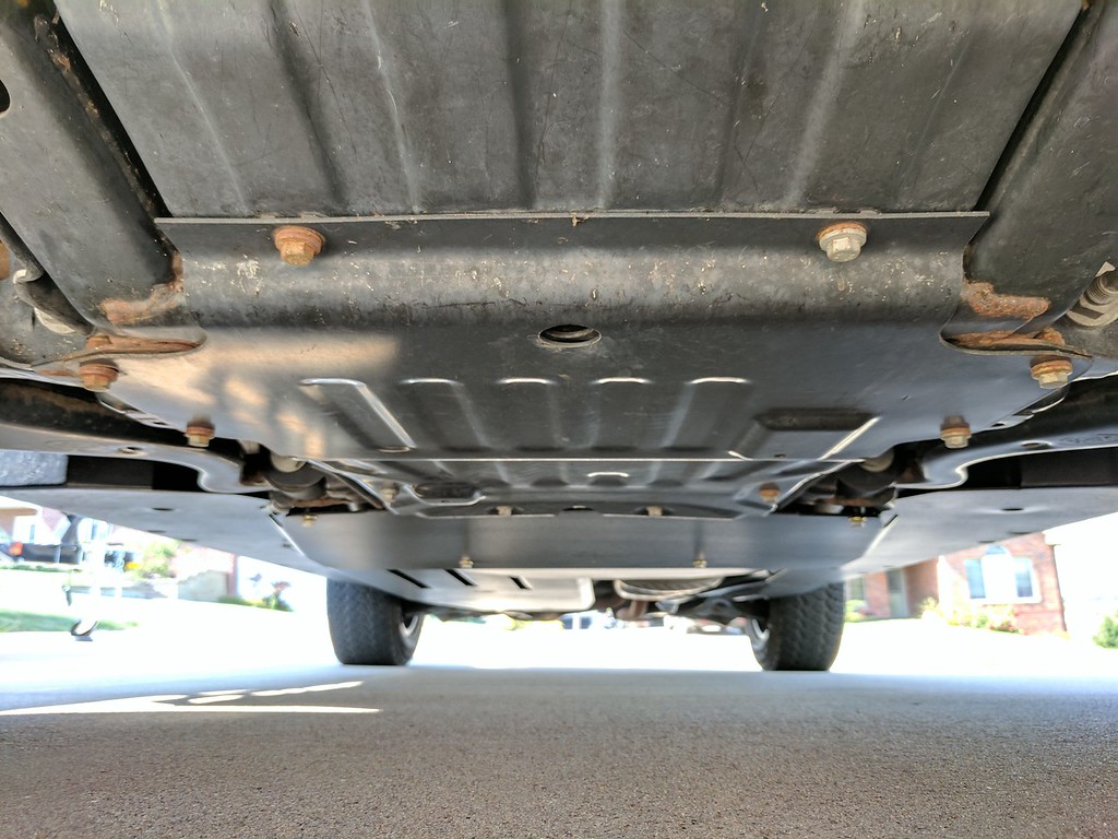

To save money I painted my sliders myself. Mutiple coats of primer followed by mutiple costs of RO already bed liner. I love the finished look. They match my ladder and roof rack (which were powdercoated). So far they have held up well. It's good to know that I can always touch them up in the future when needed.

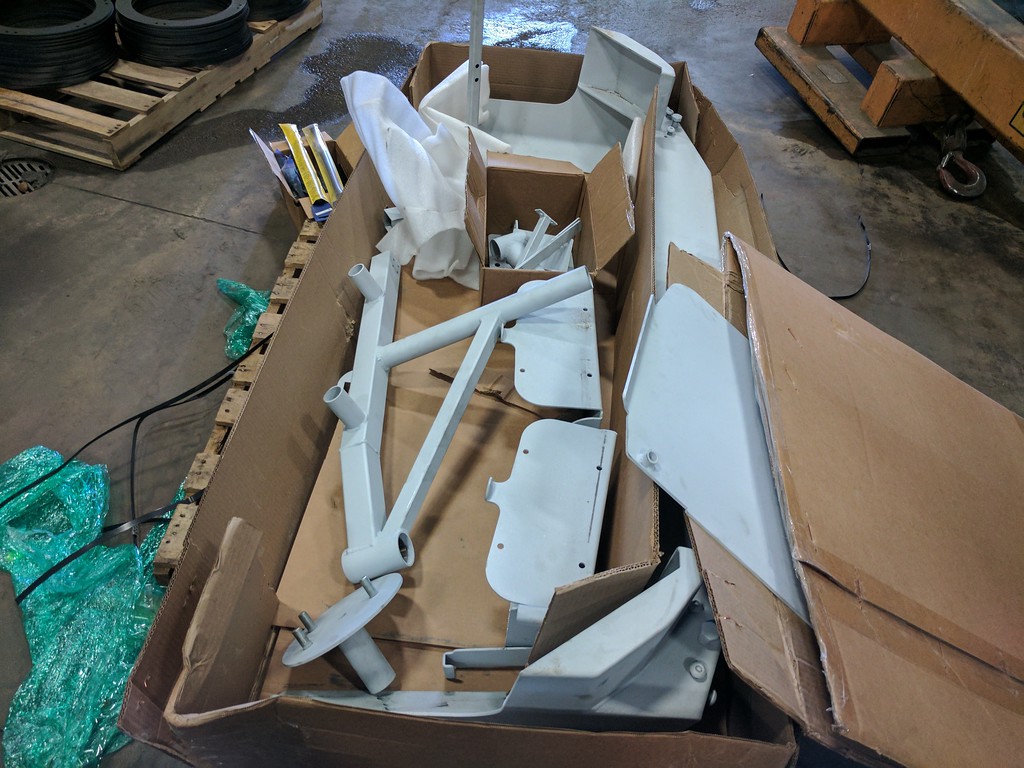

The outfit I bought my sliders, skids, bumper from (Tactical 4x4) uses a place called Zinc Nation (zincnation.com) Which sort of galvanizes steel with a Aluminum metalizing process.. basically sprayed on aluminum coating. http://www.zincnation.com/itWorks.html
Says right on the front page .
If your pieces are metallized by us, there will be no visible rust for 3 years! No steel erosion for 10 years or we will metallize your problem pieces again for FREE!*
. Even if it gets gouged it is supposed to still work, but it is pretty tough to mess it up.
I had them all powder coated also, but that is just for cosmetic reasons, they are rough textured white with just the aluminum. (the parts are steel).

to add,. that metalizing option might be a rare option, I'm not sure, wasn't trying to make it sound like that's the only or best way. the powder coat guy i use hadn't seen it before either.
what i did before was powder coat with paint touch ups and periodically sand blasting and recoating... it sucked and i got rid of those sliders in favor of these. iowa road salt is insanely evil stuff.

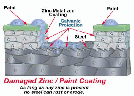

And what happens when you drag a rock over it exposing new metal??
From my link above... http://www.zincnation.com/itWorks.html
Damaged Zinc metallized/paint coating. The galvanic effect.
Inevitably coatings get damaged. As we have seen with coatings that offer only barrier protection when damage occurs, rust and steel erosion is inevitable. This is when the true magic of metallizing is understood. Metallized/paint coatings can be scratched clear through into the steel and because of the galvanic protection achieved with metallizing, rust cannot occur. All of the zinc in the area must first be used in the corrosion process before any rust can happen. This can take 15 to 20 years.
