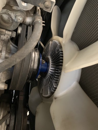

I also took this opportunity to install a Wits-End modified blue fan clutch. Its an OEM Aisin unit with a higher CST oil installed and valve plate advanced so that at any given temperature more oil is being sheared. A larger charge of oil is introduced to the clutch to support the fact that more oil is being sheared. Since cooling is critical with these engines I want to make sure everything is as good as it can be.

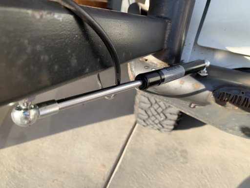

I also fixed the rusted and missing rear swing out strut mounts using aluminum rivnuts.

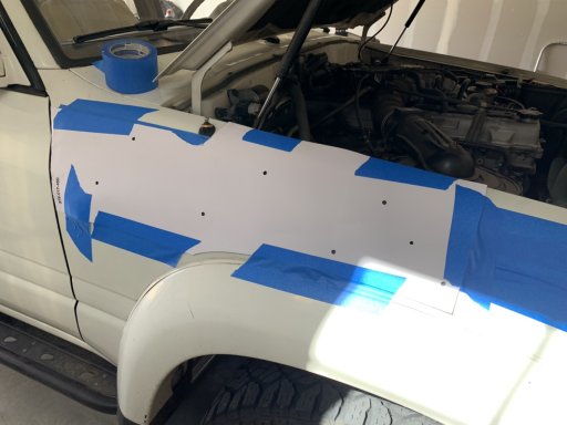

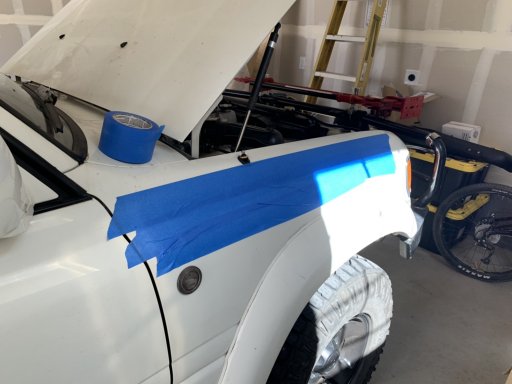

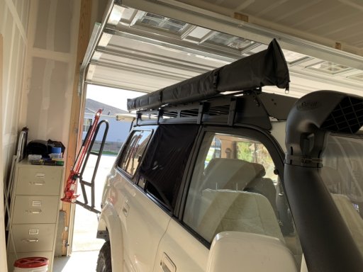

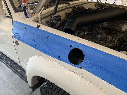

Well, I found time over the weekend to install some parts that trickled in over the past week. First up, the ARB snorkel. I debated for a while whether or not to drop the $$ or buy a knock off, but in the end I wanted to do it right. Install was fairly straight forward and everything went well. It was tough to start drilling though...
Then I installed an awning I found on Amazon. It seems well built and sturdy. I figure if it gets used enough to wear out I’ll replace it with one of the name brands.

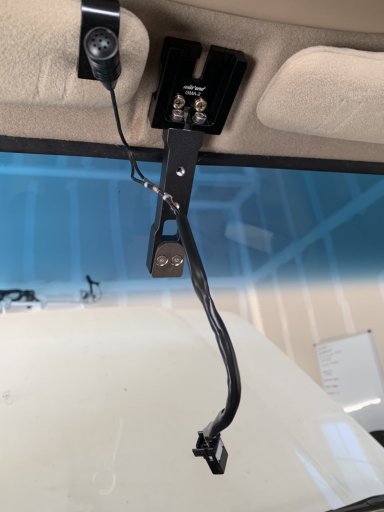

I also picked up a mirror adapter from Wits End and an auto dimming/home link/compass Gentex rear view mirror. Fairly trivial to bolt the new bracket in and wire it up.

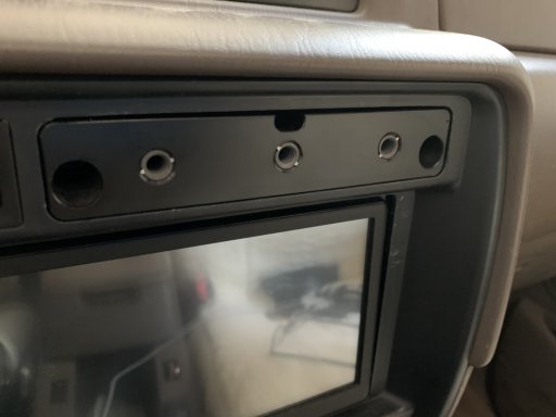

And finally, I installed a panel that replaced the useless cup holder cubby. I plan to mount my scan gauge there eventually.

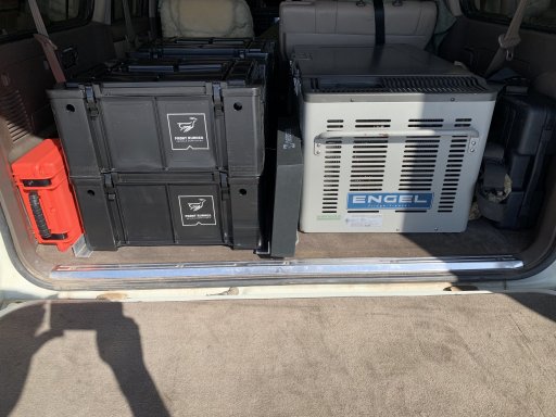

I found a great deal locally on an Engel fridge/freezer and have started to design a rear storage system using aluminum and Front Runner WolfPacks. More on that later.
