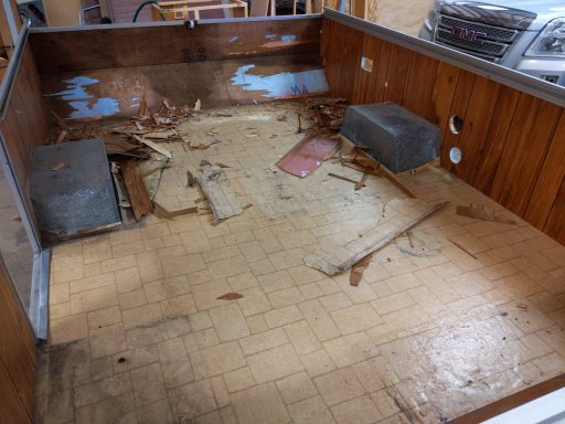

The tear down went quite quickly. My wife put her old house restoration skills to good use here...
Now that tear down was complete my wife began focusing on rebuilding the interior and I started focusing on the chassis. The plan here was to rebuild all of the cabinets making them stronger but also by using redwood and cedar we would make them more resilient should they ever get wet, and naturally bug resistant. Install floor insulation and install new floor.

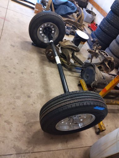

Meanwhile I would remove the original axle and build a spring box to mount traditional leaf springs and a new 3500# axle with the biggest tires I could reasonable make fit.

Cool.....what did you do with the underneath part of the floor? I too have dealt with my share of unknown rot in a popup.....but they sure are fun!
The underside of the floor is intended to remain bare. As it is marine grade OSB it either needs to be 100% sealed (which is not practical) or one facing needs to be left un coated to allow the wood to breath. That being said, both popups have solid floors. Olive will need most if not all of the front wall replaced though.
I like the axle work.... slipper springs ?? can you 45 the notches ?
And the wheels, tires look positively retro, great choice.
Thanks man.
I went slipper spring to make spring mounting easier and cheaper. Also this is not going to be a serious off road trailer so it was a good trade off to me. As far as the notches go, i put a bead of weld at the corners to strengthen them. Also the sides of the spring box are 2x2x1/4 angle and the top is backed up by some 4 x 3/8 flat bar so I'm not expecting any issues there despite the sharp angle. As far as the design side of the notches, it was an oversight on my part, I made the notches after I installed axle and realized that as the spring compresses there would be no where for the spring plate to go. So I notched out the sides as there really shouldn't be much load on that part of the sub frame. Now if it were an off road trailer where I might side load the axle hard, or a multi axle set up where there would be significant side loading during turns I would have rebuilt it. That being said it is one of the ares on the sub frame that I will be inspecting for cracks.
