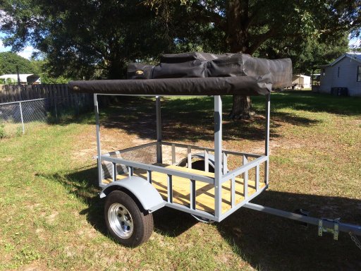

This is my first trailer I’ve built. Tongue to back is 9.5ft, 4’x5.5’ I mounted the tent frame centered over the axle. It sits 5 ft high. I added gas struts to lift it 10” if needed. I have 12” space under neath the tent if needed. Lights all around under the tent. Added a 270 awning, that I also made.

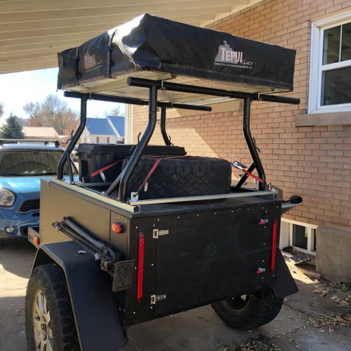

Looks like you’ve got this figured out now, but I’ll chime in for others who may read this thread. I’m 80” to the bottom of the RTT and an outside width of 72” on the wheels. It’s a great height for the annex (which we never use). I’ve had it on some fairly technical trails, including some pretty good side hills with no worries. My box is fairly “dense” so it has more weight down low than the converted utility trailer that started this thread, but I’d have to get pre-tty rowdy to tip it on its side.
