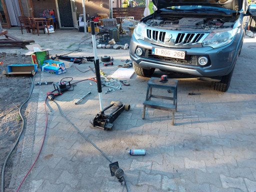

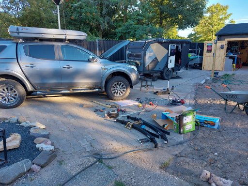

Yesterday and today we work on the Mitsubishi L200 of Toon.
New EFS suspension.
3cm lift but in the front plus 65kg load capacity
damned, not quit the best picture but 90.5 cm to fender.
Again a bad one, but hey, it is the size that matters. 3 cm difference.
Today after the find out stage of yesterday the second front suspension was a piece of cake.
Now the rear.

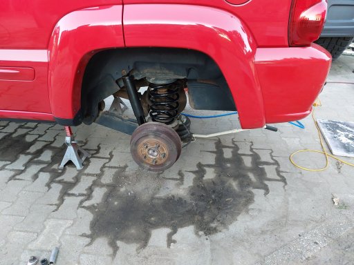

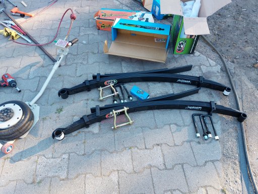

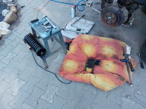

Again a suspension swop with EFS. I guess I should ask EFS to be a certified dealer and mechanics. hahahaha.
So, today I have Jan visiting me and we are working on his Jeep.
So just before dinner we manage to swop the front.
After dinner we do the back as far as we like. If not ready we will do the rest tomorrow.
Here some pictures as a little report.
When you take your tires off you will find some mud. hehe
The old ones out.
Cleaning up some parts.
New one ready for installment.
Cleaning up before we will put the tires back.
After dinner we will do the rear axle.

Rear is done as well.
I hope to say bye bye tomorrow and hear when he arrives at his destiny that he is a happy Overlander.

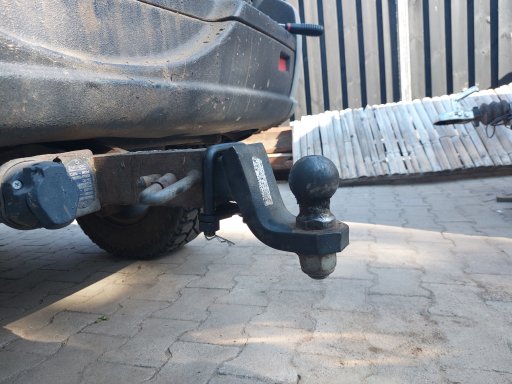

Done, this was a little project that I have done to reduce the annoying clunk that was there because of the play you have on the hitch receiver and the hitch itself.
Now the clamp is making the play go away.
As this isnt an idea of myself but it is a thing that exists and is sold at several places in several shapes.
Mine is just DIY made and didnt cost me a thing except for having some new tools. But hey, that is a thing that I can use like all the time.20220825_163659.jpg
Hitch silencer just mad from an old rear leaf spring mount and some old plates I have.
Even made a little r-clip to secure the nut.
Will receive new r-clips tomorrow so both sides will be secured. Bit of lock tight will keep the nut tight

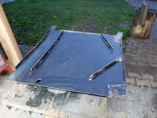

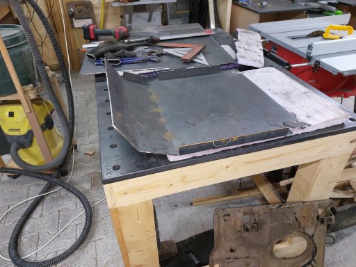

And today I did work again a bit on the body protection project.
Yesterday we did fit my rocksliders to the Jeep of @wilderwhere and it fits like a charm.
So now I can just replicate my sliders twice and we are good.
Today I started with making the engine skid plate. I took @wilderwhere his OEM skid plate and make one for me which should at least fit on the same bolt and nut places as the OEM.
Off course, mine will be different, but hey, that doesnt matter.
I hope tomorrow to finish most of that, and cleaning up my sliders.
If I get it right, I can make it fit correctly tomorrow and then start welding everything nice and sturdy.
Again an @Overland Bound Team project which involves more OB members from Mid Europe.
Reactions: MazeVX

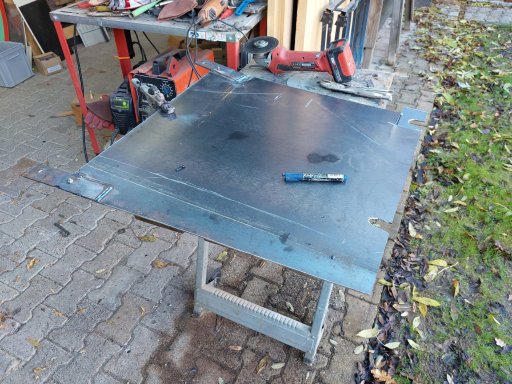

Todays work made the skid plate almost complete.
Tomorrow just making brackets for the front bolts and spacers to hold the plate firmly at its place.
Only downside was that I broke a bolt in the frame. That has to come out tomorrow as well.20221025_141734.jpg
After a lot of welding, including fixing a minor mistake.
It is getting there. Looking much better already and almost in the right shape. Still needs some adjustments.
Not that bad I guess

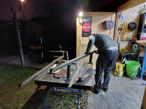

It was two days of work, last weekend and today. But we managed to make a set of rocksliders for @wilderwhere / Jan his Jeep.
They look mostly the same as mine.
I think he will be happy when they are under the car. Especially for our trip to the UK/Salisbury Plains. This one orgenised by Leann and Nik.
Jan is doing the finishing touches.

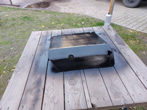

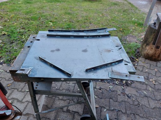

So, after our trip to the Salisbury Plains it was obvious that there was a need for more protection under the car. So here is my second skid plate.
Does the transmission and the exhaust part of the car.
first part, everything roughly to fit and then were the reinforcements has to be.
And here are all the reinforcements in place, well amost all of them.
And here is the Skid plate ready for the paint.
And this is how it looks unde the car.
Not that bad I guess.

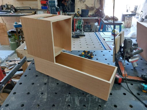

First for Michael @Micha_TROOPY a arm rest and mid console for his Troopy.
It is a bit of a challenge as I dont have mucht to work with. And I mean measurements.
So, I made two parts. Completely rough shaped that I can start working with.
One part will be the bottom and will be mounted next to the handbrake.
The other part will be the arm rest itself and that is now still moveble so when all works out, on monday we can test fit it and mark the right distance to front an back.
The bottom part should hold two water bottles. And some places to put little stuff as coins, and such.
The top part is the arm rest and will be holding two drawers for conveniance
As you can see, the side towards the driver is hanging over. That is because of the handbrake and so the arm rest will still be right next to the seat.
It is all in very rough form, nothing is already glueed and done. So after all the measurements It will be taken apart, get a nice shape and will be coated with carpet to make it looks good and feels soft to the arm.
Think that if things come right, it will be a good looking arm rest.

Thank Robert for his time building my armrest, support and his technical knowledge! I'm absolutely happy!
