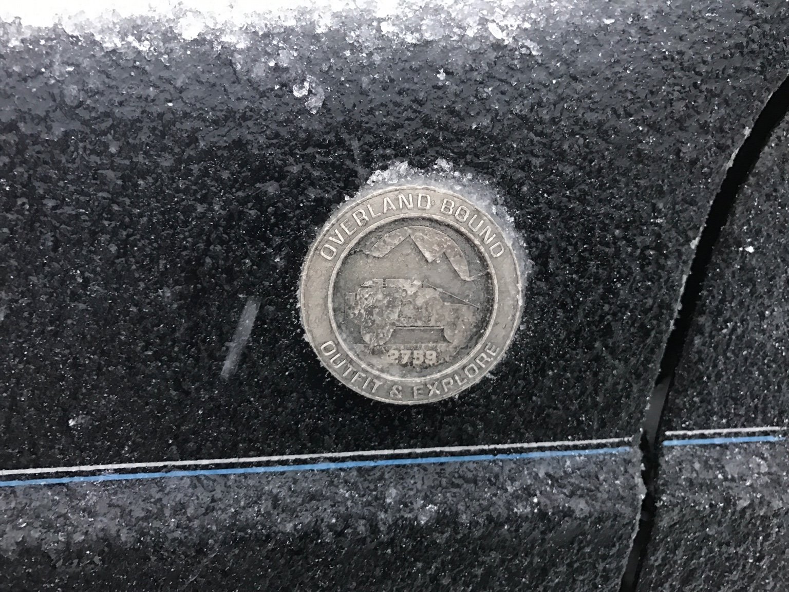

Today I also realized I haven't post any photos of my OB badge yet. Luckily a I just recently took some in the midst of a big ice storm!

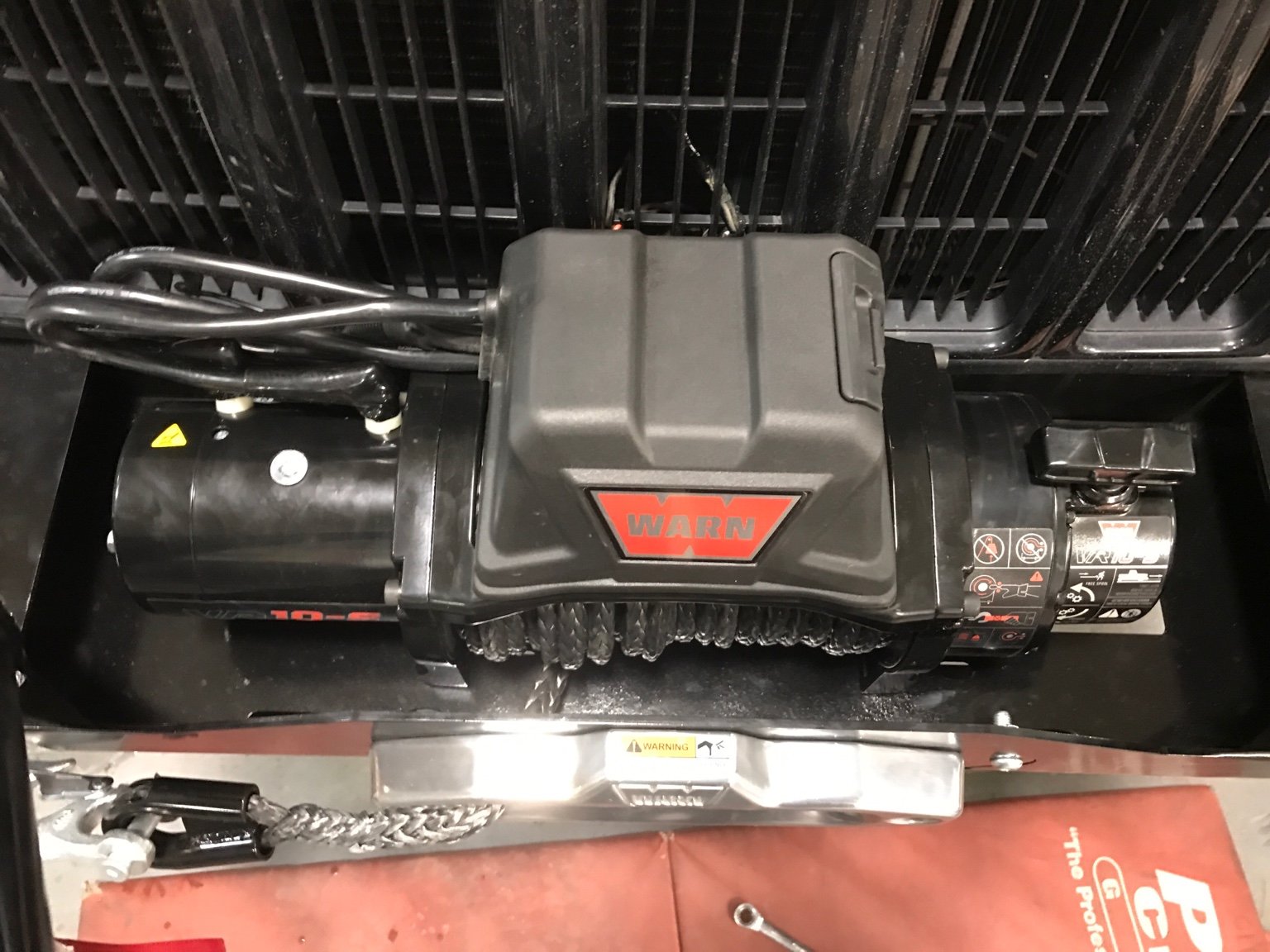

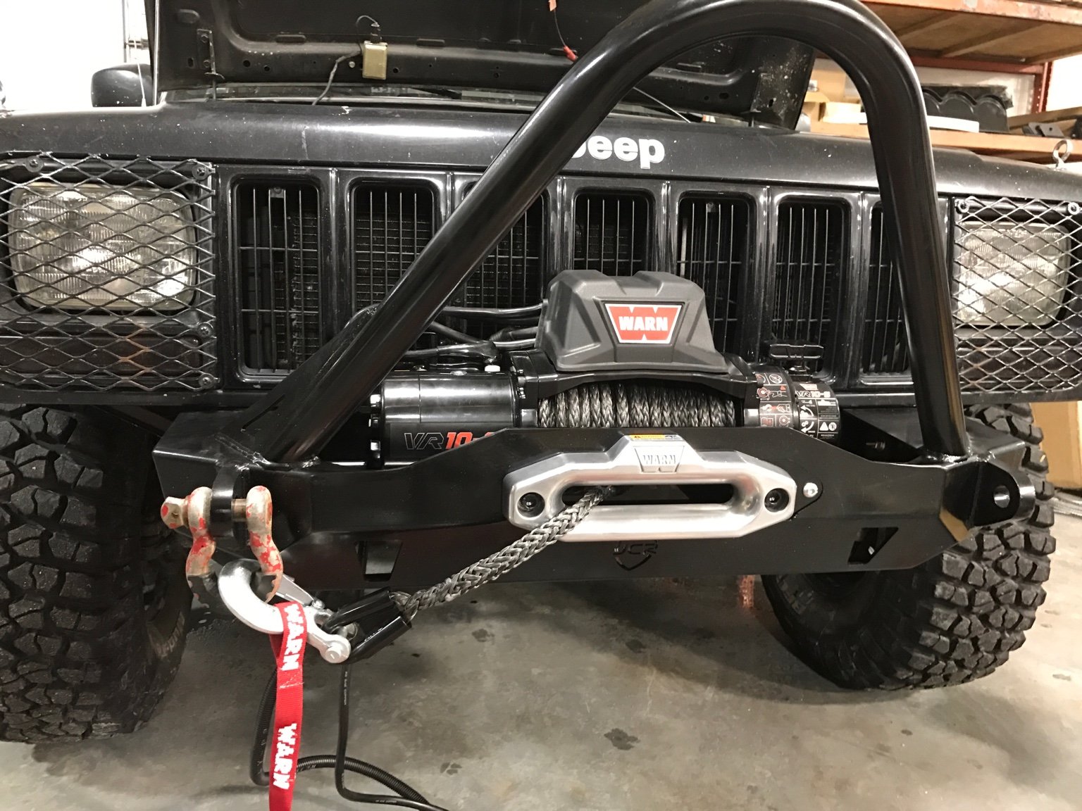

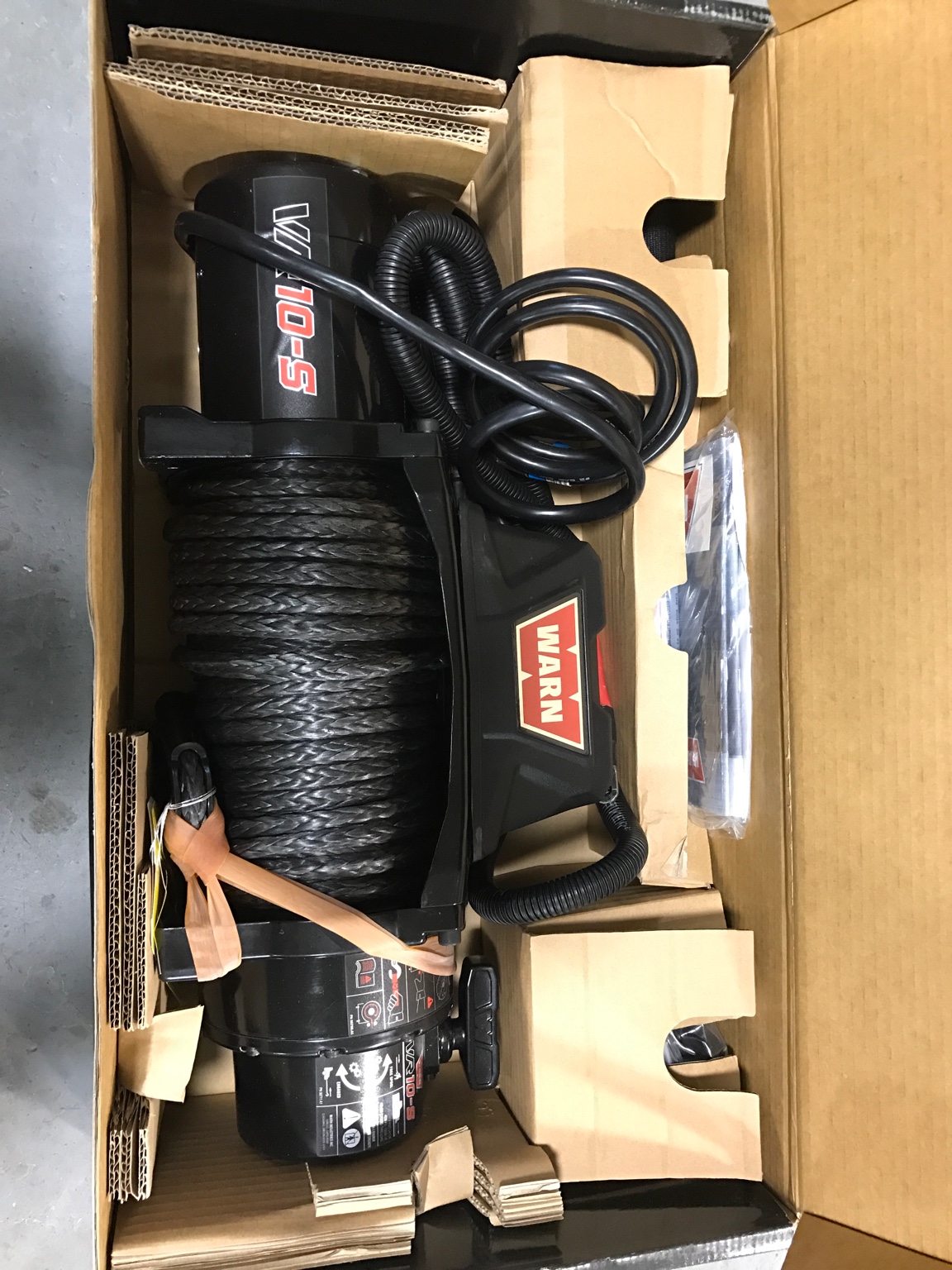

And I was able to get it installed!
After much thought and reading a lot of reviews I landed on a GenII VR10-S from Warn. It seems to be a great winch that's affordable even coming with synthetic line. It's rated at 10,000lbs which is much more than needed for my jeep but having too much capability is never a bad thing!

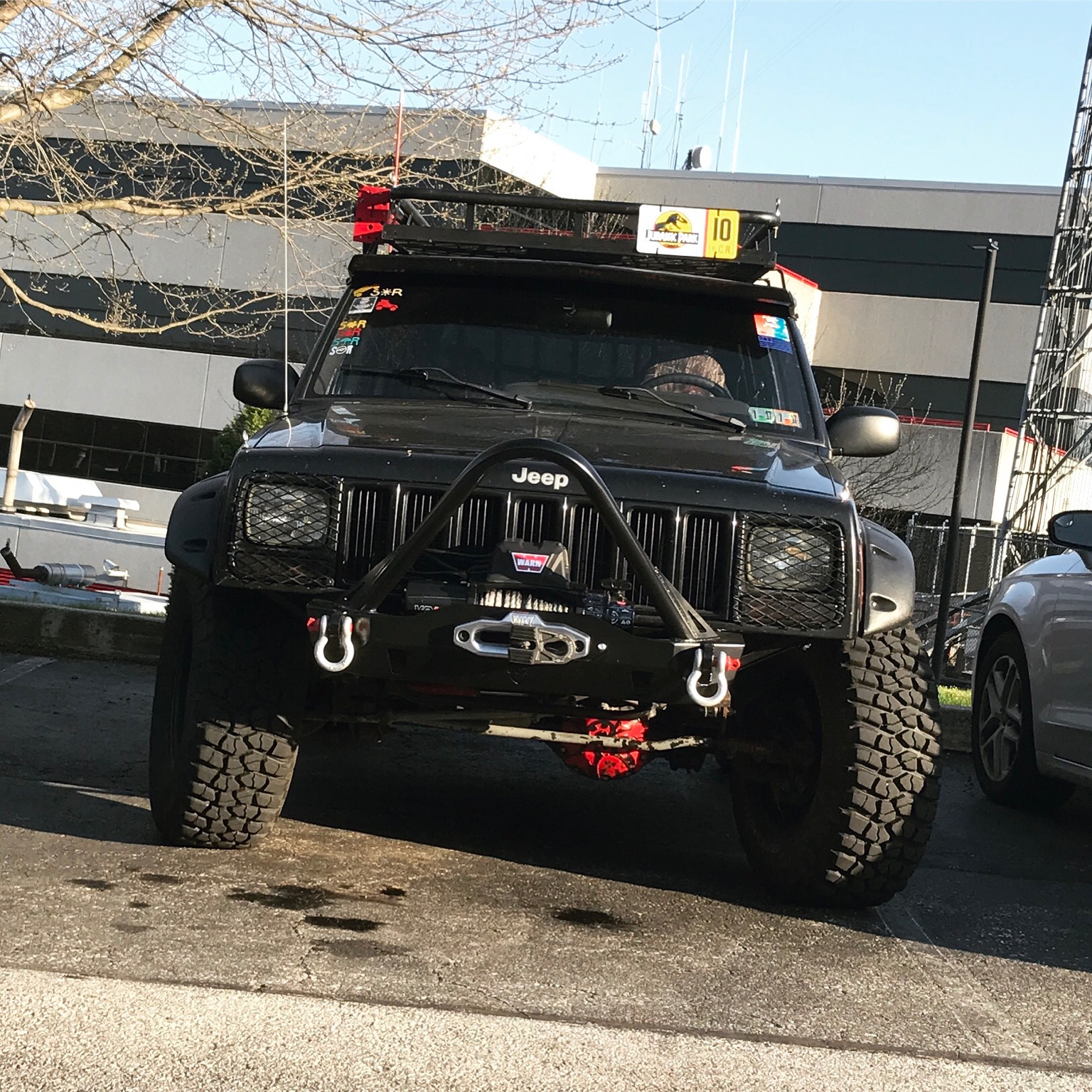

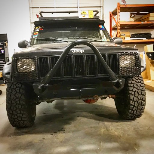

Incase I haven't posted photos yet my Factor 55 Extreme FlatLink came in and I had the chance to toss it on the jeep one day after work! It looks amazing and it'll make winching a much safer experience!
