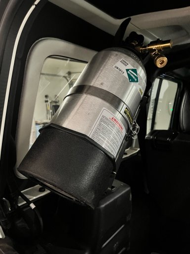

I did a DIY "powertank" with parts from Amazon. 20 pound system. pressure reduction, quick connects, 25' hose, blow gun for dust, tire fill, all for far less than half the cost of an equivalent Powertank system. I did break down and buy the roll bar mount from Powertank as it is just the coolest solution for mounting the CO2 cylinder up and out of the way. The tank lasts a long time, because after attending the Overland Expo session on tire pressures, I don't air down as much (PSI) as I used too as one size does not fit all. The tare weight is stamped right on the cylinder, and I weigh it every time I go out so I know exactly how much CO2 I have. No moving parts. Nothing to overheat (it does get REALLY cold). You can run air tools with this setup if you are so inclined. Easy to fill in my neck of the woods.

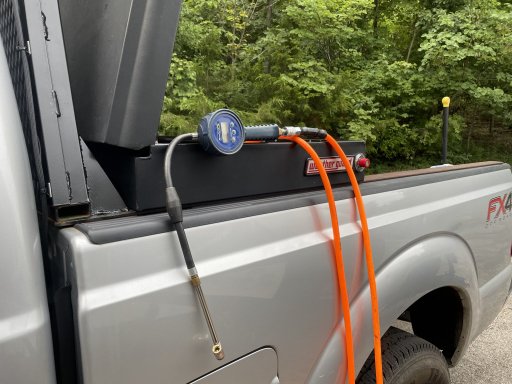

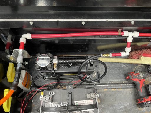

I had a smittybuilt compressor and a 2.5 gal tank that worked great on the Toyota. I have switched it to the F250 now and got rid of the tank because of space.
Still a good compressor.
