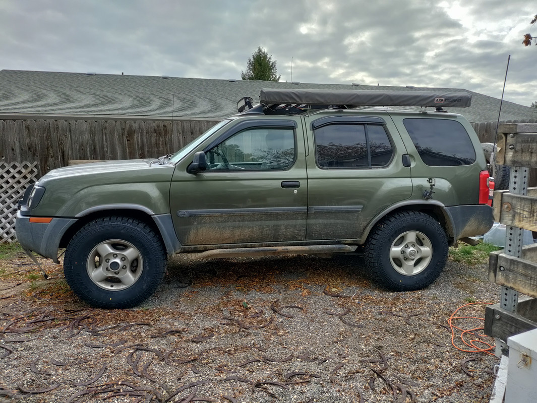

Well, overall, the truck is more or less done. I might lift it a bit down the road, replace shocks, etc, but for the most part, I've been very happy with it as is. These things are awesome, and don't require much in the way of mods. I still haven't put my front locker in, or my 180 amp alternator. I haven't really felt the need to yet.
Then there's the matter of my other vehicle. I'm waiting for my AAL's to show up, then I can lift the Fronty 2 inches. Then I need to put a relay system in that for aux lighting, sell the fiberglass tonneau cover, get a soft topper, and if possible, build a modular bed rack that can go over the soft topper, where I can remove the crossbars, in case I need to put something tall in it. You know.....truck things.

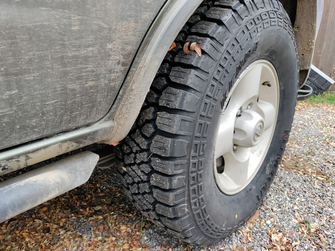

Whelp, Gamora finally got some new shoes!
She's now sitting on a set of Kenda Klever At2s in. 265/75r16 load E.
If these tires are half as good as I hear they are, then I will be very happy.
Also, I think I need to look into adjusting my rear shackles, as the back end is definitely lower than the front. But that's a warmer weather project.

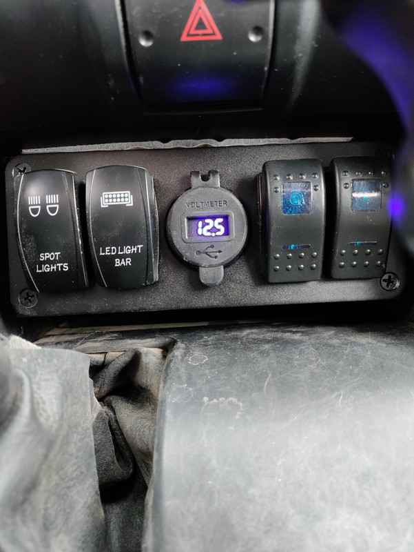

So, a while ago, I pulled out the chincey 6 switch plastic panel, and replaced it with a metal 4 switch box and dual usb quick charge/voltmeter combo.
The switches have been wired up for a few months now, but I finally got around to wiring up the USB ports:
It's wired up so that it switches on with the ignition.

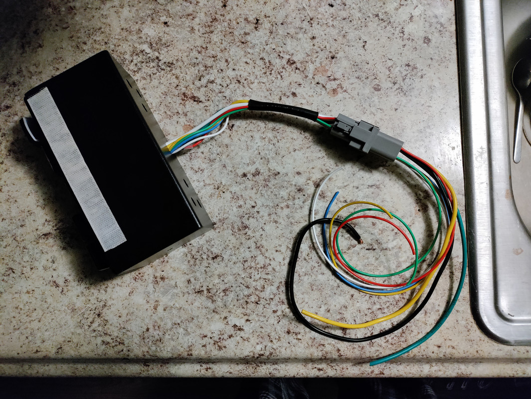

So the last couple of months I've been blowing taillight fuses. When I wired up the switch panel, I used spade connectors to make it so that I could somewhat easily remove it. In doing so, I must have crossed a wire somewhere.
I took the whole thing out, and decided to wire it up using DT connectors.
I finished making the connectors for the switches last night.
So much cleaner that what I was doing before. Yes, there are some 18ga wires in there. I'm only pushing 1 amp to the switches, and back again to the relays, so 18ga will work fine (I was using ethernet cables before, and it worked fine).
The connectors say that are for 14-18ga wire, but I can fit 12ga through there no problem. Solid contacts are where it's at. I'm pulling the relay box tonight, and wiring that up with a DT connector for the relays. I only need to run 6 wires to the back, but there's 8 at the box, as one is power for the usb/volt meter (green) and one is illumination for the switches (controlled via dash lights - yellow).
So, I finished installing the new harness yesterday, and did some testing.
No more blowing taillight fuses!
Now, everything seems to be working properly, except for one wire in the harness that runs from the switch box to the back.
For now, I'll run with three working switches up front, as I only have two lights at the moment anyways.
I need to pick up a multimeter with a continuity test feature to track this down.

I figured out why I wasn't getting the relay to trigger with the problematic switch. Turns out the spade connecter had dropped out of its holder, and wasnt touching the terminal on the relay. Reseated the connector, and everything works again!

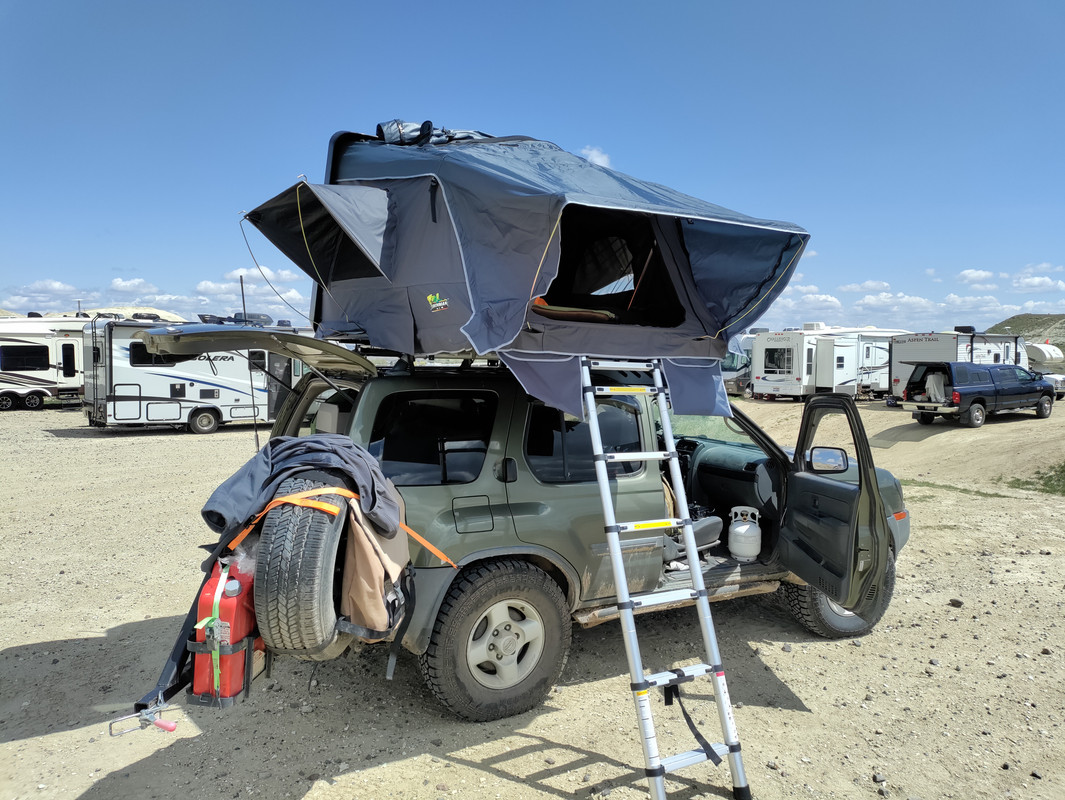

So, the wife and I have been talking about getting a rooftop tent for the better part of a year, with the intent of mounting it on the trailer once I get it finished.
Well.....a few weeks ago, Ironman 4x4 was having a 25% off sale on all camping gear. We decided to pull the trigger on the new Nomad 1300 hard shell rooftop tent. It was delivered two weeks ago, but I didn't even take it out of the box until last Thursday, as we were out of town.
A buddy came over, and we decided to toss it up on top of Gamora so I could test it out.
Looking good!
Thanks! Though, I've noticed my rear leaf springs aren't a huge fan of all the weight back there, so I may need to look at adding an add-a-leaf at a minimum to add some additional load capacity. Even without the tent up there, she's been squatting for a bit.

How are the factory rails up there handling it? I know they are only rated for something like 180lbs or something small.
Yeah, same for me... Hit some "sharp" speed bumps this weekend and that reminded me to get on with installing the new suspension parts sitting here in boxes. ;) Been working on my kitchen cupboard and just finished up the second-battery/charging system. Need to get out and "test" things ;) Hope all is well with all y'all!
I don't know why I wait until right before a trip to get this stuff done. Probably has to do with the fact that I don't have a garage, and need to wait until the weather gets decent before I can get any work done.
