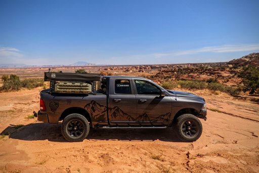

The ball is in motion and the next generation of our setup is underway. We recently did a walkaround of the Ram, in it's current state, on our YouTube channel and the main reason I wanted to do that was to document the current setup before the revamp. So I guess this will be more of a rebuild thread. Here's the starting point.
What won't be changing just yet goes a little like this -
* 2014 Ram 1500 Sport Quad Cab w/6'4" bed, 5.7L Hemi, 8 speed transmission and 3.92 gears
* 4" ProComp lift
* Icon 1.5" dual rate rear springs
* Hellwig rear sway bar
* ProComp AT Sport tires - 35x12.5-18
* 18x9 Dick Cepek wheels
* White Knuckle Off Road rock sliders
* Chassis Unlimited Octane winch bumper
* Smittybilt X20 12K winch
* Three pairs of KC Highlights pod lights in the bumper - white spot, white flood and amber spot
* A pair of MaxTrax recovery boards,
* The infamously deadly Hi-Lift Jack
* Shorty shovel from Home Depot
* Fiskar Axe
The following will be finding adventures with some other explorers
