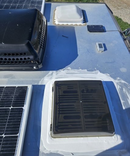

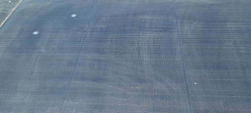

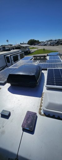

The last few weeks my solar setup has been producing less (of the 1200wh i have its been getting around 300 max), so I went out today to clean the panels, thinking that dirt and grime may be the cause of this. While up there cleaning there are very large white dots and separation from solar cells and the clear coating on the top. I noticed this on all 8 of my flexible panels which explains the issue (picture attached from one of the panels). The markings to look like impact marks, but seem to line up very well with the cells on the panel and when running my fingers across them there it is still smooth and doesn't have the feel of anything cracking. This leads me to believe that its not and impact related issue. I have previously commented on how much I love the flexible panels, but now have to retract that. I have 4 Alrska 150w panels and 4 panels, think are Renogy 100w, that came on my Black Series caravan, which both in a years time have developed this problem. The diminished returns started with the Alrska panels only a few months in, which I thought was just an issue with the wire distance and them being dirty all the time, along with it being the winter time, it made sense to me. With that being said I am transitioning the 4 panels on the Black Series to hard panels, which are on the way. I will update the thread with pictures when they get here. and trying to work with Alrska, since they are still under warranty, to replace them with hard panel so I don't run into the problem again. Hopefully they are willing to replace the 4x 150w panels with the same cost of hard panels, If this is the case I should be able to do 6 panels on the truck.

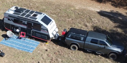

Little update since its been a while. Never heard back from the solar panels, so just got some put up and getting 2 more to put on the trailer this month, and 2 more next month to cap out the charge controller.

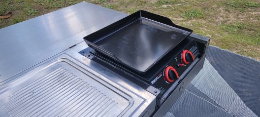

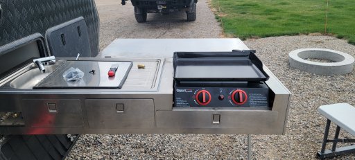

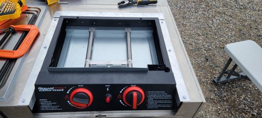

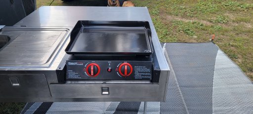

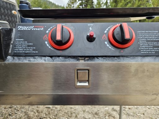

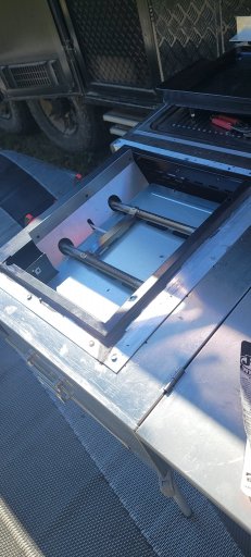

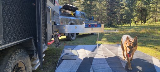

I have also been working on modifying the outdoor kitchen slideout. The 2 burner range was not working very well, it was a pain to light and would often go out with a low breeze. I decided a flat top griddle would be a much better route to go, and so far its working great. The install is mostly dont, just have to finish filling out the front end so that it looks like a more seemless install. Gunna get the fill in painted up blackt o match the rest of the frame boarder, then silicon around the outside and it should be done. Was happy I was able to keep the drawer in under the burner, I thought it was going to have to go.

Getting ready to hopefully head out on the road in December. Have gotten just about everything done that I need to. Solar panels are up (1.4KwH between truck and HQ19), got the outdoor kitchen done the way I want it and the starlink Is mounted much better. Got one of my roof vents swapped out to help with heat in the summer and it can vent while closed which is awesome (have to clean up the sealant a bit, it looks messy). The bumper now has 3 anderson ports, the new addition runs into the cab of the truck and powers the 12v freezer from the HQ19.

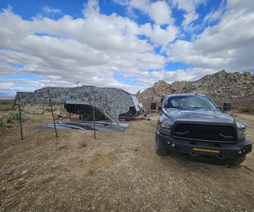

This morning got to work. My awning broke a few months ago due to a freak wind gust and blew it over the top of the RV. Got around to attaching some camo netting and having a nice giant shaded area. Also had to clean the Air filter for yhe truck cause it was really gross and the truck keot reminding me to clean it the last 90 miles of my trip.

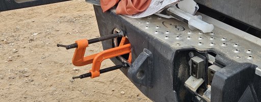

So the issue was not the air filter.... The link in the airbox came detached due to the clip holding it on broke. After some research I found that I could just remove the door, which has fixed the problem.

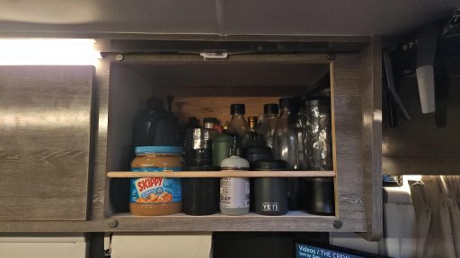

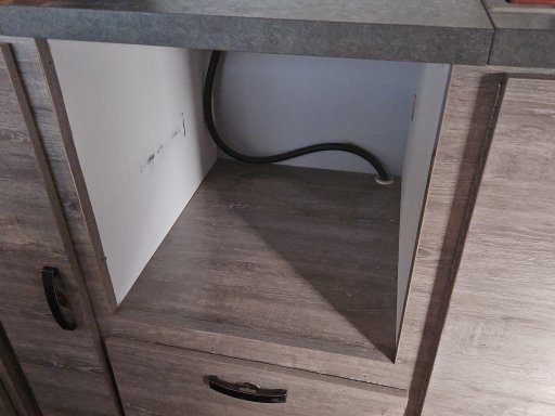

I forgot to mention in my previous post that I removed the microwave to add more storage. The second win is that microwaves generally bring unhealthy food, so it will (hopefully) force me to maintain a healthier diet. It added a ton of storage and its open which I think is nice. Nothing has bounced out in the first 400 miles so it should be pretty good.

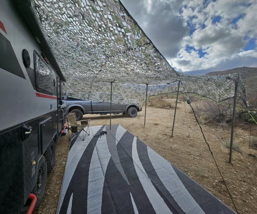

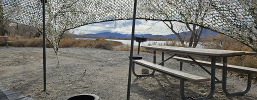

Got quite a bit done with the trailer as well. Been working on the "awning" which is just camo netting. Some of the mounts came off so I have to replace them with some better mounts om the trailer. I still have to take off the old awning that is broken, which I'll likely get done next week as ill be visiting people. I finally finished the shelves for above the door.

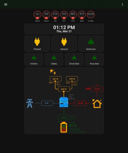

I also got the trailer setup on Home Assistant. I had one attempt at it while I was in OK, but it fried the raspi over night. I got a new one, with some better components and running off an NVMe SSD which is running far better. There is a very good integration with the Victron system, starlink, the magic home light toggles, mokpeka sensors, ruubi tags and some Tuya relays I am using for the water pumps, and soon the heater pads. Im going to wait on the pads until later in the year sine they wont be needed again for a few months. I have not yet messed with automation, but just habing all of my switches, panels and sensors in one place makes life super easy.

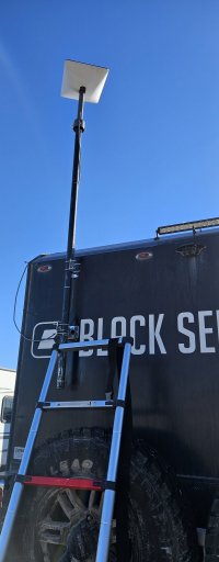

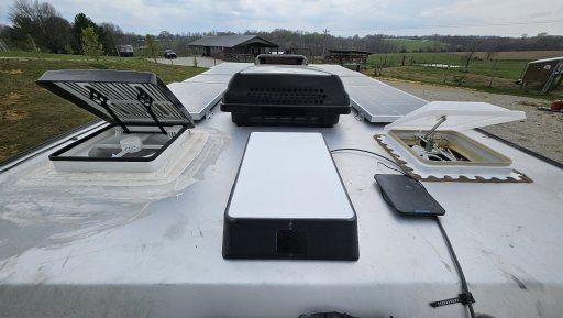

Finally got the Starlink permanently mounted. I used the Everlanders 3D printed model. Found someone on Etsy that was selling them since i domt have a 3D printer. Cost me about $110, I went with the better more weather resistant material. Cutting through and doing everything was super easy, and you dont have to cut down to the circuit board, keeping it weatherproof underneath. I have it "mostly mounted," just waiting for epoxy to dry between the roof and aluminum tabs to test the bond.
I was also able to get a poe injector and the connector swap for the starlink cable to standard rj45 connection. Made it super easy to put it on my 12v system and I did not have to cut any cables. If I need to reset the system for any reason, I can easily plug it back to the Starlink router.
Its going to be nice to not have to setup/stow/disconnect Starlink every time I move, and Starlink should work in motion now, but havent had a chance to test this just yet.

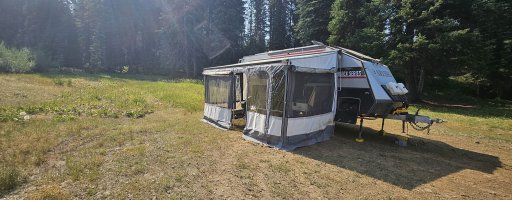

From there is was a trip to Expo PNW. Had a good time there, and was able to get a new awning since my old one broke. Was easy to get it mounted, just waiting to get the extension panel for the anex room this coming week.
After Expo I wemt north in Oregon and found a great place to hand out for a bit. Lots of nice trees, enough shade (esspecially now that the awning works) and a nice breeze going through almost all the time. not much traffic has come through here which I really like, it was silent on 4th of July, Just the sounds of the birds and wind which has been very relaxing. Next is a stop back in the Boise area, to get some stuff done and ready to continue on.

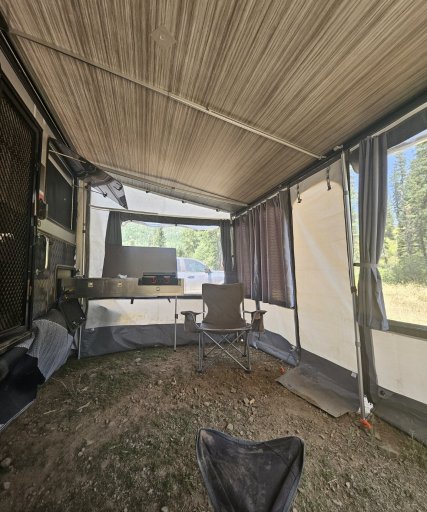

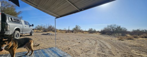

I have gotten quite a few projects done, including the awning with the full annex room from Fiamma. A few more projects have been completed. I turned one of the drawers next to the bed into a much larger storage compartment with a flip-up lid that has been amazing. I plan on getting the other side done as well, just waiting as I want to extend that side all the way to the galley area to make it larger and have more storage space.

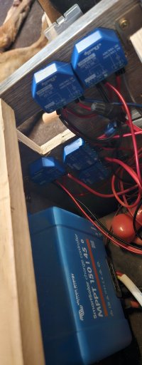

I did some electrical upgrades as well, installing many Shelly switches to integrate into the Home Assistant. They have been working amazing and im slowly working to get all of my electrical 12v on them.

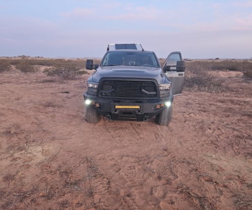

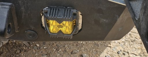

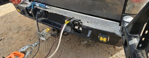

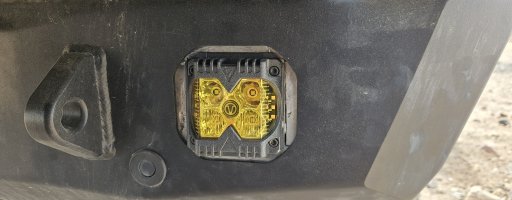

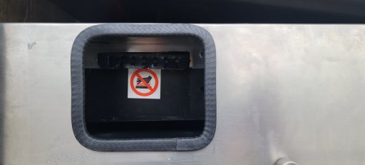

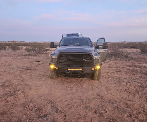

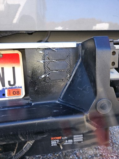

I also got the front and rear spot/strobes put in. the front was some easy cutting in the bumper. The rear required me to put in an aluminum backer, some jb weld to hold it in place, then bondo in the lights themselves. I painted them black to fit and it has given them a good flush/integrated look in the bumper.

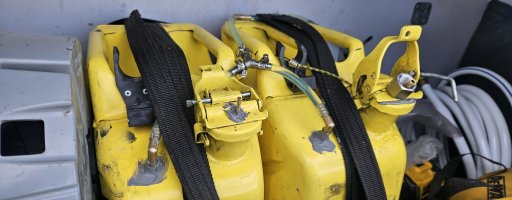

Edit: I also removed the 10l diesel tank and converted 2 5gal jerry cans into one 10gal diesel fuel tank. whish has helped a lot. Can last me 2ish weeks before having to refill it.

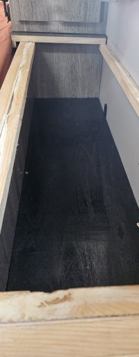

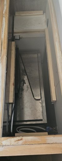

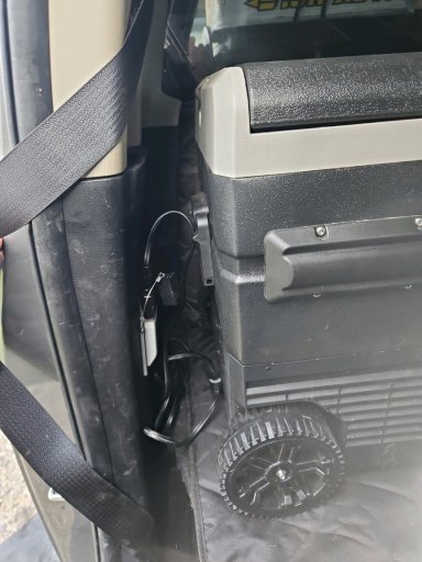

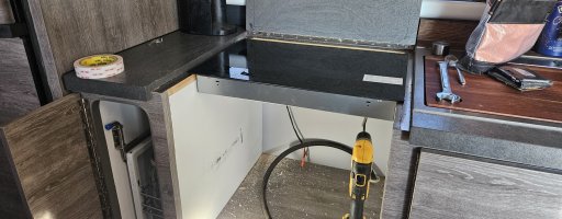

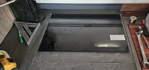

Been taking steps to remove the propane. swapped out the propane oven to an induction range. This coming week I am goijg to be installung a 12v dc fridge (maine propane consumer) not worried about power as spring/summer is on the way and Ill have plenty of sunbattery coming in. I am planning one changing to a 24v system. The efficiency is a little better, and can use smaller wire gauge for the inverter, and future 24v air conditioner plans. Will have about double the battery bank in the same space.
