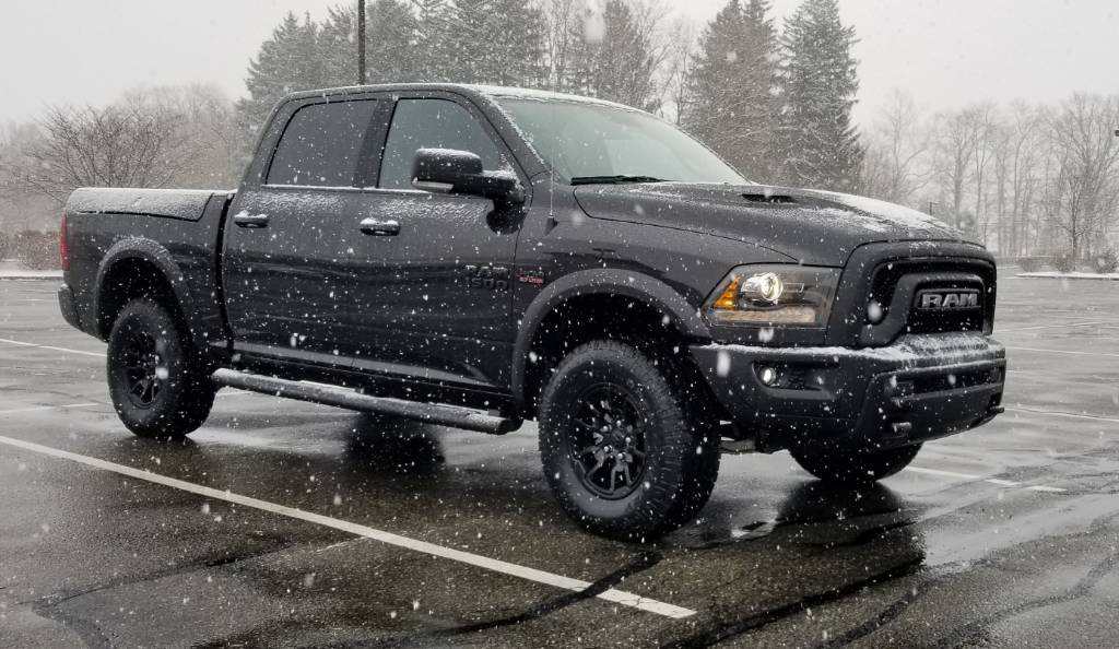

I'm new to these forums, and have been slowly making my way through countless threads, and I have to say that I think this has been the best of all. Your truck looks fantastic, and I'm doubly impressed at all the work you've done yourself. I just picked up a 2018 Rebel not two weeks ago, and I've been obsessing over what mods I'd like to start with as I test the waters of overlanding in NJ.
One of the first things that struck me with your build was air suspension (OEM, I assume?). So many guys who have it equipped on their trucks from the factory resign themselves at some point to remove it so they can install an aftermarket kit that isn't compatible with the air bags. Since I have a brand new Rebel with air ride, I feel compelled to keep it... so I was happy to see that you incorporated it into for your ultimate build. I was thinking of getting the BDS 4" lift that's compatible with air ride - have you considered that kit?
Another thing I noticed was that you started with the bed rack at a height about level with the top of the cab, but then lowered it down a ways. Since I'm not handy enough to make my own like you did, I was looking at Nut House racks, since they have a design that accommodates Ramboxes, and they offer them in cab height, as well as lower - like where yours ended up. What made you settle on the lower height?
So many other great ideas in this thread to contemplate... please keep the updates coming!

Regarding aftermarket lift options for air ride equipped Rams...I spoke with someone at AEV yesterday and got some good intel...
Apparently they're only weeks away from releasing their 1500 4" DualSport SC suspension for air ride equipped vehicles. So soon we'll have an alternative to the BDS system... From what I understand, AEV took a little different approach than BDS, with light aluminum steering knuckles, and longer control arms to split the difference between more ground clearance for the diffs and retaining factory-like ride quality. Always good to have options!
Based on your experience, how much lower than the height of the cab do you think is ideal for rack height?
My Rebel came with the black tubular side steps... I know they're not rock sliders, but I was hoping to get away with them for the time being, and if they start to get banged up, then maybe switch to something stronger. Does that sound reasonable, or am I asking for trouble?
