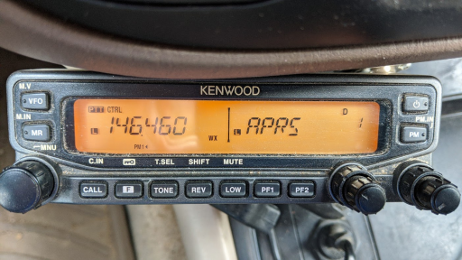

Absolutely. The 71A is a true dual-band radio. I operate APRS via the TNC hooked to the data port and have it programmed for band "B". You can see the D on the right hand side of the radio indicated it is the data band. I use band "A" for all of my voice. Both work simultaneously and I have never had any interference from one band or the other during use.

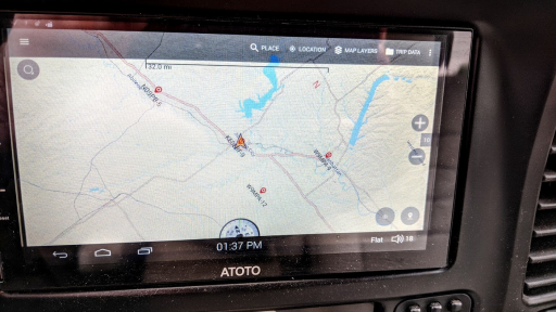

EDIT: I utilize Backcounty Navigator's APRSDroid integration when out. It works like the native APRSDroid map, but is integrated with my preferred navigation app that I already have offline maps for. This is a screenshot of BCN running APRSDroid on my way back to work:

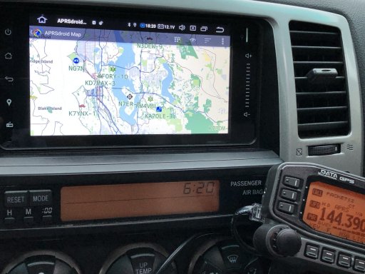

Just for kicks, I installed APRSdroid on my Android head unit and connected the programming cable between one of the USB ports on the head unit and the serial connector on the back of the TM-D710GA head. No bluetooth, no extra parts needed. Here's how I set it up: ge0rg/aprsdroid
As with much of my experiments I only did this once or twice, not sure if I would run this way unless I'm near buddies who also run APRS.
I have been looking at upgrading the head unit in the Jeep and I like the setup you have here. I will definitely look into going this route when I get it all set up. Thanks for the info.
