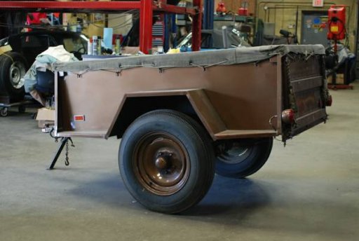

So...this is my future overland trailer. I need to ditch the 6x16" 4 ply BF Goodrich Silvertown agriculture tires, for modern tires.
Problem is, the existing rims are very narrow, so I'll need to get wheels with a high (-) Negative offset in order be able to clear everything. Thinking steel wheels, with a -35mm offset. Bolt pattern appears to be a 5x5 1/2.
Anything I'm missing?

Good looking trailer. Is it a straight axle or can you flip it for more height and not need the offset?

Hmm...I understand flipping the axle for more height...but the offset is to keep the inside of the tire from hitting the trailer frame. The trailer sits pretty high, but yeah, solid axle.
Is that what you're getting at?

Yeah that's what I was thinking. Could always do spacers too but I could see the offset reasoning. I'll have to cross that bridge at some point too.

5x5 1/2" bolt pattern is all Jeep CJs from 1942-1986 and also older Ford so you should be able to find any wheel you need.

I just ordered (3) Pro Comps Rock Crawler Xtreme Series 51 Black Steel wheels. Got all 3 for $142.00 w/Free Shipping. Pretty no-brainer purchase at that price. I've gone with a -19mm offset that should fit on the trailer nicely.
Needed to get rid of the tractor tires & rims before I could really start even using the trailer.

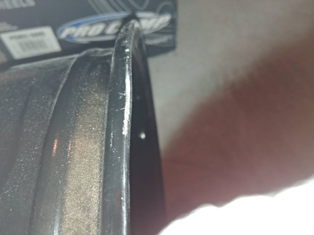

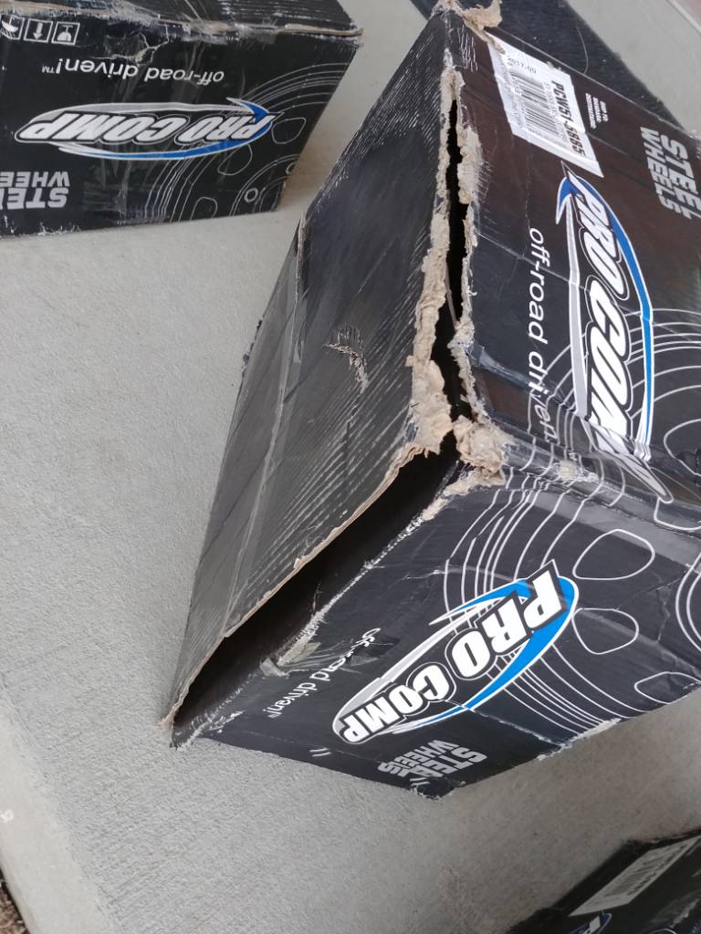

Updating an old thread, but, I've had to return two sets (6 total rims) do to each one being dropped/damaged during shipping. The blame rests solely on UPS...the place I've purchased them from has been excellent in their customer service.
Pretty frustrated. I might be better just going to the salvage yard and picking up a set of steelies or whatever they have that fits.

Order from summit racing, free shipping and I have never had a problem with items arriving damaged.

Thanks, I'll take a look at those. I ordered from 4WheelParts and they've been good on the Customer Service side. UPS just keeps dropping the rims and they arrive jacked up.
