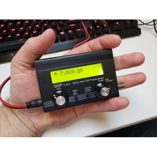

My local radio club is looking at purchasing the QRP Labs QCX Mini 5w Transciever for 40m CW operations. If we can get 6 more people interested in buying the kit, we can get a small discount on it. The kit goes for $55.00 normally. If 10 people are interested we can get a 10% discount, and if we can get 20+ we can get a 15% discount. Hans, the developer has been super helpful in working with me this far, and I’m offering up the opportunity for savings on to you.
I am wanting to put the order in on the first week of March.

@brien can you give some information about the QCX 5w radio? Since the QCX Mini is the same radio just the size of a pack of smokes.
The options @Ubiety is mentioning is the GPS module and the case which are around $30 a piece. But again if we can get 10 each of the optional accessories or more we can also get a discount on the accessories as well.
Be reminded this is a kit. Soldering is required. A Technician License is required to use the radio, and it does not have voice modes. It’s a single band CW (Morse Code) transceiver with the ability to use WSPR beacon mode.

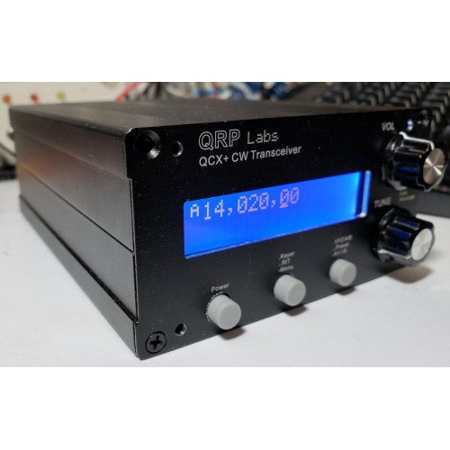

I have a QCX plus. Honestly for the cost of the thing you wont find a better radio. Mine as measured puts out 6watts on 40 while consuming half an amp at 12volts. It also has a practice mode and decoder which is extremely nice. One thing to note though, when using WASPR mode this thing gets hot. I am planning on installing a small 12volt fan in my enclosure to help out with this.

I don’t think there is room in the mini’s case for a fan. But you weren’t the first one to mention this problem with the QCX + or Mini... a guy that I watched build one used thermal paste and a heat sink for a Raspberry Pi to help with the heat.

Yeah the QCX has lots of room in the case, so much that you can actually install the 50W amp in the same case...
That is the big one... the mini is the size of a pack of smokes and fills the case completely.

Yeah I know the difference between the 2 QCX units. I meant my previous comment as an illustration of how much bigger the QCX+ is than the mini. I suppose I could have been clearer on that eh.
