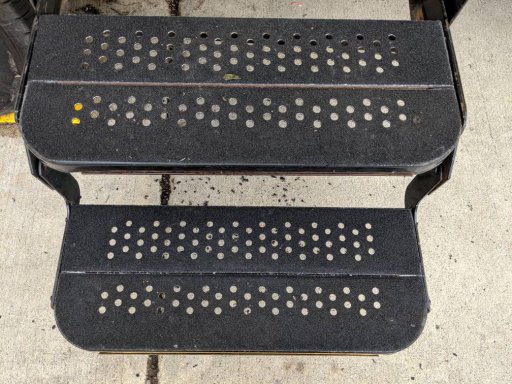

Next up was to replace the grip tape that was placed on the steps from factory. While not only wore out from years of use ( well sitting really lol) they are also very small and not really to our liking. So to Amazon it was. Got a roll of safety grip tape and did the whole top of the steps this time instead of just the tiny one inch strip that was there.

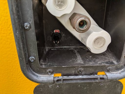

Once done with that the next on the to do list was to add a water pump switch. The water pump on these has a switch inside but is only active when the galley is in the up position meaning if the trailer is closed there is no way to have the pump on. Now normally that would be fine but since we have the outdoor shower/hose on our trailer we have found a few times we have wanted to use it. So I wired up a switch to the outside shower port and now we can use it when trailer is closed. IMG_20190510_102239.jpeg
