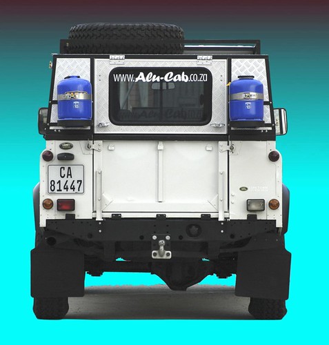

That must be why they're always mounted to the front. But I kinda like the look of the two smaller cans on the back. Or maybe a skinny can horizontal on the roof?
Horizontal propane tanks are pretty big money for the tank and would eliminate any cost savings that it brings. A cheaper $200 tank would be about 75 of the little 1 pound guys.
