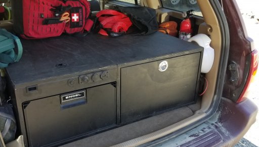

On our Grand Cherokee we use a slide in box with one large drawer and an Engel 30qt drawer fridge (currently the drawer holds tools and recovery, working on building a rear seat delete with storage and moving those there, then the drawer becomes food/kitchen storage. The box uses stock anchor points in the Jeep to secure it. When we go on more than a day trip we put two totes on top of the box with camping gear etc. This Jeep is Michelle's daily driver so we keep it light and clutter free most of the time, I am planning on pulling the spare tire and put it on a swing out carrier, then I can use the space where it was for an ARB compressor, DCDC charger and a house battery, last thing I want to do is pull the fridge/drawer cabinet and all the related stuff out to change a tire on the side of the freeway
