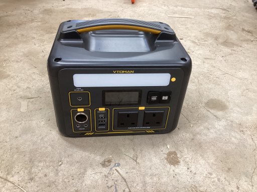

jump 600 to power the fridge

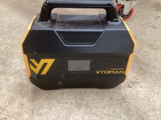

flashspeed 300 to go in kitchen to charge phones and other smaller jobs

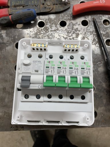

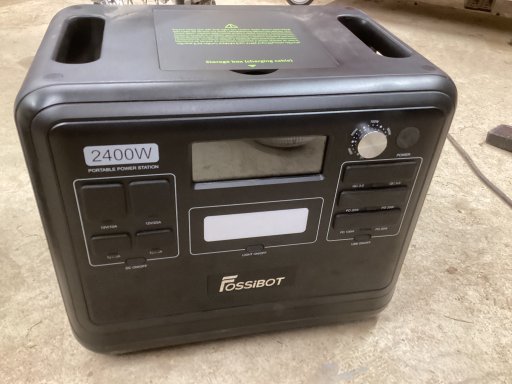

fossibot2400 for running the fuse panel of the trailer and supplying 230 v

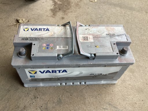

agm for supplying the fuse panel when the fossibot isnt

That’s what I thought- another reason for getting the vtoman jump 600 was the jump start function- I have used it on a dead flat battery and it works well- you need a jump lead that plugs into the socket on the front
