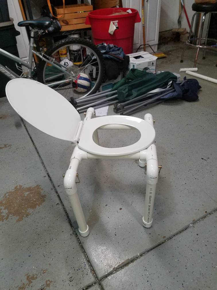

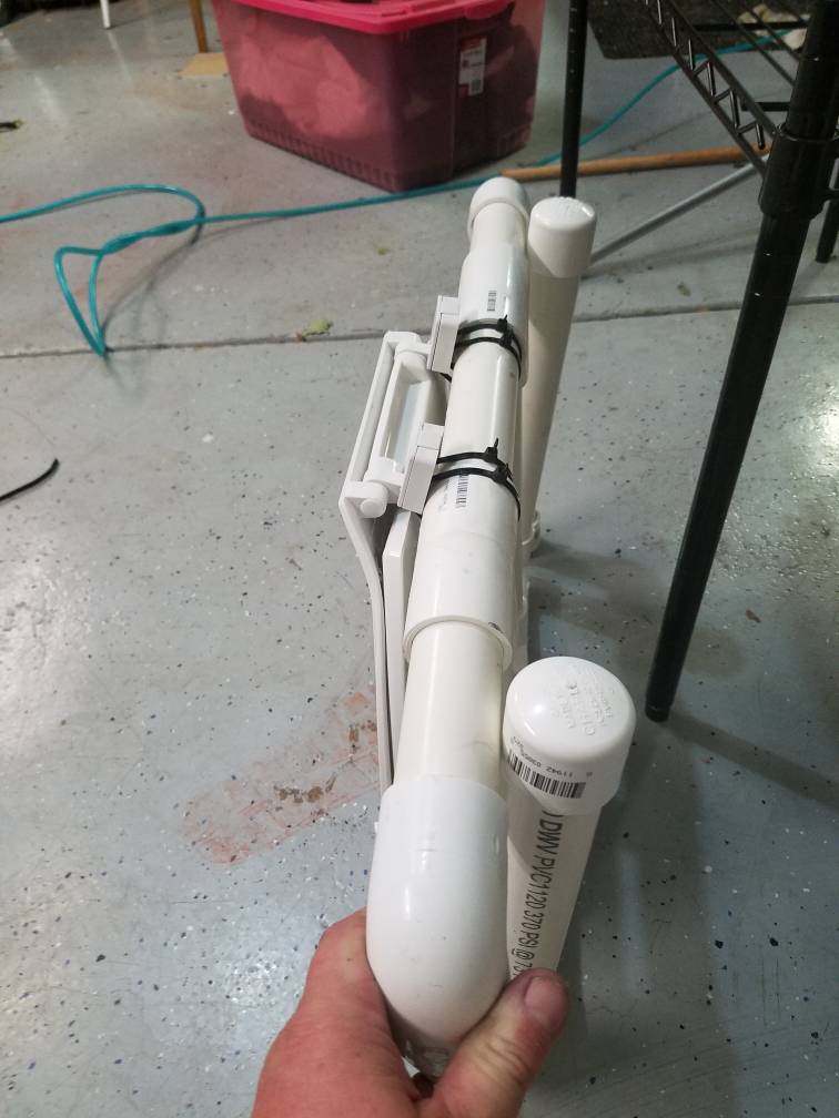

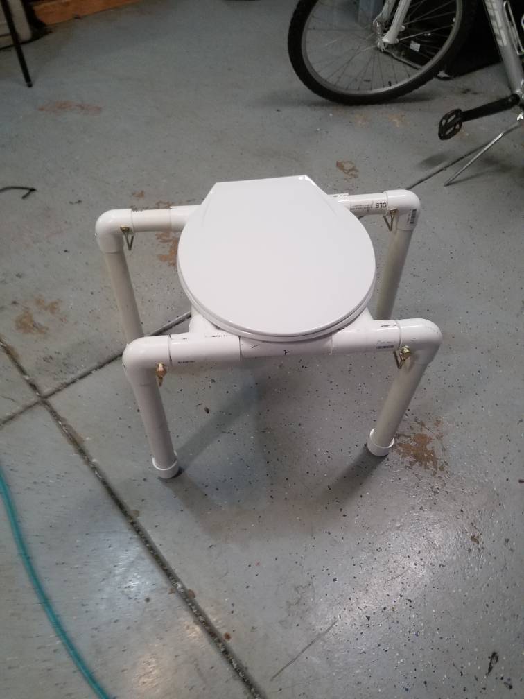

So, my daughter is coming with me for the first time, she is 11 and in our trip planning the thought of her bathroom breaks came to mind. So looked at some of the options, and almost settled on the luggable loo, 5 gallon bucket system. But thinking the bucket was going to take up alot of valuable room. So my making so pvc bottle rocket launchers for the 4th of July the idea hit me. Browsed the web and saw some ideas to work with. So decided to mess around with some pvc. This is my 3rd version. The first 2 used the luggable loo bucket toliet seat, and that is not friendly for men while doing #2 it felt like. So decided to up the pvc to 1 1/4 and use a real plastic seat for .pre comfort. It sits about the height of a 5 gallon bucket and uses the pins to keep the legs from collapsing at a bad time. I will just add a bag underneath with kitty litter in it. And we should be good to go. Will be trail tested in about 2 weeks.
