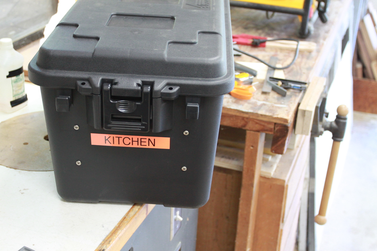

Ultimately I decided to try out a Plano 1719 storage trunk since it meets the portability and cost criteria, and they can be made reasonably weatherproof by adding a bulb seal. One downside is that there is no internal organization to make it easy to get to your gear. I solved this by building a wooden tray (similar to a toolbox) for smaller items and by moving my stove out to a separate storage bag.
Pictures of the box are below.

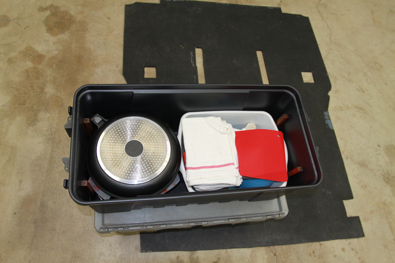

Here's the Akro-Mils box I started with. As you can see it was very densely packed, which meant that I had to unload a lot of loose items to get the stove out. This is a pain when camping, especially if you don't have a clean surface to set everything on.

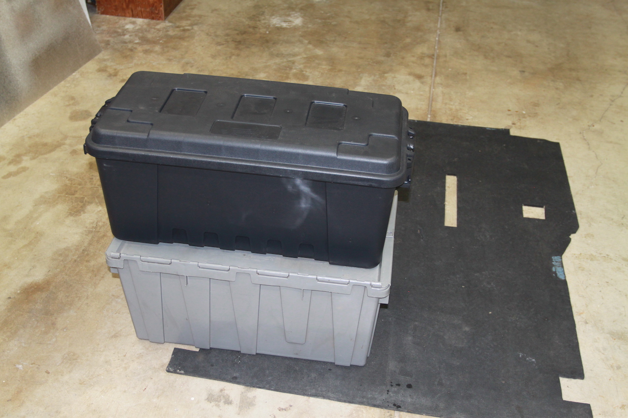

The Plano 1719 is about the same height, a few inches longer, and a few inches narrower.

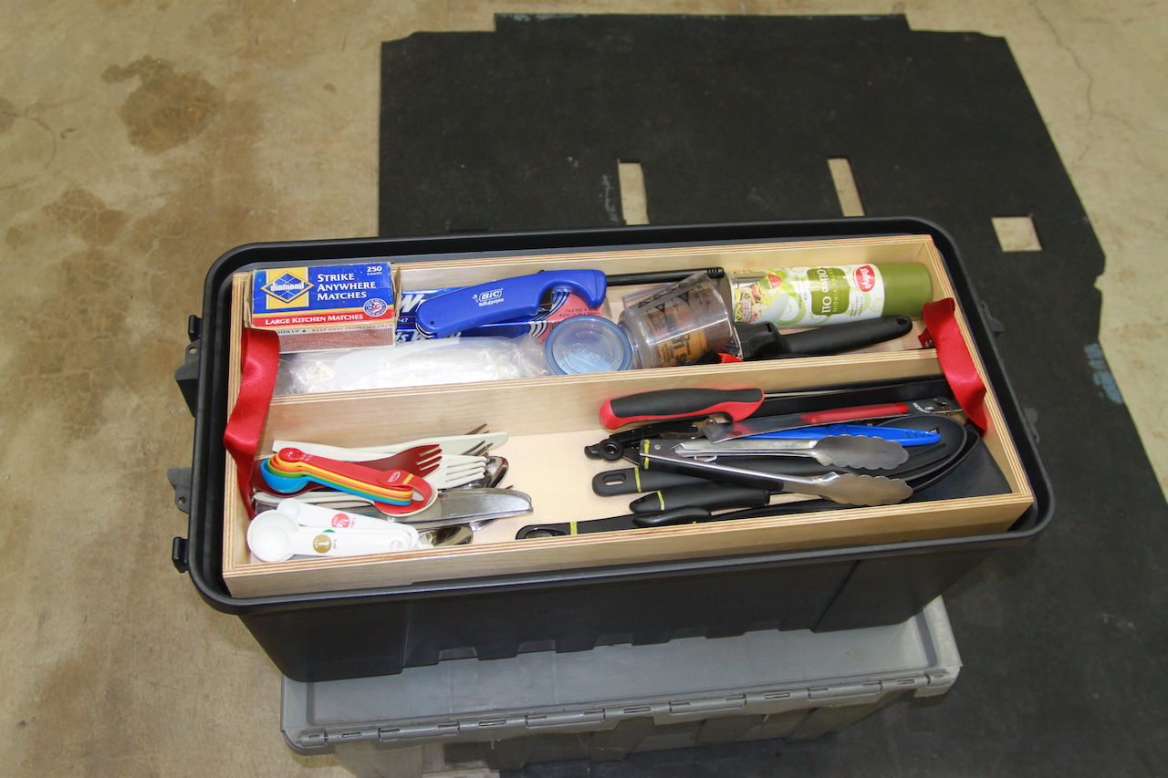

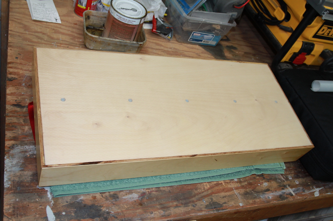

These wooden brackets support the tray.

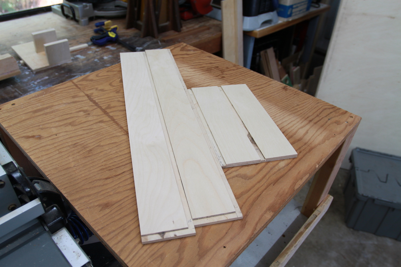

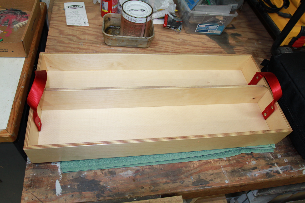

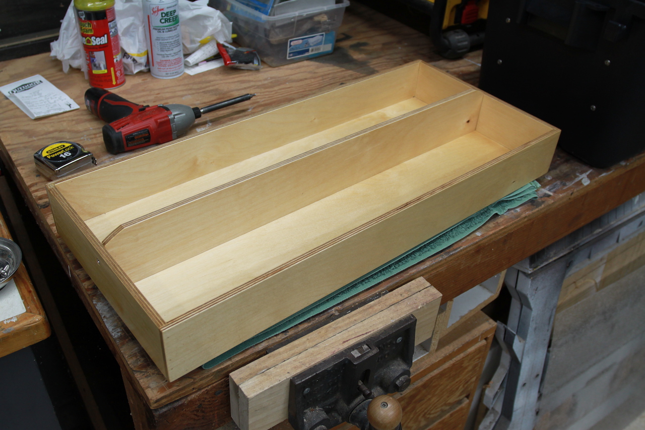

The tray is made out of 3/8" Russian birch and held together using dado joints, glue, and pin nails. I was going to use finger joints, but they are a pain to cut in plywood and I didn't need the extra strength. In retrospect I could probably have used 1/4" Russian birch and saved a little weight, but the tray is pretty light as it is.
After assembly I finished the tray with pure shellac which is a common food-safe film finish and is water resistant.
The two handles are made of climbing webbing and the bottom is covered with food-safe shelf liner.
The center divider is held in place with screws and no glue in case I want to reposition it. And the entire bottom is covered with shelf liner to protect from damage from items rubbing against it.
The tray holds smaller items such as cutlery, measuring cups, tin foil, and cooking implements. I later added a divider on the bottom section to separate the eating utensils from the cooking utensils.

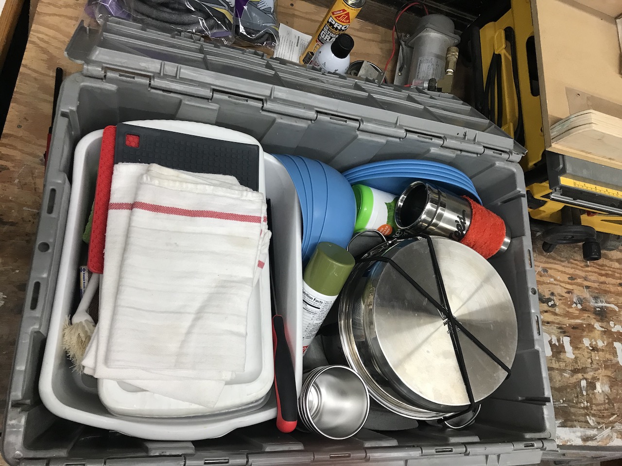

With the tray lifted out you can access the nesting pots and a wash tub which hold plates and cutting boards.

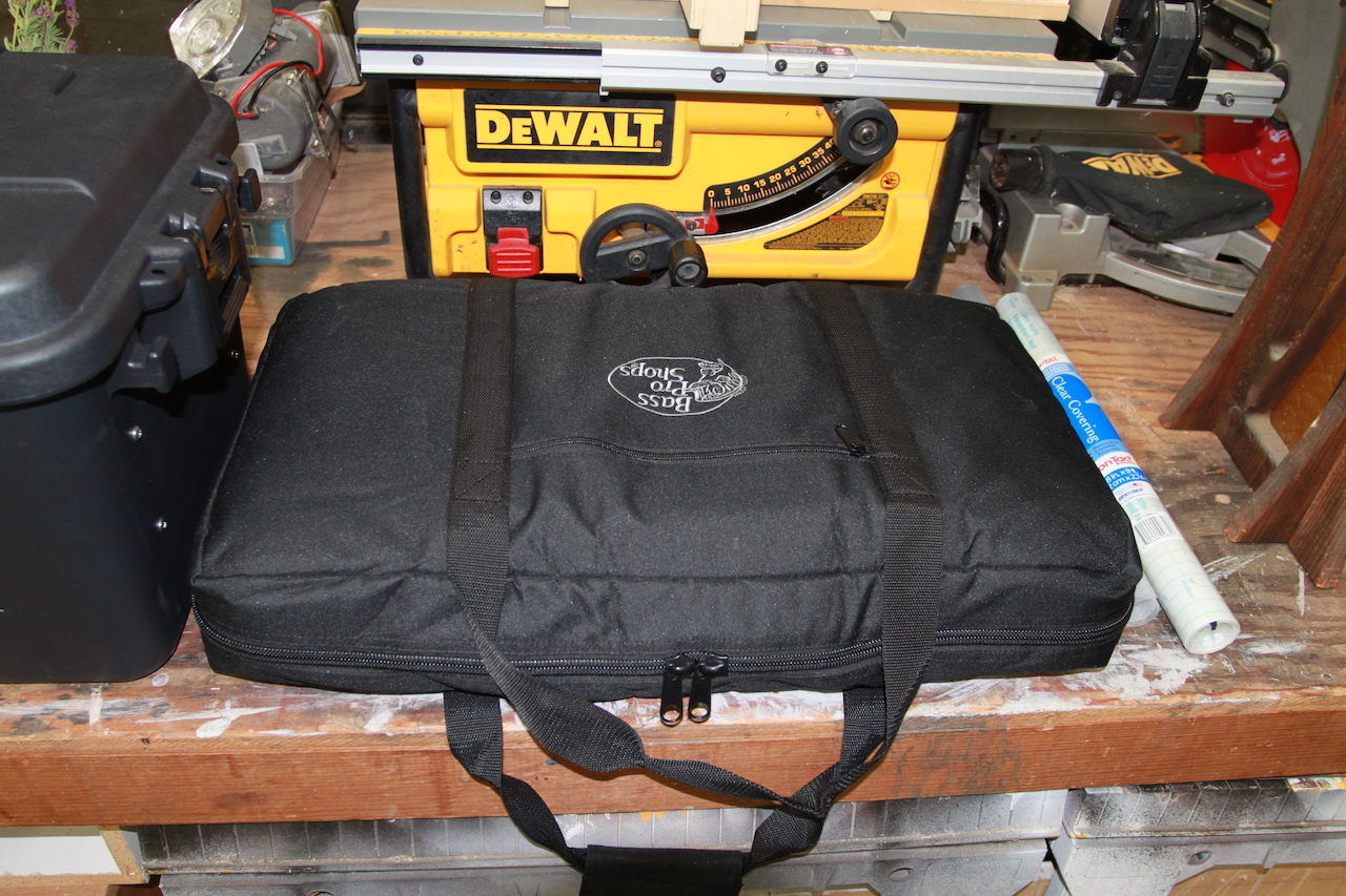

The stove is now in a Bass Pro Shops bag. The overall setup is less space efficient than the Akro-Mils box, but it is much easier to get to individual pieces of gear.

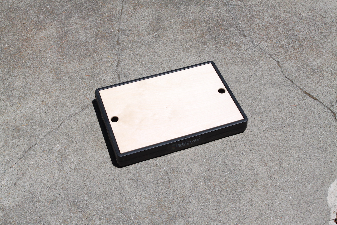

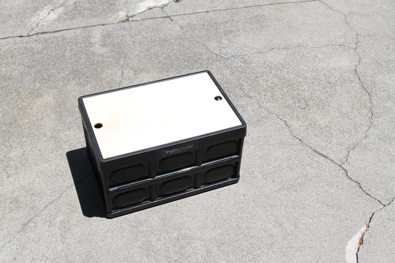

A while ago I picked up a collapsible crate that I leave in the truck. It works great for holding dry food goods when camping, but I wanted a solid surface on top to keep the food from getting crushed and to provide a flat surface to put things on, so I made a quick lid out of 3/8" baltic birch plywood leftover from the kitchen box.

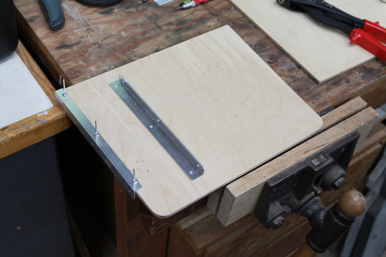

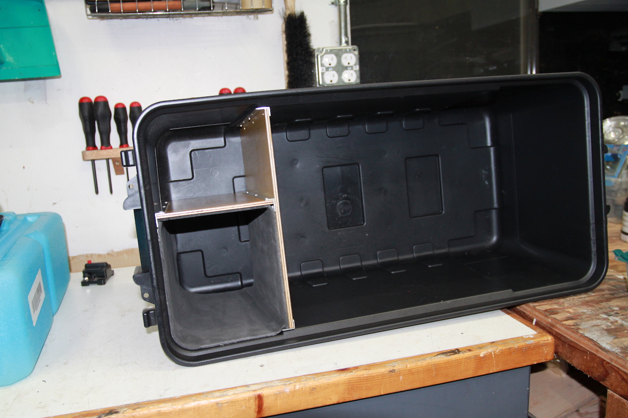

I've modified another Plano box to store my general camping gear. The idea is that the kitchen box is the "clean" gear and this other box is the "dirty" gear. This time I used 1/4" baltic birch, 1/16" aluminum, and 1/8" aluminum rivets. My main goal was to ditch my lantern case and have a padded section to carry it in.

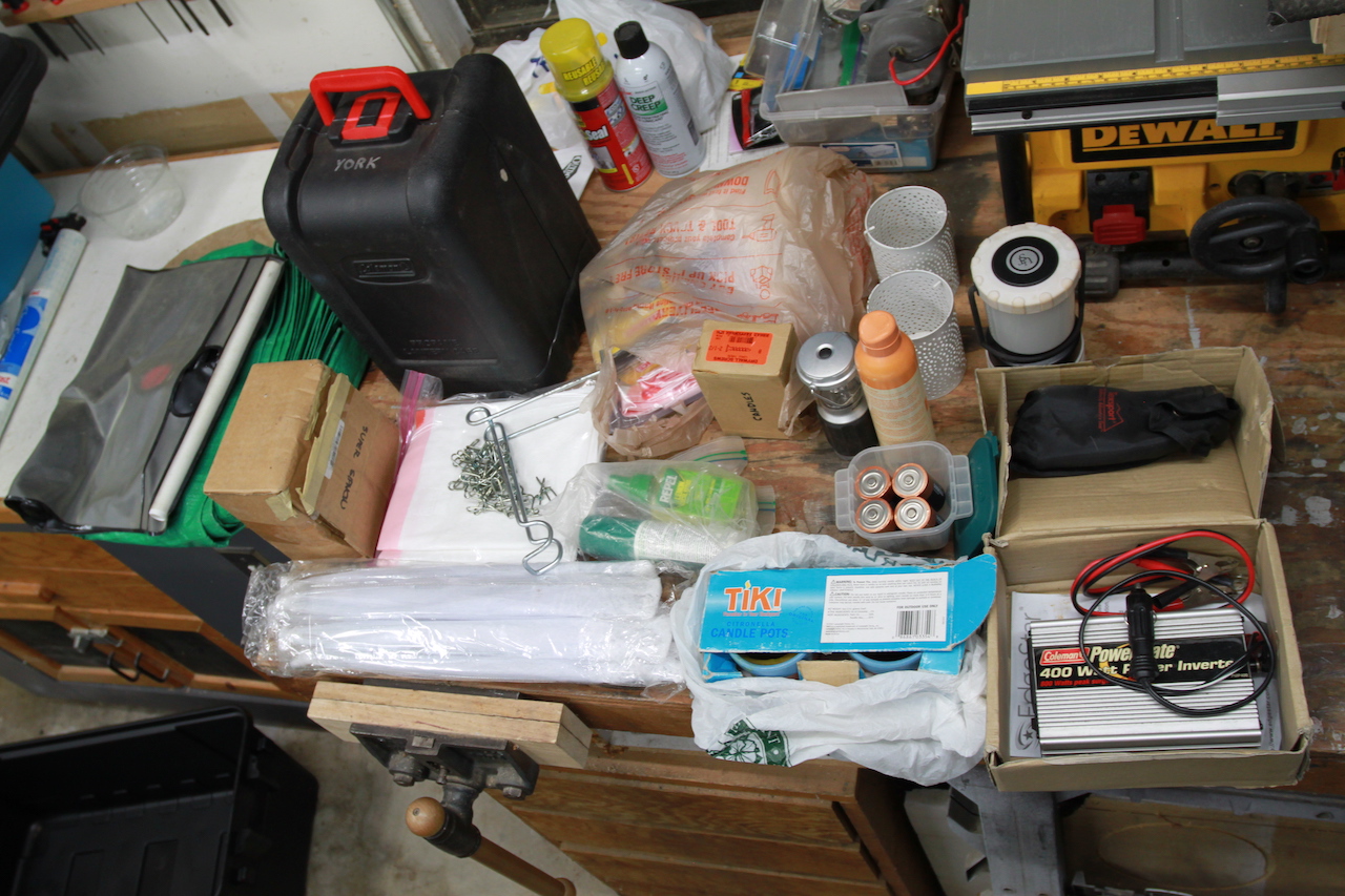

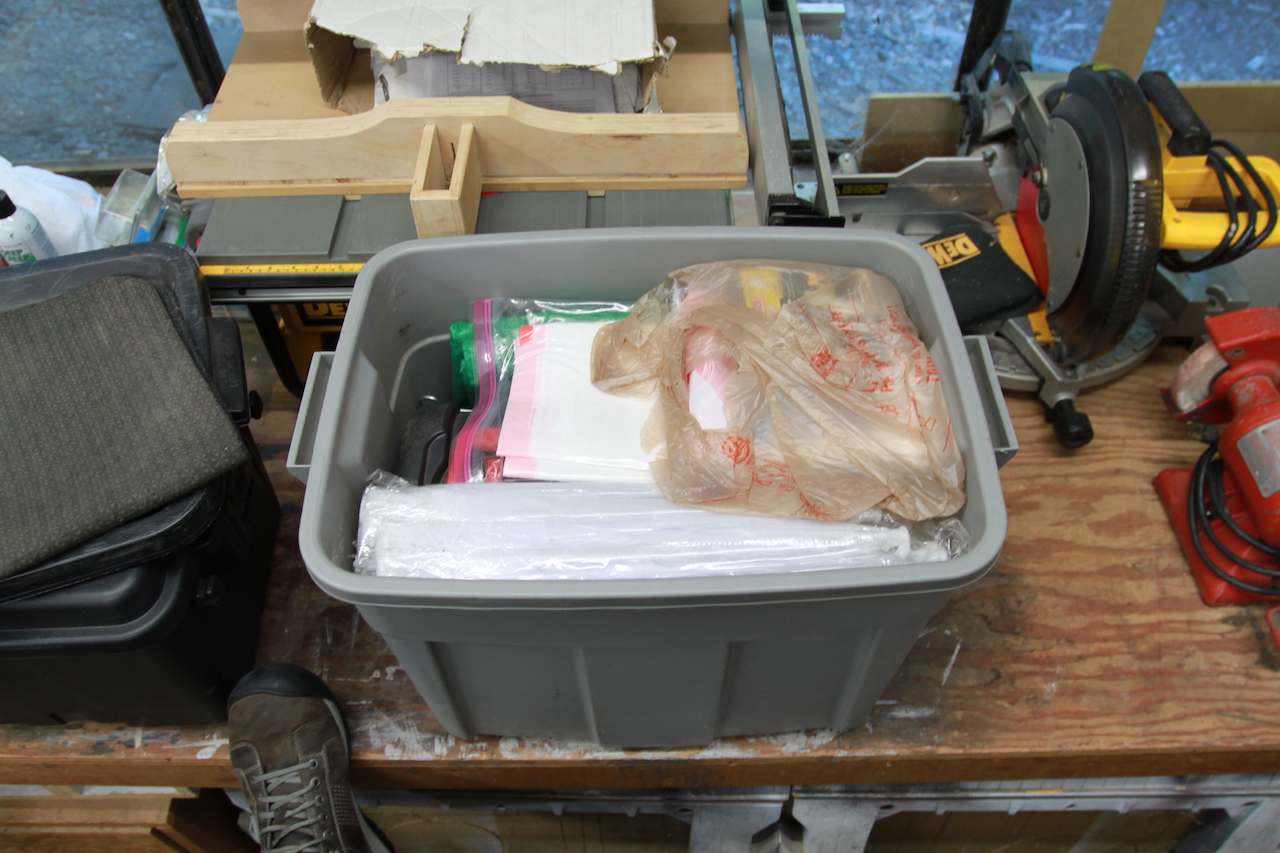

For the last 10+ years I've camped with this tub. It is deep enough that I never see the items at the bottom, and it's a pain to get things out.
This tub contains a random assortment of items such as lanterns, lantern hanger, bug spray, inverter, spare batteries, candles, tarp, solar shower, super siphon, garbage bags, and our toilet kit. We never use a few of these things so they are being retired.

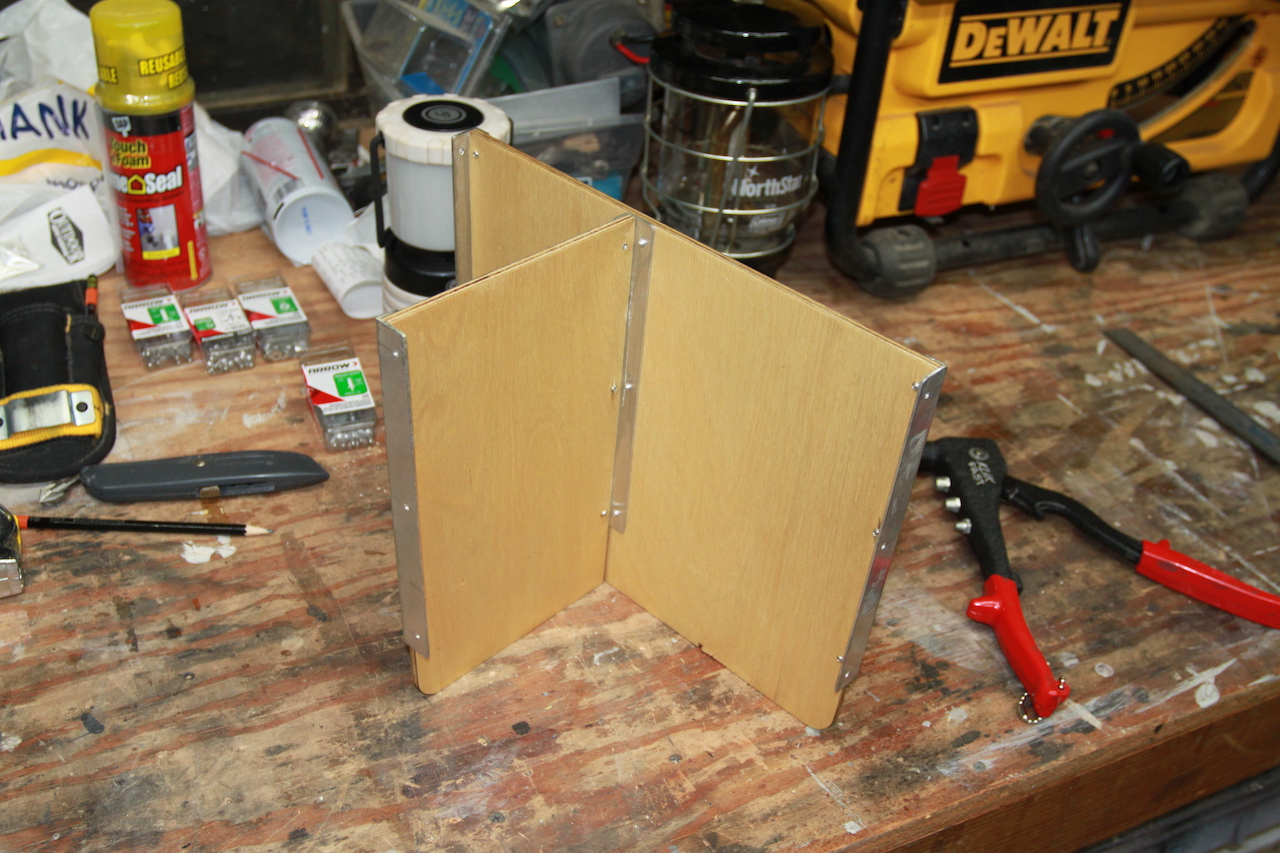

I've been wanting to try making joints out of aluminum and pop rivets, and it worked out great.
The rivet heads are partially sunk into the plywood and seem to be holding well. I sealed the wood with 2 coats of Shellac.
The divider is riveted to the Plano box and I used some leftover closed cell foam as padding.
