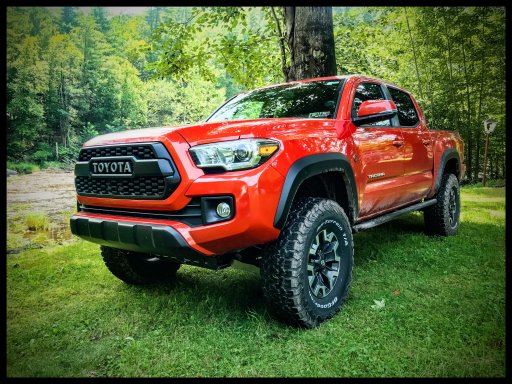

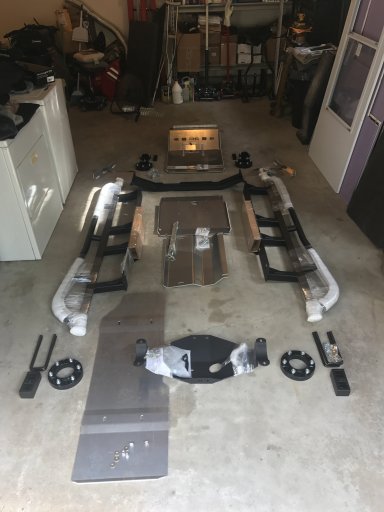

IMG_2233.JPG IMG_2141.JPG IMG_2214.JPG Phase one complete just in time. Heading out this weekend for a two week over landing trip with a good friend. We are heading out to Colorado to hit as many trails as we can ( or our wife's allow ) Phase one goals were to install protection and improve ground clearance and install new rubber.
Protection: full aluminum skids front to back From RCI and steel rock rails
Ground Clearance: installed leveling kit
Tires: BF Goodrich KO2 285-75-16 with 1 1/4" wheele spacers. Had to do the Body Mount Chop to clear the tires properly.
Phase two will begin later this year. After I return from the trip. Some big plans still to come.

HAHA! That second picture looks like one of those Video Games where you can add armor to your vehicle to go smash other players!
Good build! Have fun with it! Love the color!
