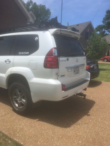

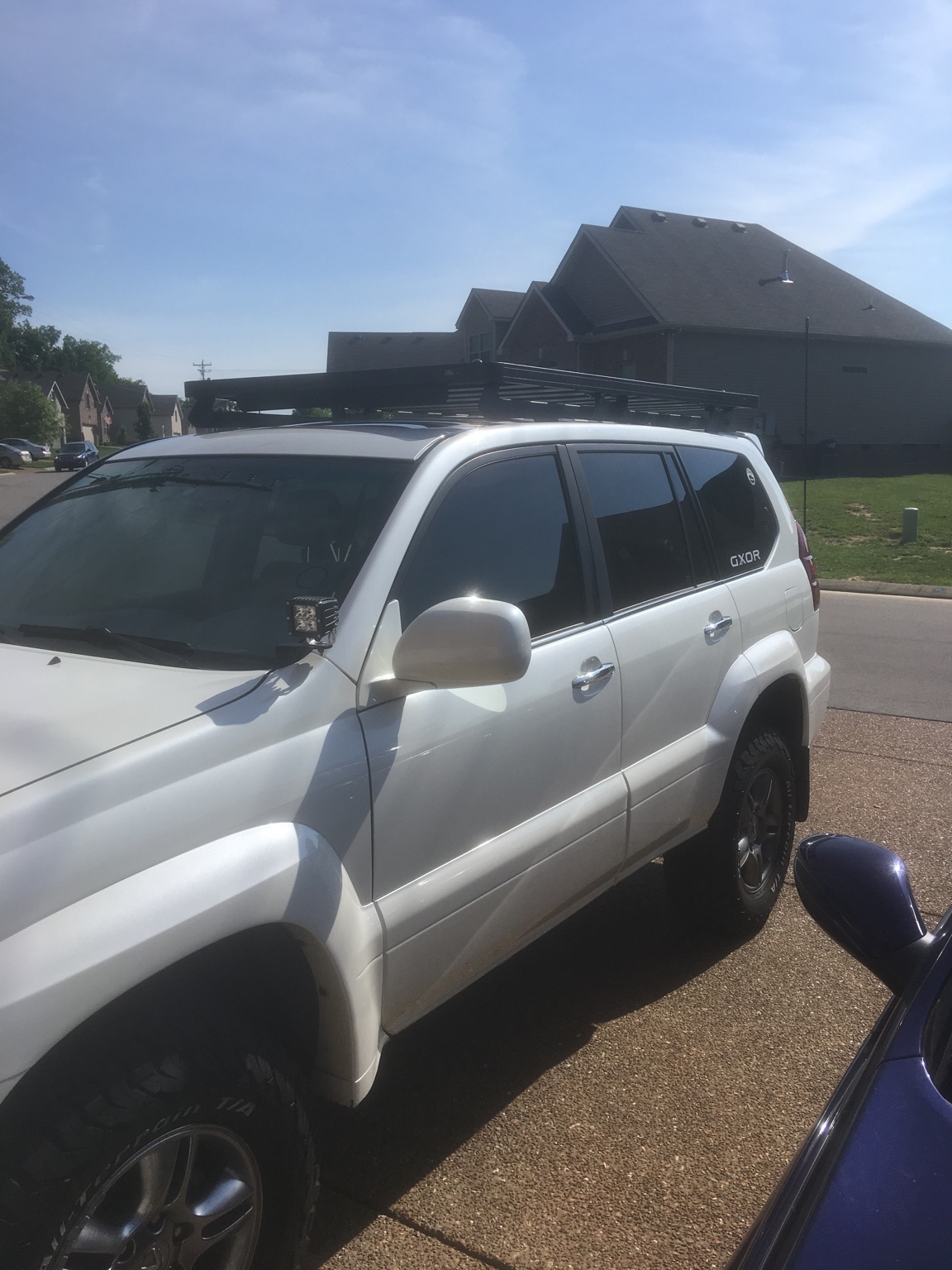

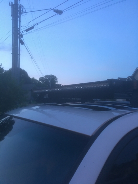

^^^ FrontRunner Slimline II rack for the 120 installed over the weekend. Have the FoxWing Awning Mounts and Hi-Lift mounts as well waiting to go on.
I didn't get everything done that I wanted to this weekend unfortunately. The rack install took much longer than expected and during the process of installing my accessory fuse panel from blue sea systems there was a small firework show that took place when I accidentally let the positive and negative battery leads graze each other. This mistake apparently blew several fuses including my (Downhill Assist Control Relay) that turns out is also my Brake Switch Relay. So I spent all weekend trying to determine why my brake lights would not go off. Problem solved though!

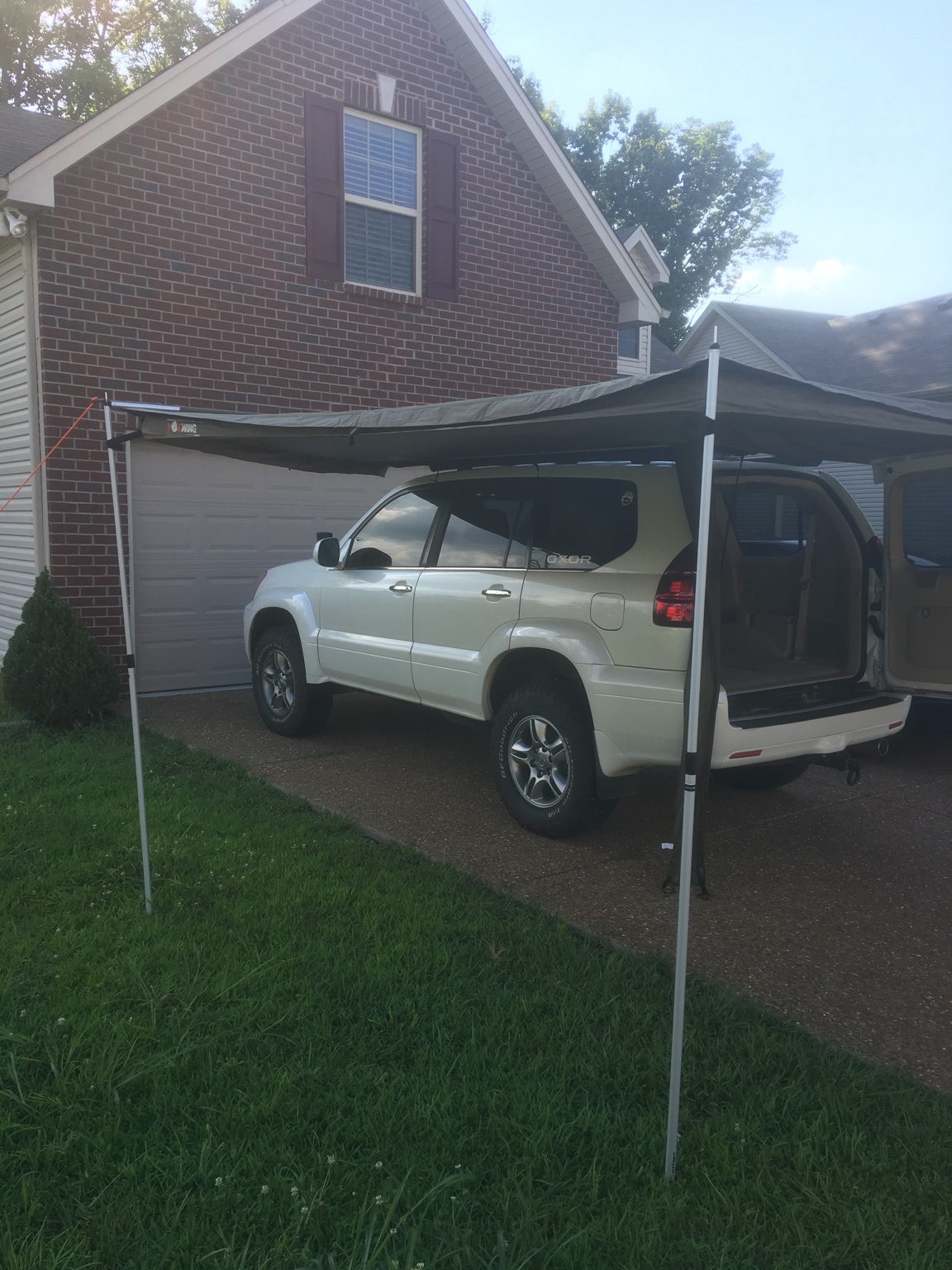

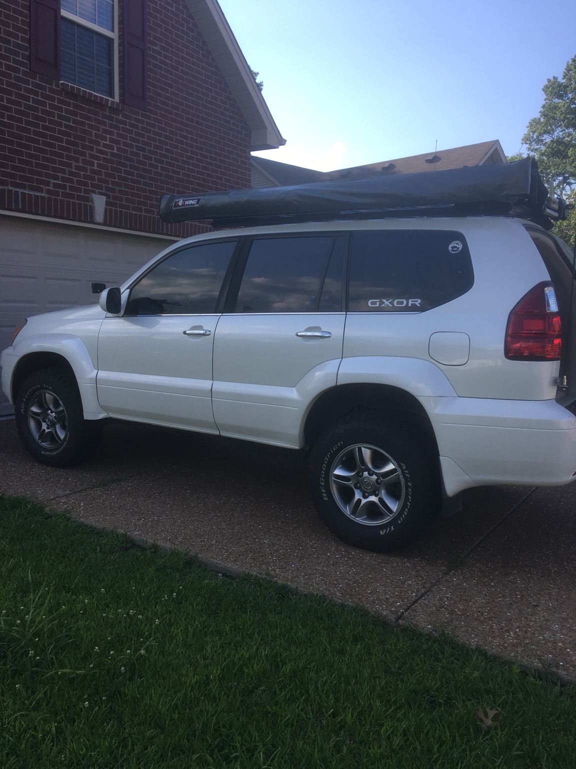

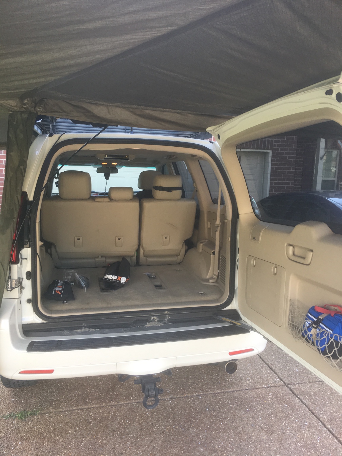

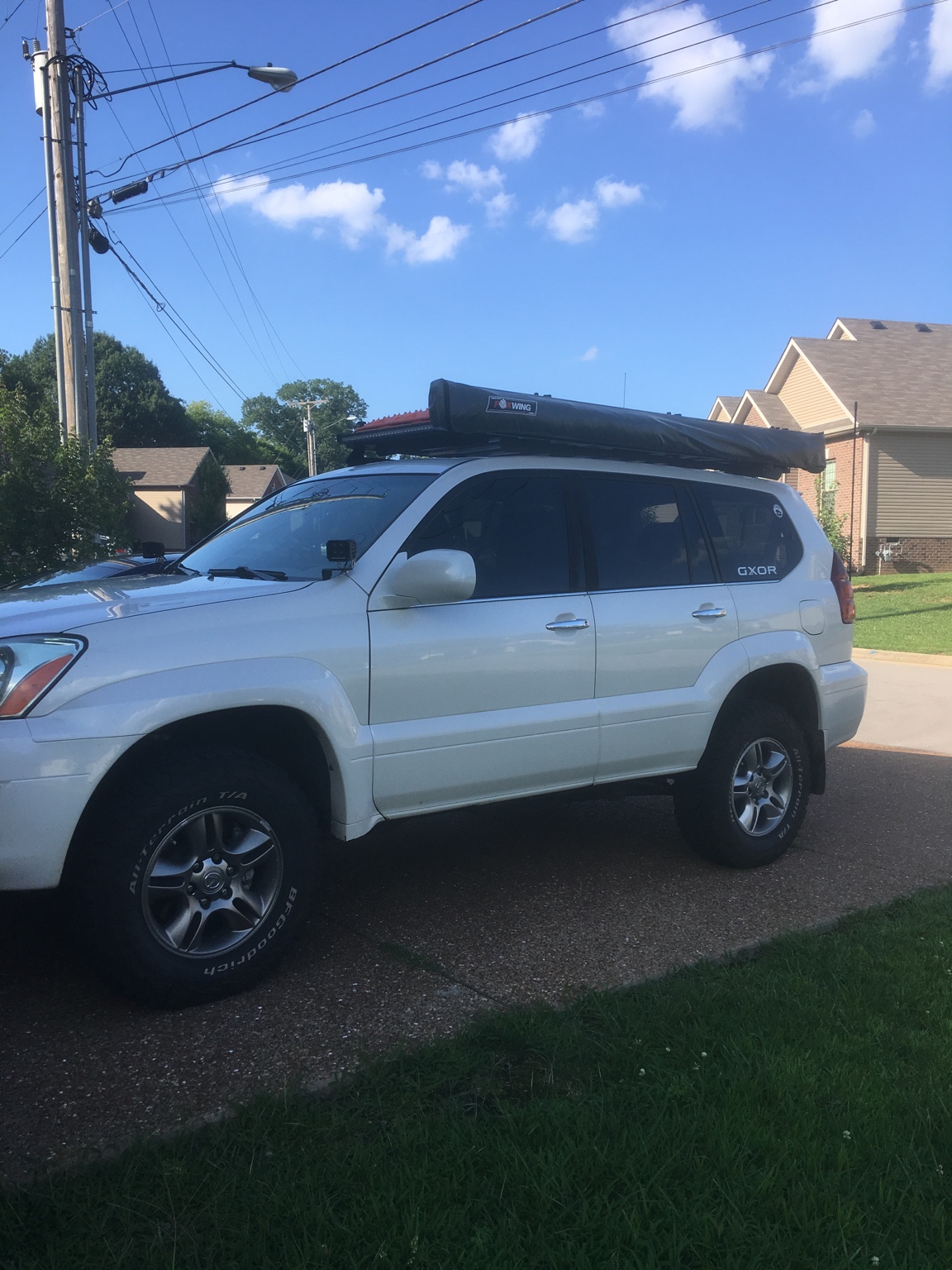

Getting excited this morning as more progress is being made! I expect my MaxTraxII's and some ARB Recovery items in the mail tommorow and then Friday will bring my new ARB 2500mm Awning and Room. I went back and forth on awning brands but in the end the available room for the ARB 2500mm is just massive. The FoxWing is a little outside of my budget however I'm hoping to fab up some type of swing mount like FrontRunner sells (for $550) that will allow the awning to swing from driver side to rear on demand.

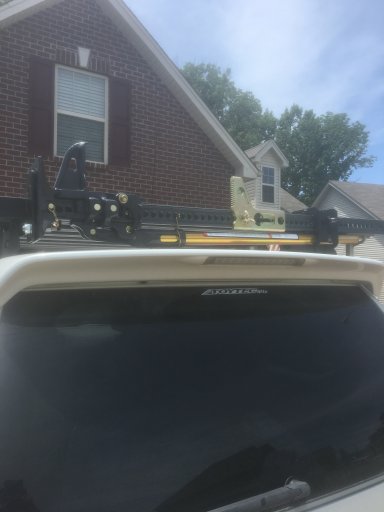

This past weekend I went for a short drive just to get off the pavement for a little while. It's tough getting out with two very young kids at the moment. I also mounted up the new 48" HiLift Xtreme Jack. Clears the rear spoiler and door perfectly.
