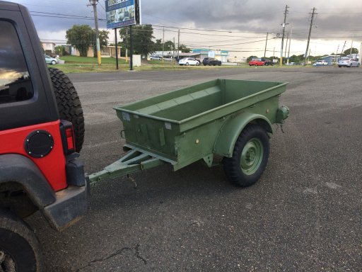

So quick question, I have several Offroading/ Overland vehicles and as of right now I'm finishing my trailer setup its a 1953 M100 trailer, but still need to change the tires... I have a 1985 Chevy K10 on 39's, a 2001 GMC Yukon on 35's and a 2014 Jeep JK on 33's.... not sure what tire size to go with for the trailer to fit them all, don't want run too big tires but surely don't wanna run em too small, What size you all think could be a good choice???
Thanks in advance

I think the trailer could care less what you have and will perform fine with just about any size. The main reason to have matching tire size on a trailer is for convenience. You are adding possible extra spares into the mix or can carry a single spare for vehicle and trailer. I say put 33's on it. Other reason is to match the vehicle height and keep the trailer close to level with a bit of tongue down force. I have different types of tires on my trailer but they are the same size. If I had to I could swap 2 tires from the trailer to my rig to even things out and get to somewhere for a proper repair.
I will be carrying an extra spare on the trailer, I was between 33's and 35's, I could go with the 33's and have some lift added to the trailer....
Thanks!

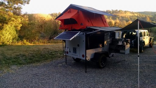

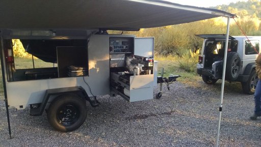

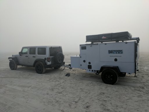

Very nice! With that front cargo deck, that has to play havoc with your tongue weight being all over the place. Are you using any sort of weight distribution hitch or sway control?
Ben Hedrick
Thank you and you'd think so but that ATV is fairly light weight unit (it's only a 250) and with the RTT on top and all the kitchen galley items out back, really it has towed very well. We been pleased with how it has pulled.

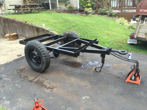

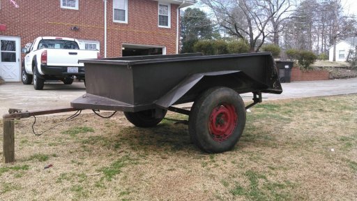

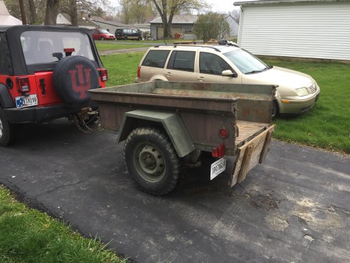

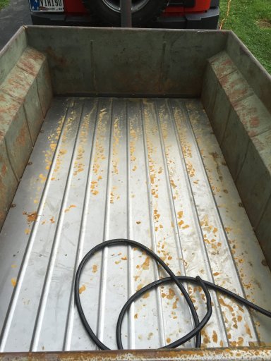

Thought you folks might enjoy watching the transformation of an old M416 Trailer
Poor old girl. I have had her for over 20 years and it was time to put some TLC into her.

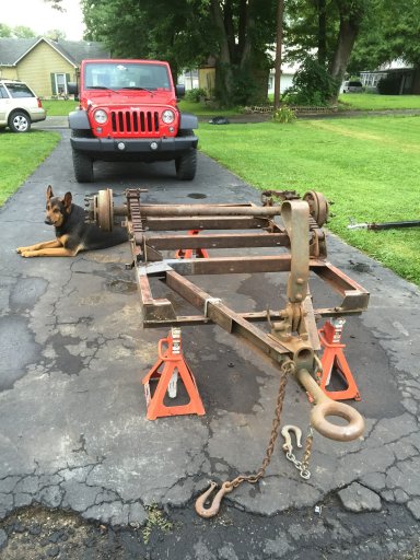

Taken apart and ready for sanding. That's Leo guarding the build. Oh, ignore my driveway, it takes a beating.

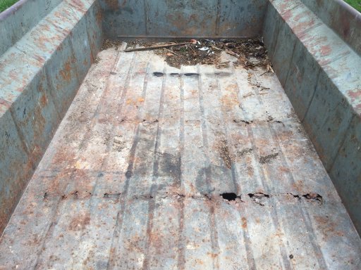

I've got to get a new bed. I hauled 2 tons of gravel in this trailer. Dad said the rule of thumb in the military was, if it fits - haul it.

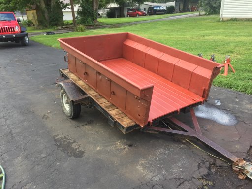

New bed welded in.
New tailgate built and ready for coating
Frame is ready. Used chassis paint from Eastwood.
Bed is ready. Used primer from Eastwood. If you havent visited Eastwood's site you really need to. Their products are top quality.

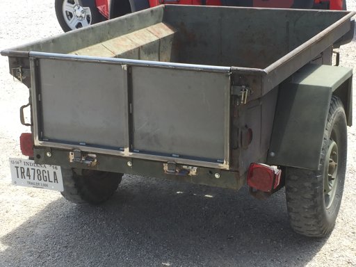

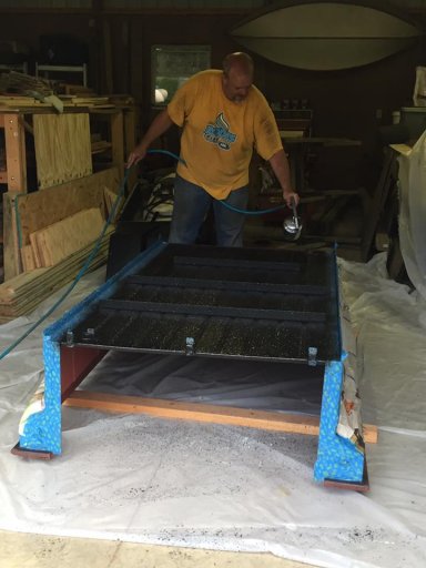

Sprayed entire bed with bed liner. Used Monstaliner, it's tintable. Easy to apply but cures FAST. Be absolutely ready to start applying the coating before mixing the catalyst.

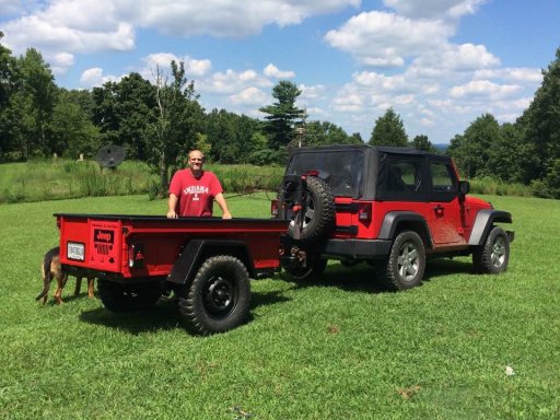

And there she is completed. Go Hoosiers!! Forgot to mention, changed the tail lights to LED with backup lights. Used an LED housing for a commercial truck to mount them with. Drilled holes into the side of the housings and placed marker lights in the holes. Welded tubes into the interior of the bed for wiring the lights. The new wiring follows the C channel of the frame all the way back. The wiring is totally protected from the trail. Changed the wiring out to a 7 wire. Have a wiring breakout box on the tongue to pull the hot circuit from to eventually power 12V devices in the trailer.
