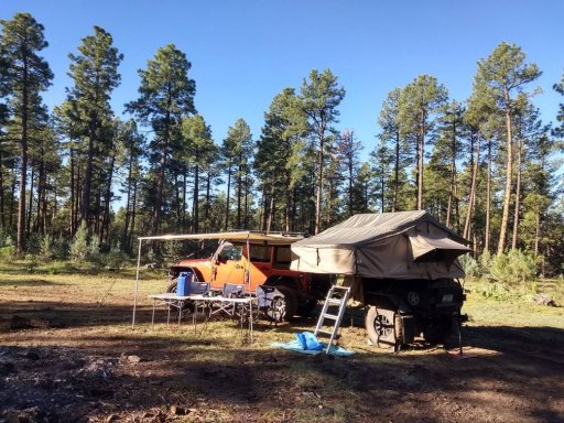

9 1\2 month build, 6 months of research
Build seen on my Facebook page Overland bound made me remove your link.
Solar: Renogy, 2 100watt portable suit case panels w\ branch connector to run both parallel or single panel, Renogy 30 amp Wanderer Charge Controller w\ Battery Temperature Sensor, 20ft 10 awg cable
Battery: VMax Tank 125ah AGM Battery
Suspension: Smooth Ride 3 leaf springs 1450lb. capacity w\ Monroe Shock & 2000lb axle
Tires & Wheels: General Grabber AT II & US Wheels 15"x 8" 4.5" on 5 lug (I media blasted & had powder coated satin black)
Tent: Smittybilt 2783 RTT w\ Exped Duo 10 Queen Size extra long extra wide self inflating mattress w\ CVT Anti Condensation Matt & Compact Camping Concept Shoe Hammock
Awning: Tuff Stuff 4x4 4.5ft x 6ft w\ Tuff Stuff 4x4 Sun Shade Wall
Paint: PPG Automotive, DP Epoxy Primer, Omni Base matched to Cerakote Coyote Tan, Concept Gloss w\flattener added.
Bedliner: Defender Pro, orange peel texture 10" up on the exterior tub, tongue box & face of fenders, heavy texture inside the bed & tailgate. (all sprayed)
Frame: modified reinforced Harbor Freight Super Duty w\custom fabricated tongue & spare tire mount. (all welded)
Body: Dinoot M Series M416 tub kit w\ CJ Jeep style tailgate w\hidden tailgate latches
Fenders: Jeep Style Aluminum length: 36" height: 18 1/4" width: 10" cut to size & scribed to fit, Defender Pro Bedliner sprayed on the faces.
Bed Floor: 3\16" Smooth Aluminum sand blasted w\ Defender Pro Bedliner sprayed inside, exterior underneath Automotive Undercoater sprayed
Tongue Box: Harbor Freight 2-3/4 cu. ft, 3 12v. outlets & 1 12v. rocker switch, Pro Defender Bebliner sprayed up 10" & painted to match trailer. Houses all electrical & solar system.
Heating: Proplex Heat Source H2000 Tent Furnace
Tent Rack: Compact Camping Concept "No Weld" Gusset's w\ 1 1\2" thick wall tubing, bolted & welded
Jacks: Pro Series Round 2000lb Pipe Mount Swivel Jack w/ Footplate side crank
Propane Bottle Mount: AT Overland Equipment 5lb Propane Cylinder Bracket painted to match the trailer.
Extra fuel Storage: fabricated plate w\ bracing for Smittybilt Jerry Can Mount & Midwest 5gal Jeep Can
Charging System: Noco Genius 10 amp Single Bank On Board Battery Charger
Tonneau Cover: Downey Products.
Don,
Doing a very similar build on the same frame. Just wanted to say thanks for the info, it is really great information! You have a great trailer. I am going a little bigger on the tires 35's, No tent but carrying a Angler 360 above the storage area. I sleep in the Jeep. Went to your Facebook but can not see the build. Can you post up how you use the Proplex heater to the tent?
