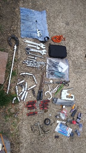

I've spent more time fixing things other than my vehicles so my tool kit is a scaled down version of what's at home. It all fits in a small tool bag
I’m curious about the staple gun.
Me too, I already lost it somewhere in the truck. Lol
It comes in handy with repairs on tarps, sheet plastic like in my fender well, stapling notes to the message board/branch, rifle targets, etc. I've also been known to bring it into the office when the standard stapler isn't strong enough. I also know someone that used it on himself after an accident to help hold things together on the trip to the hospital.

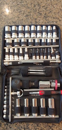

This started life as a Craftsman(early/mid 80`s) sae/metric set. I gutted the sae added more metric, drivers, extensions, etc. The thing has elastic bands in it that (most of it) lost its elasticity decades ago. The silver bars are neodymium magnets laminated between .125x.500 aluminum stock to hold everything in place. It is tailored specifically to my Jeep and 3.6l gas engine. Short of suspension work there isn't much I can't do, and it is all the size of a Bible.
I also have a zipper pouches with pliers, wire stripper/crimper, files, combination wrenches and flex head ratchet wrenches, punches as well as a 2 pound drilling hammer.
Also a Milwaukee M18 hacksawzall, blades, and an M18 1/4" impact bit driver with 1/4",3/8" square drive adaptors.
