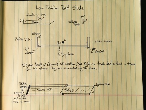

Thinking about adding a DIY bed slide. Has anyone done this with some sort of lateral bearing or sliding mechanism? I need a very low profile slide so that my cooler will fit under the tonneau. Thinking about using a T slot system to anchor the rear of the slide to the truck as it pulls out.

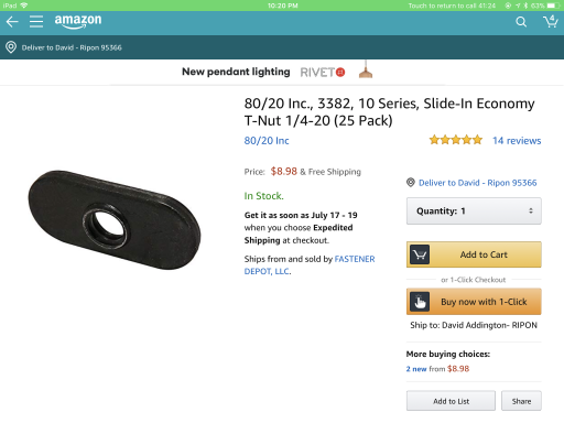

Then thought about a slide that lays on the truck bed without drawer slides, but T slots anchored to the bed and T nuts on the bed slide that keep the end of the slide from lifting up as it extends out9DB2FD53-55BD-41DA-84C8-AFFBB74A9309.png45CD89E0-A96D-407A-B1FF-3B7342684CFD.png 11F36783-5CC8-4F97-AB32-A216EA8B2A1F.jpeg
Anyone done something similar to this?

80/20 makes sliding base plates that fit into their T-slot channels. I thought about putting some channel in the bed, and then a piece that is aligned to it on the tailgate with a few-inch gap so the gate can close. Then maybe just file down the slider wear material a bit so the cooler could just slide out and onto the rail on the tailgate, across the gap. Also, get at least one slide with the brake :)
I have not tested nor proven this would work. I was just going over this very same issue on my Canyon recently, and was creating a 3D model for not just a fridge slide, but also a bed rack for my RTT :)

Check out V-Slot Linear rails ( https://openbuildspartstore.com/v-slot-linear-rail-1/ ) These are used for low cost DIY CNC Routers and mills. The 20x40 rails should be stout enough for your application.
For a lower cost, possibly lower profile option you could go with 2 V-rails ( https://openbuildspartstore.com/openrail-linear-rail/ ) mounted to 3/4" ply. Then a 3/8" base for the cooler with 6-8 wheels to rid on the rails. (similar could be done with Angle Iron if you have the tools. )

That’s a very similar concept I had. It may not slide out as well as my heavy duty sliders, but it doesn’t seem as important to me that it does. I need to look again at 80/20, my issue is low profile as my cooler just barely fits now with the bed mat in. If I take that out I get 1/2” or more back

That second link does offer an interesting potential solution, thank you!

Lots of options found here: https://8020.net/catalog/category/view/s/shop/id/837/?cat=1345
Video showing a couple of ways to use their linear slides:
You could likely mount the T-Slot rail into the bed and use a slider pad on top for a very low profile. Might even be able to use one of the half-profile T-slot rails, and end up with your fridge sliding very close to the bed. All just ideas of course.
