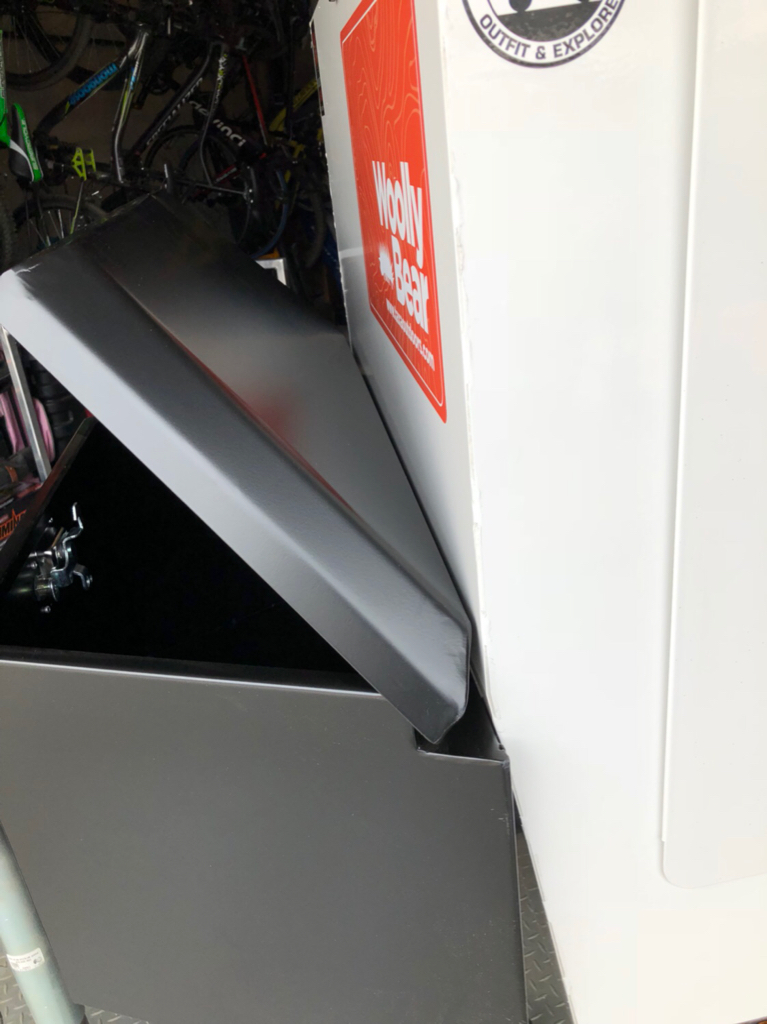

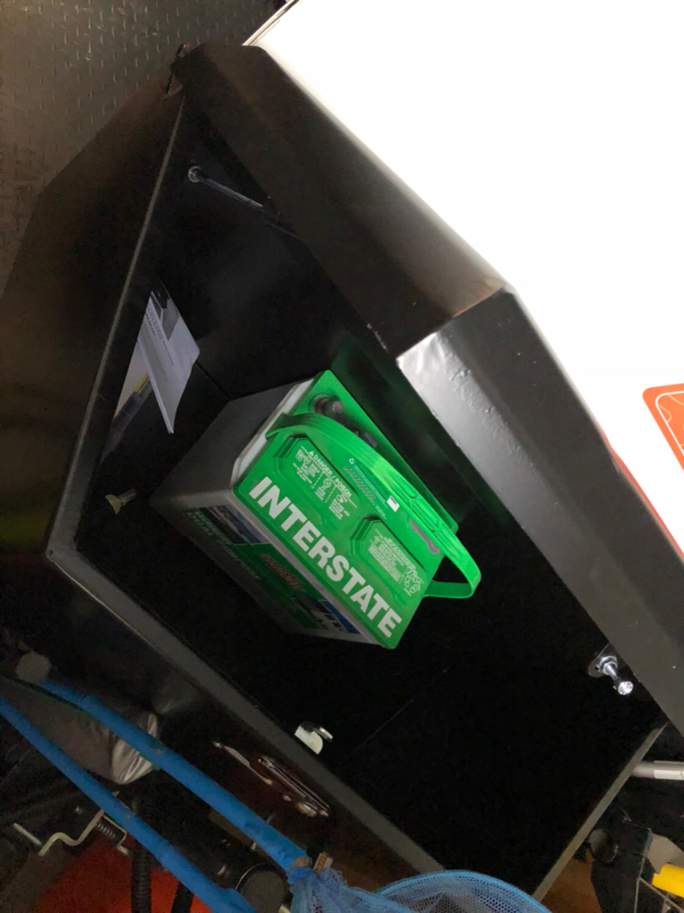

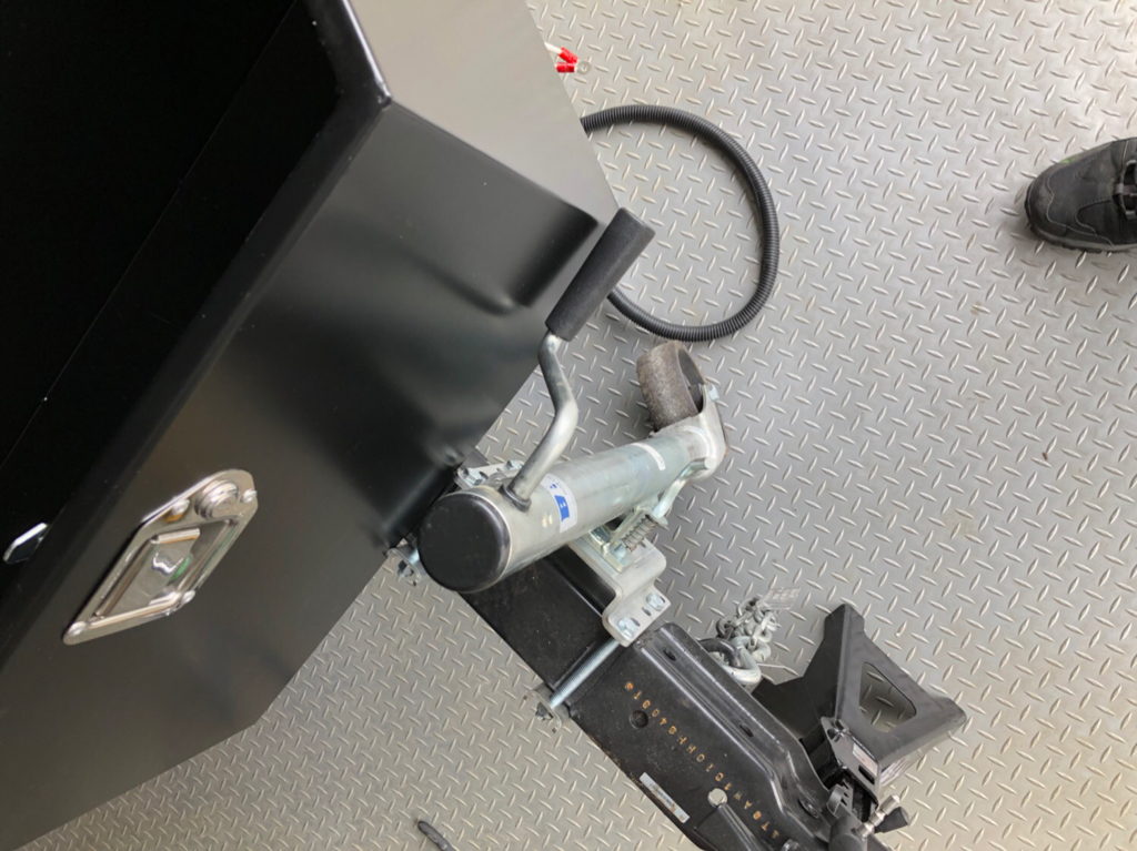

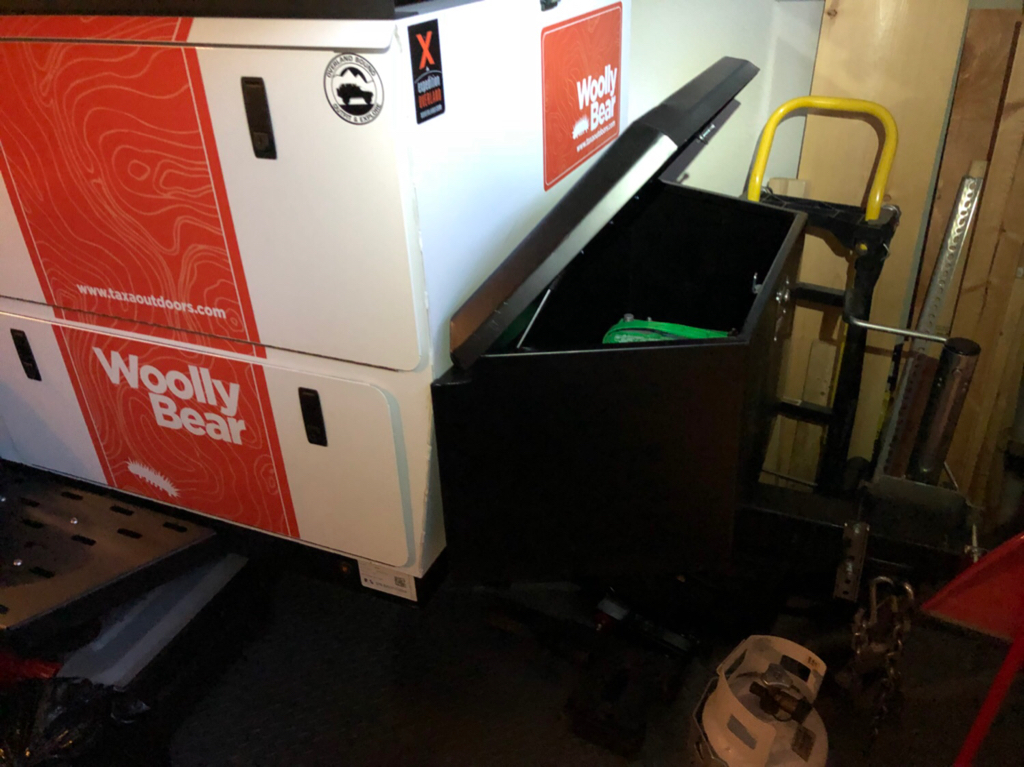

Finally got some time to see how this tongue box might work on my WoollyBear trailer from Taxa Outdoors. Had to move the tongue jack forward about 1/2” which is the most I can move it. The actual receiver hitch is unfortunately welded on (for now). Anyways, the box fits very nicely. The width is perfect. The lid opens nicely.
Now I have three things to work out:
1. How to mount it so that it is stable and rugged. There is no triangle tongue.
2. The jack handle can’t rotate to raise and lower.........that’s an issue! So I need to figure out the jack. I was thinking of changing it to one with a wider wheel that moves on soft ground without sinking so much. Now I may need to look at all of it.
3. Battery fits inside with lots of room. I picked up an inverted as well. So I need to start to plan my electrical system. I want USB and cig plug style outlets in the rtt. As well as solar charging system.
So, next weekend I’ve got lots to work on!

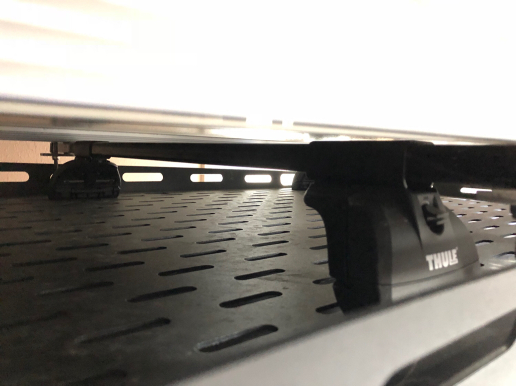

Great looking setup; really enjoyed your posts. Any chance of you posting some close-up pictures of the rack system used for the RTT? I'm looking at purchasing a wollybear myself, but there are no dealers in southern ontario -- closest dealer is in the US or Montreal so it may be a sight unseen transaction.

I will try and grab some for you, but it is under the rtt. It essentially is two Thule cross bars mounted using Thule posts bolted to the deck. I think Taxa is working on a new set up for the 2018 model that has the tent up higher on Thule racks so that an awning can be mounted. Eliminating the need for something like I built

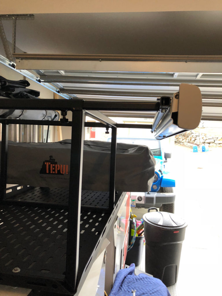

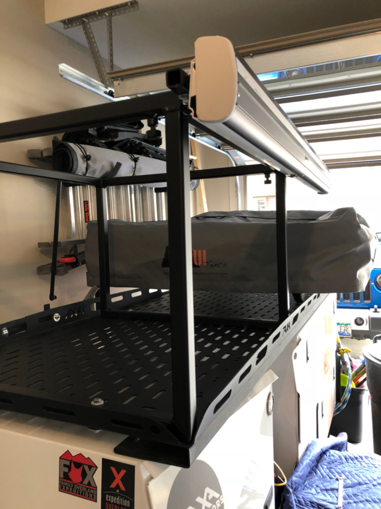

Here’s a couple of Pics if the Thule rack that the rtt is mounted on

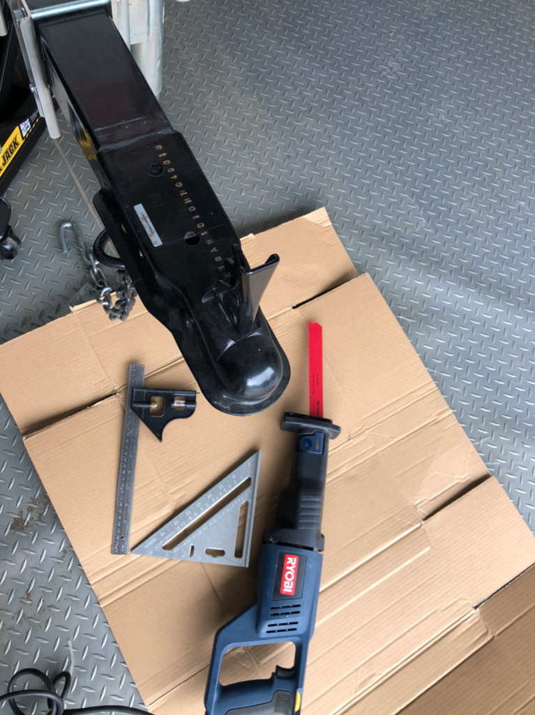

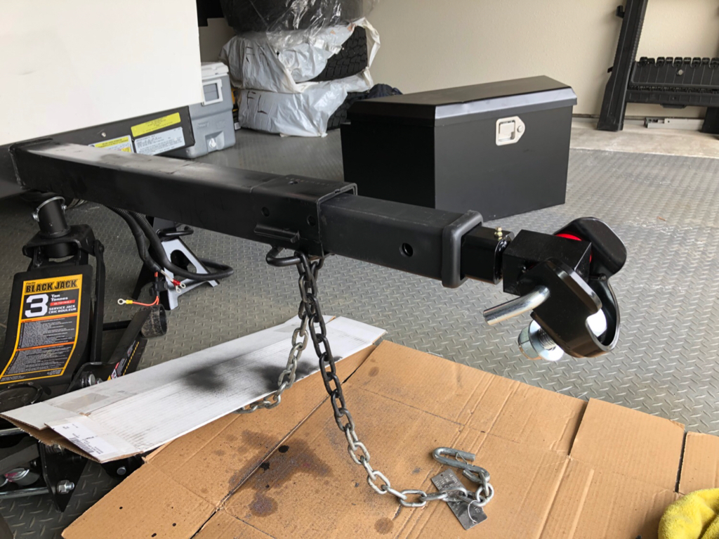

Finally found some time to work on the trailer tongue. Cut off the welded on coupler and then added a 24” two inch receiver and bolted on. I’d like to weld it on, but don’t have the tools. May look into it. Trailer is only 800lbs loaded up, maybe 900 max, so I’m pretty sure it’ll be ok. Then added the max coupler. Now I’ve got room to add on the tongue box for electrical. That’s the next Saturday project after stripping down the mods to my JKU. My new JLU Rubicon will be here in a week!!!

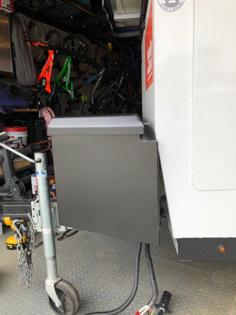

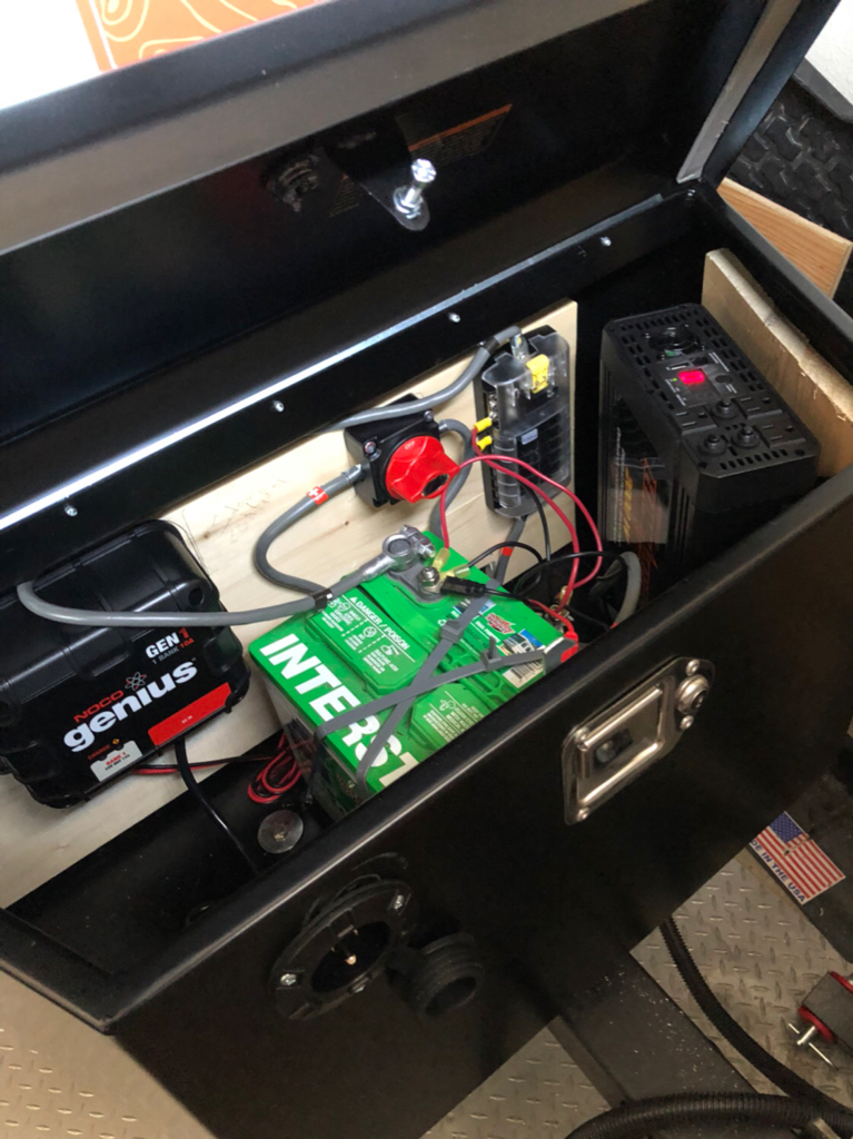

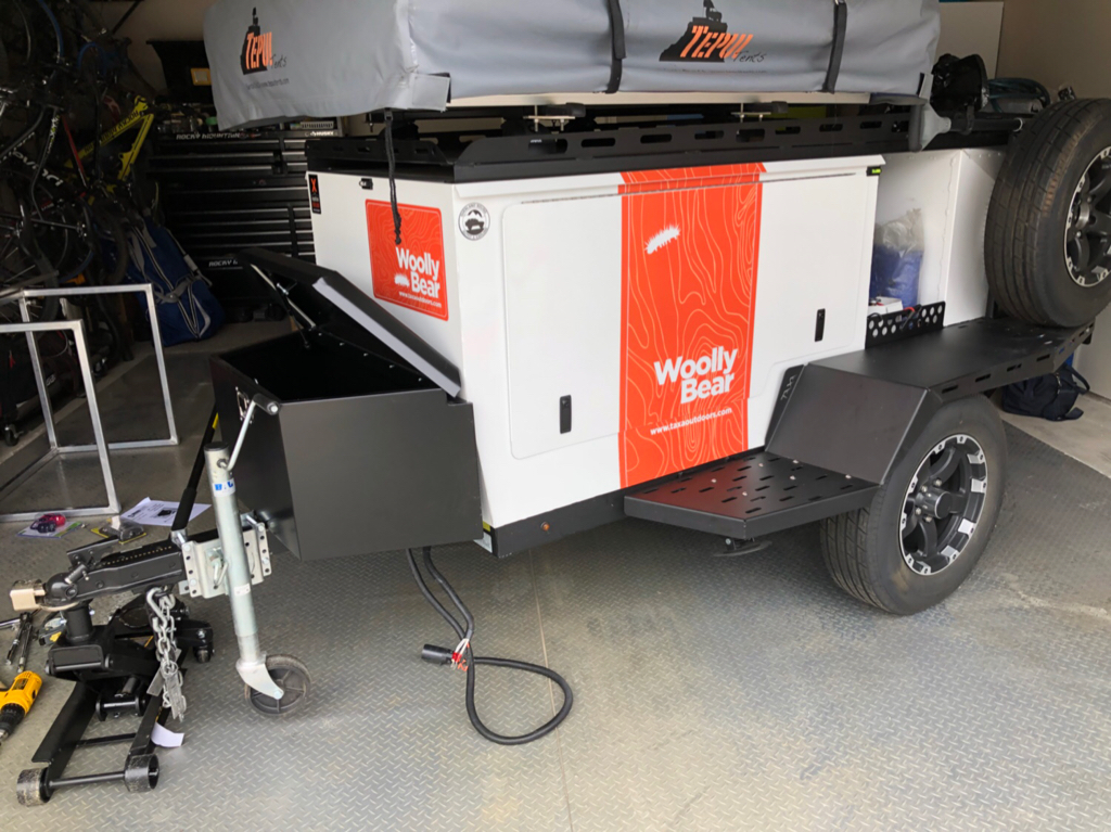

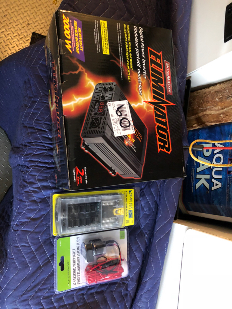

Was able to spend some time on the trailer this last week.
Mounted the tongue box to the trailer. My daughter (she loves working with me) and I then installed the battery, a blue sea fuse box, master power on/off, a Genius 10 amp batter charger with plug mounted on the outside of the box. And a 2000w inverter. That will have to do for the upcoming May long weekend.
I have a switch panel that will be installed next and then I’ll be running LED lights in a variety of locations. Solar will be coming soon. Probably overkill, but it’s fun to tinker.
We also ordered a new SunDogX RTT from Wild Coast Tents in eastern Canada. Same sleeping area as our Tepui, but it has the over hang area over the ladder and comes with the annex. This will be where the kids sleep when we all go out. Plus, a place to put a little buddy heater too.
Selling the Tepui Kukenam.
Here’s some pics of the tongue box.
